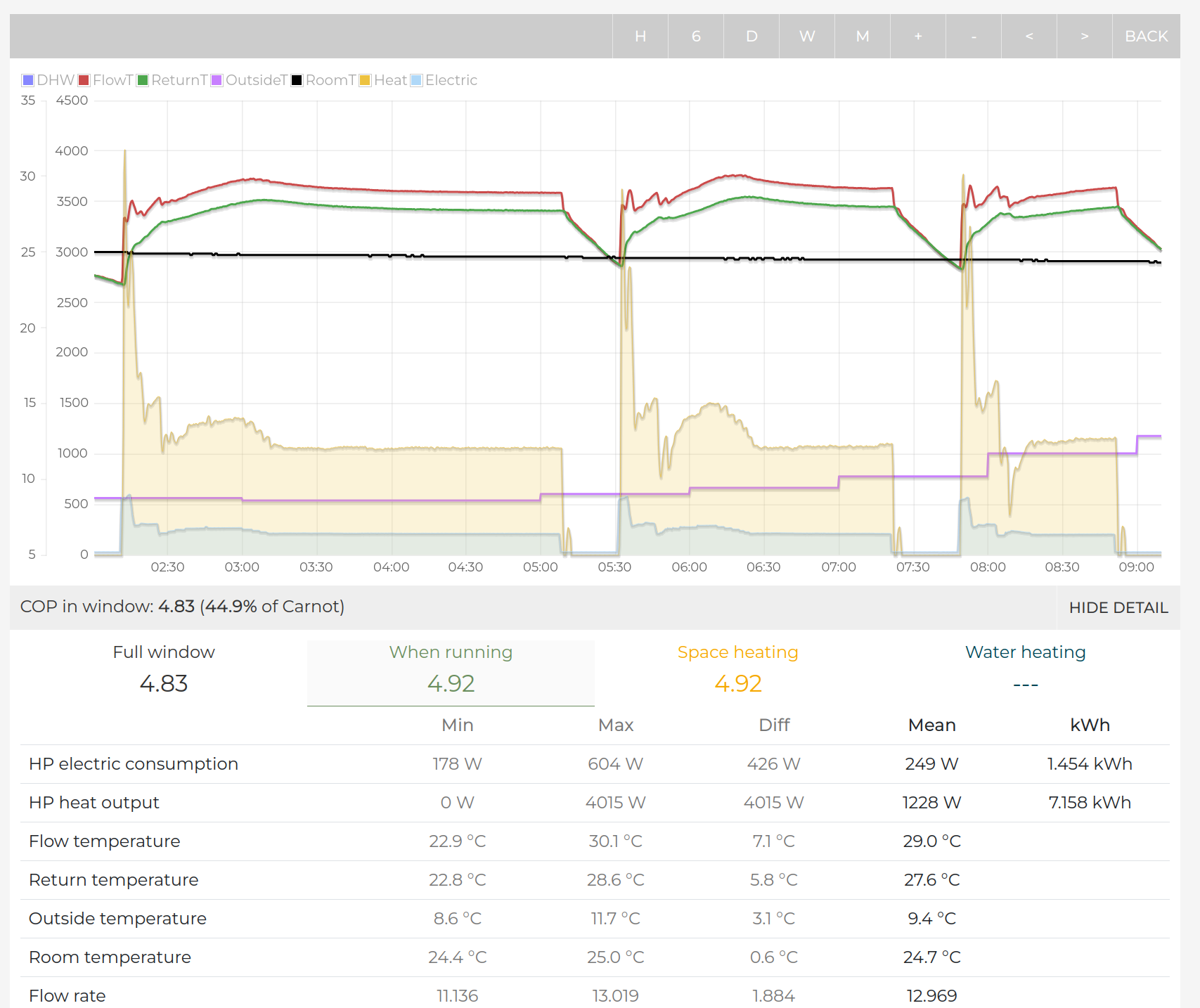

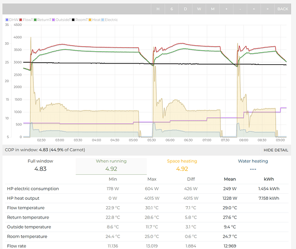

@UrbanPlumber has released his latest video, contributing data to HeatpumpMonitor.org showing the low modulation on this unit:
Here’s the dashboard, zoomed in to the low modulation examples: https://heatpumpmonitor.org/dashboard?id=1243&readkey=767d11f3b8ef1a9932703c93f1cde652&mode=power&start=1780966820&end=1780992580

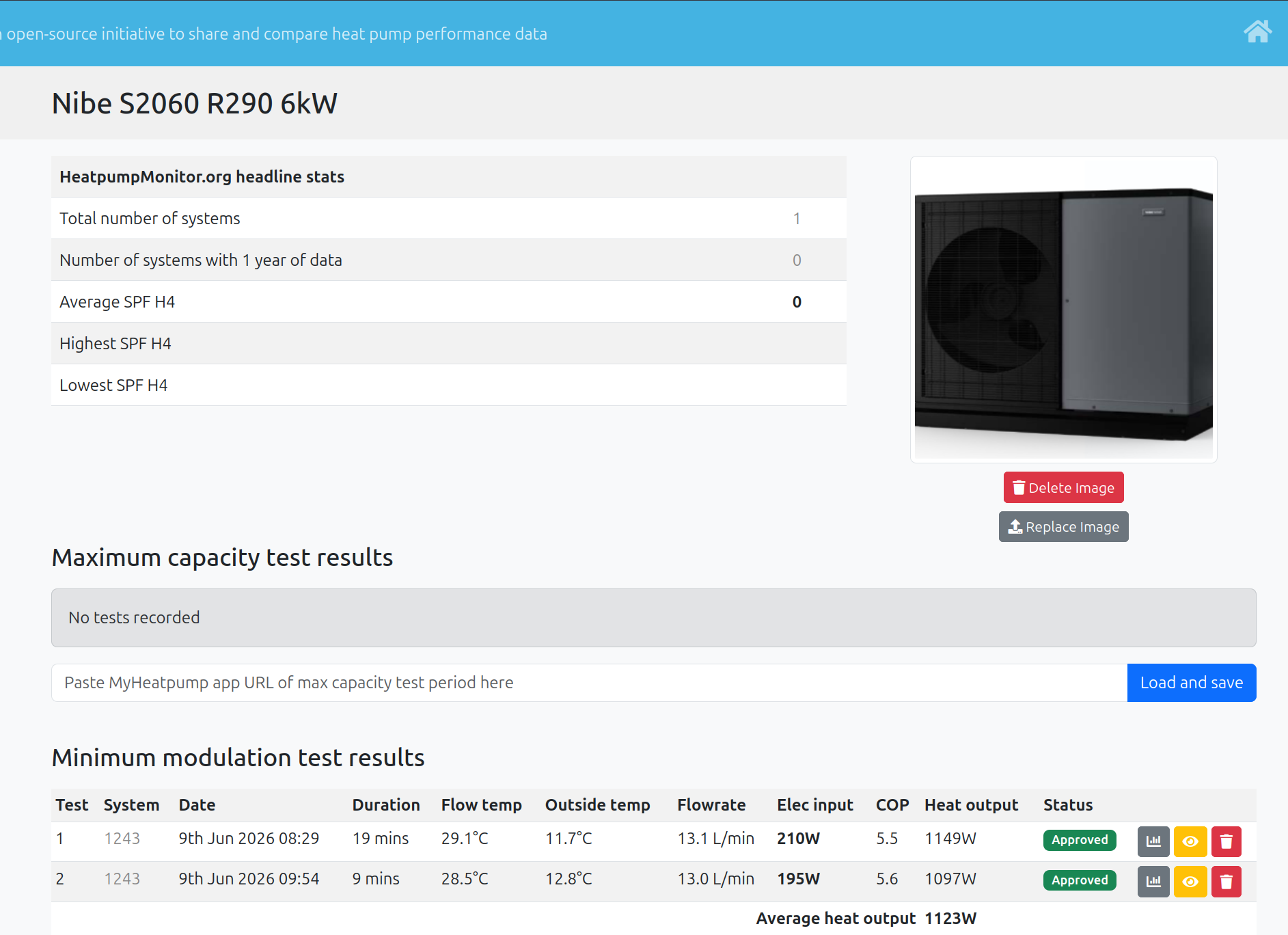

and entry on the HeatpumpMonitor.org heat pump database: HeatpumpMonitor.org
Looks like a nice unit! Thanks @UrbanPlumber for adding this!

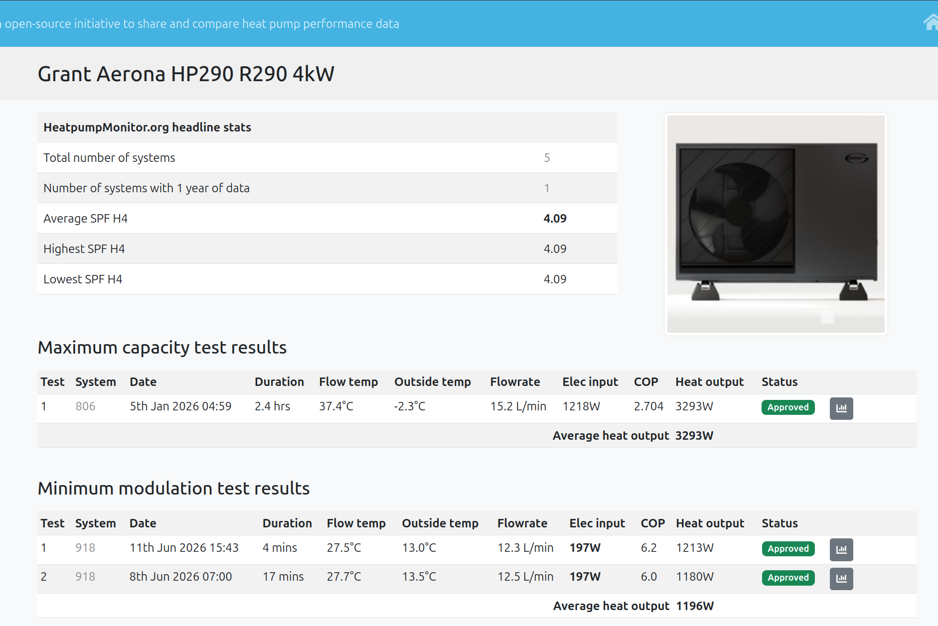

From what I can tell, it uses a twin rotary compressor from the midea/Toshiba joint venture. The Grant unit uses a similar one from the same supplier. It will be interesting to see if it does a similar oil recovery cycle.
Interesting, yes it’s very similar to the 4 kW Grant, if not exactly the same minimum electrical power and the heat/cop differences here are likely just outside temp and flow temp differences.

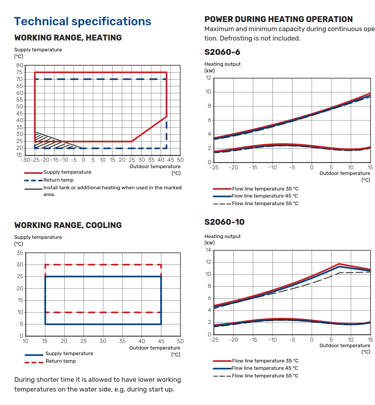

Am I correct in thinking the S2060 6kW has a modulation ratio of ~6:1, whereas typically heat pumps have a ratio of ~3:1?

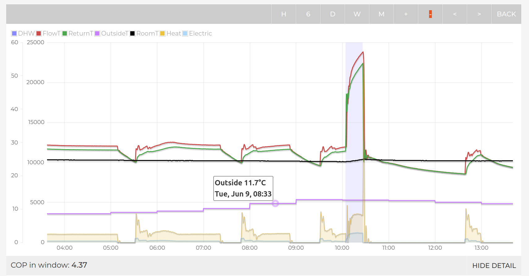

@Cillian_Cahill the minimum modulation measurements are carefully selected. You want to find a period of stable running above 10C outside temperature (above 10C to avoid low COP minimum modulation when it’s really cold). E.g between 8:20 and 8:50 am here the heat pump is running nice and stable and the outside temperature is 11.7C: It’s important to avoid transients such as the dip in output around 8:10am including that would give an artificially low minimum output.
We dont have the max output test for the 6kW S2060 yet. The datasheet seems to suggest 6.3 kW output without taking into account defrosts. So what do we expect maybe ~80% = 5 kW safe output including defrosts in freezing fog conditions?
Looking at the systems where we do have min and max tests, the average ratio between max and min is 2.5x and the best around 3.7x. If the S2060 succeeds in hitting a max output including defrosts of 5 kW that would result in a real world modulation range of 4.5x which would be a record and very impressive!

@TrystanLea - Okay, so you look back over the historical data and look for the ideal conditions. Is there a way I can opt in my system, once it’s logging data?
@Cillian_Cahill yes absolutely, and we very much welcome that! Once you are up and running, you can submit test results yourself, you just zoom into the area of interest in the dashboard and then click the share button top-right. That create a link with start and end timestamps which you can then enter on the heat pump database page for your make/model.

From Nibe S2060 installer manual:
The MHI/Nibe compressor has some welded “flanges”, whereas all GMCC designs I could find have a stamped base plate.
