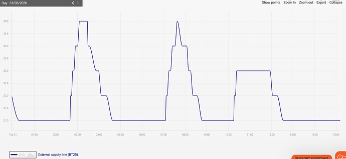

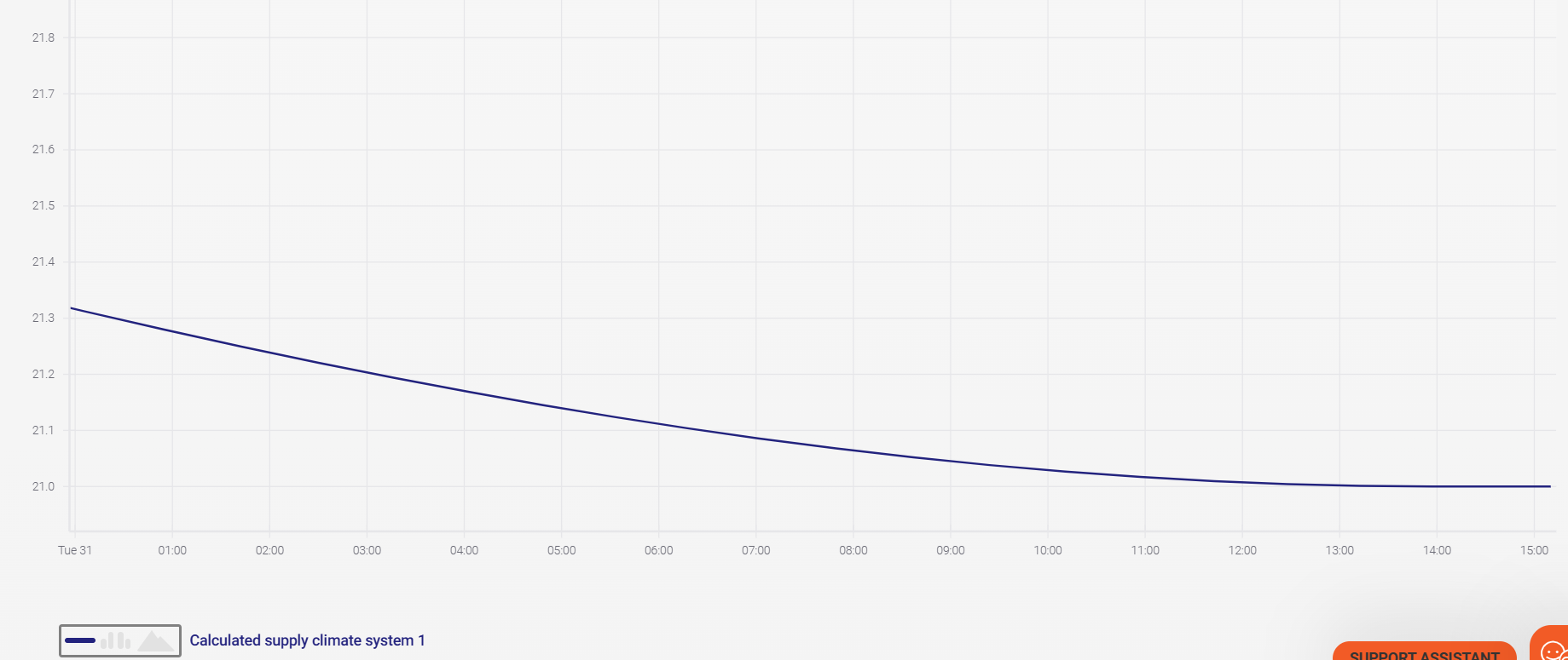

S1 has virtually no demand ; at 21C all morning, so I dont think the 4kWh is space heat.

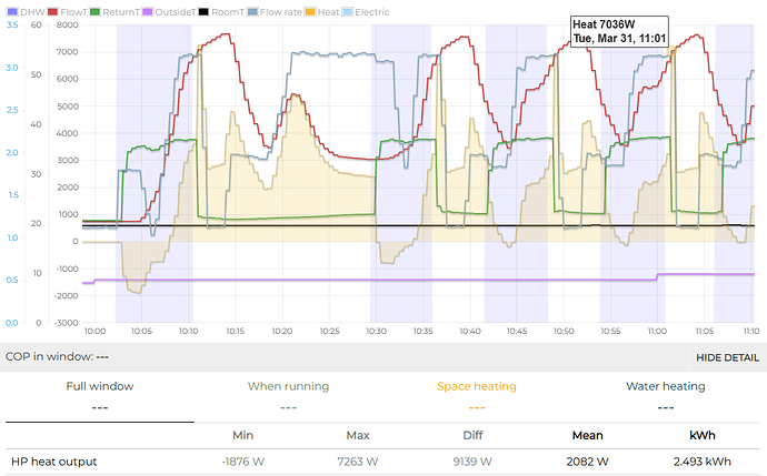

The supply line warmed up in that period, from 21C to 23C; hardly enough to heat hot water. Yet we saw the heat meter reporting F&R temps around 65/40C.

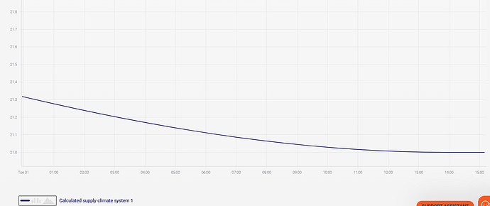

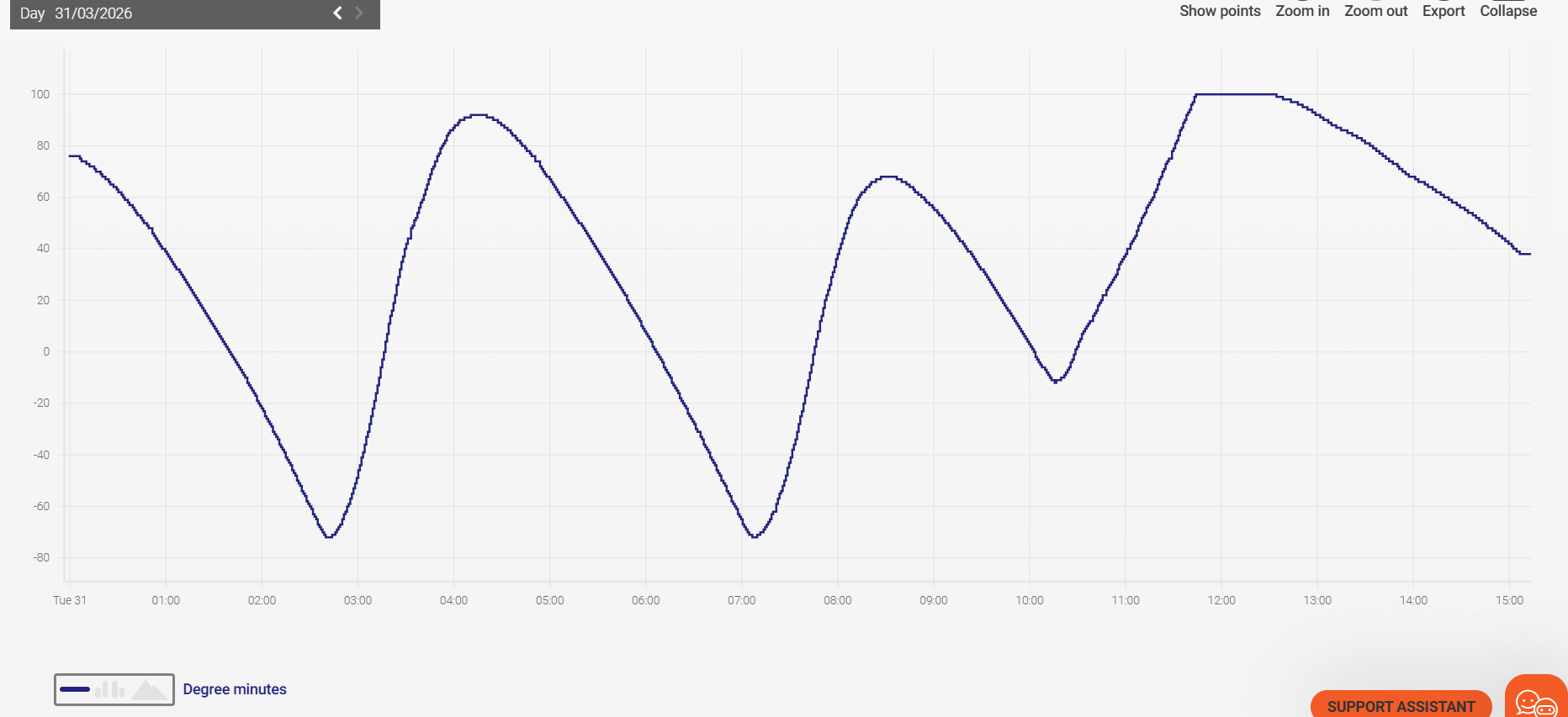

Degree minutes for that period; does this show space heating demand being met 1000-1200

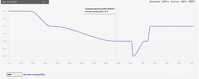

The hot water BT6 does show some top up to the cylinder; from 39C to 41C.
It does feel like an issue with the DHW tank sensor. The sensor is well pushed into the sensor pocket.

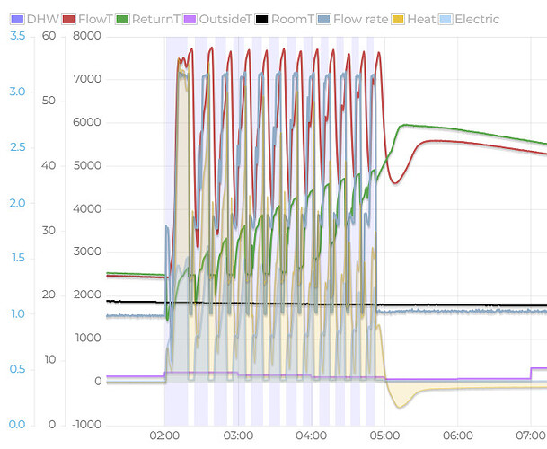

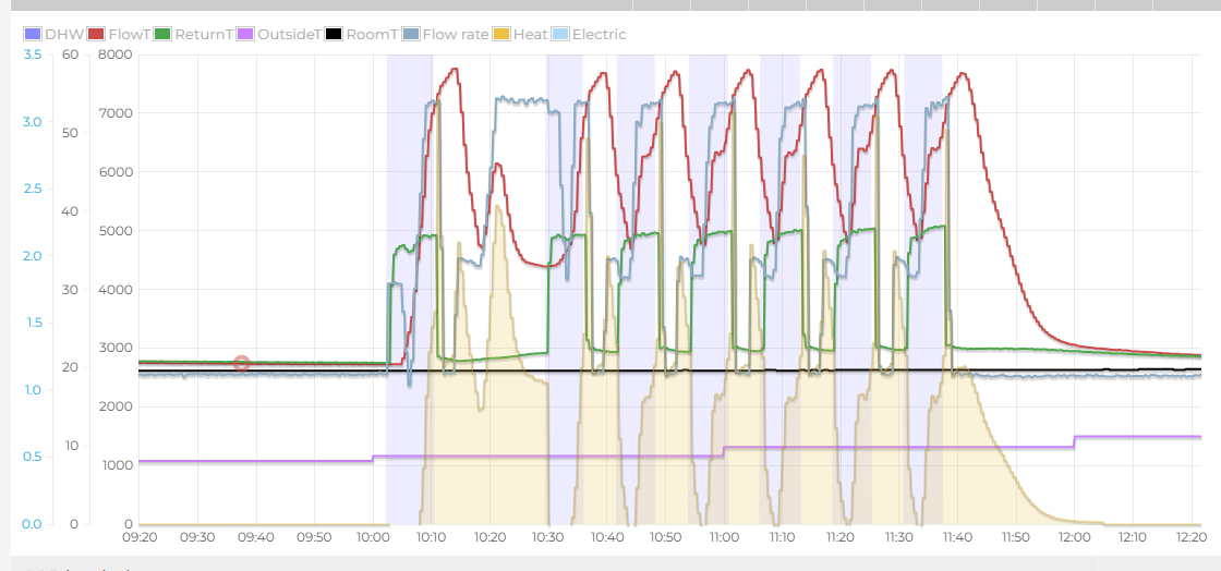

Heres a plot inc ‘defrost’
It feels like the system is coming on to top up hot water (because sensor is not reading true temperatue of the cylinder, possibly).
The pump ramps up, a load of cylinder hot water is pushed around the buffer and primary loop (and lost to outside).
The call for HW ends (how?). The diverter valve changes position.
Even though there is no call for space heat, the pump continues to run (why so?). Hot water is pushed from the buffer into the space heating pipes. As there is no call for heat, this heat is also lost; by over heating the room.
I have no idea how the 65C water is being generated as the HP is generating no hotter than 22C and the tank is full of 40C water. I’m pretty certain the immersions are off- but I will check.
This is quite strange behaviour!

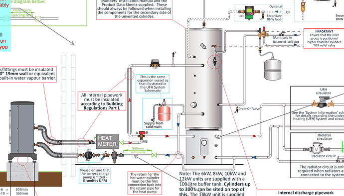

Does the DHW go through the buffer? How is the buffer piped? Is it a volumiser? It’s not ideal for the DHW to be doing through a buffer, usually buffers / volumises if required are installed on the space heating circuit after the diverter.

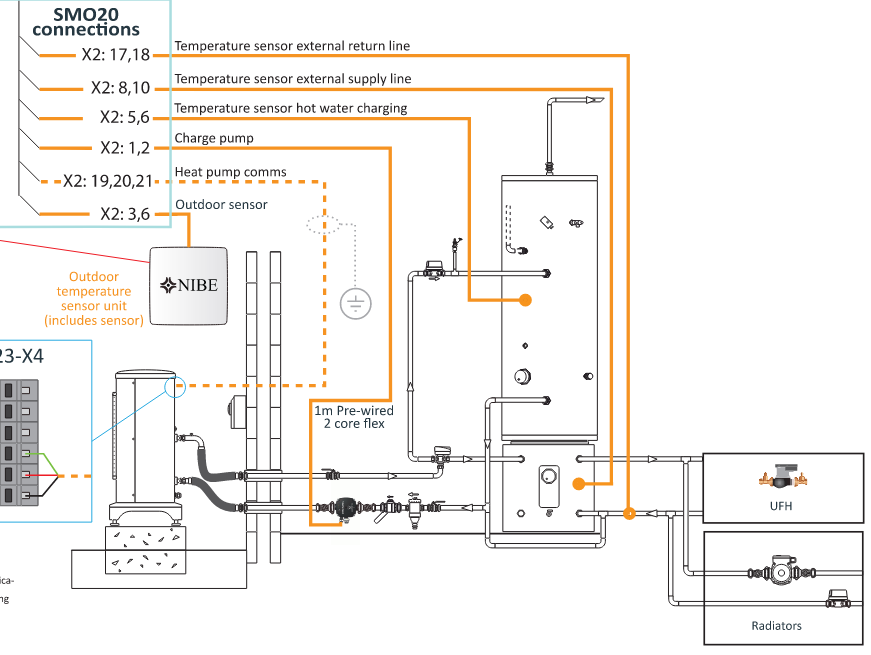

I think we checked this before, but are you sure the heat meter sensors are on the primary pipework before the diverter valve on the flow and after the DHW tees back in on the return?
Where is the supply line sensor located compared to the heat meter hot sensor? I would have expected these two sensors to read the same?
Hi Glyn

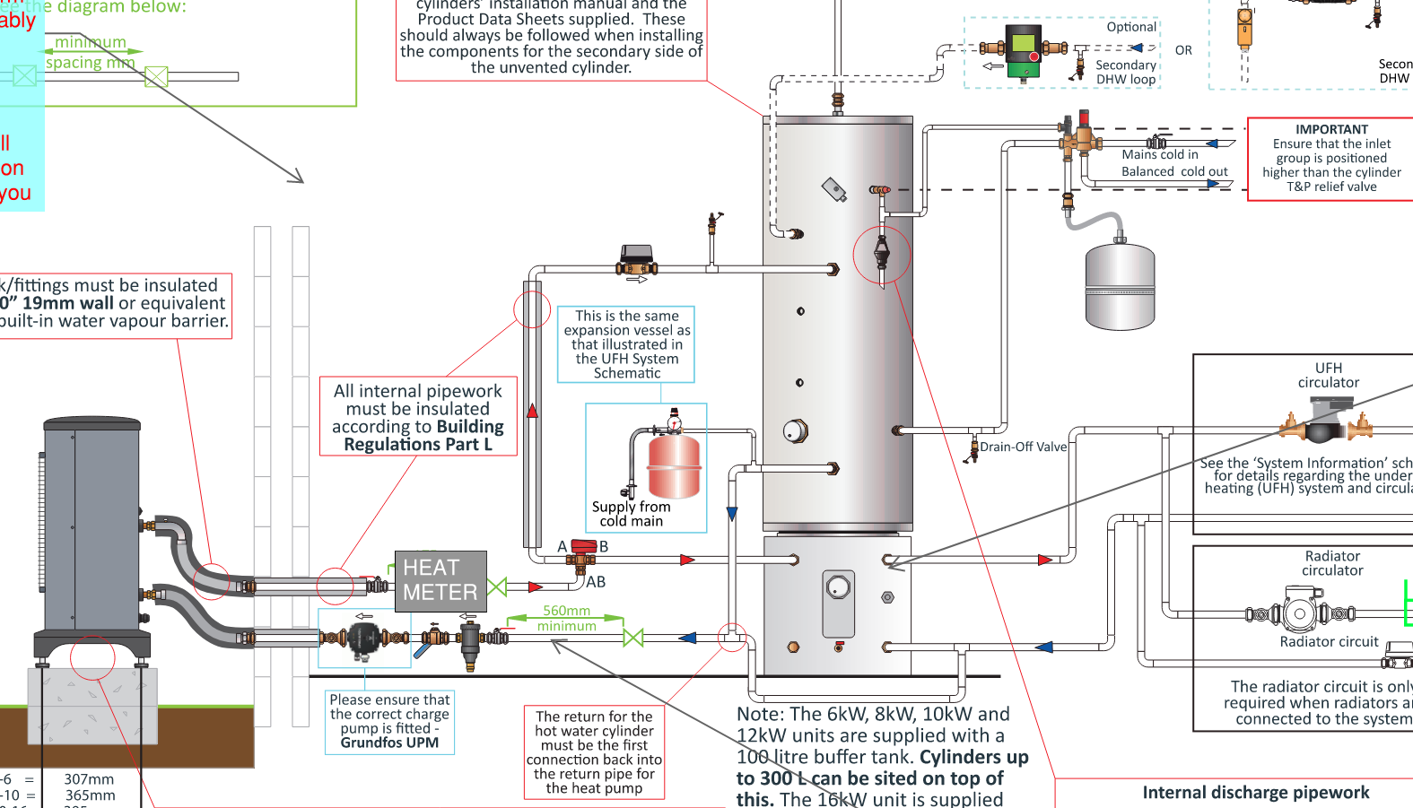

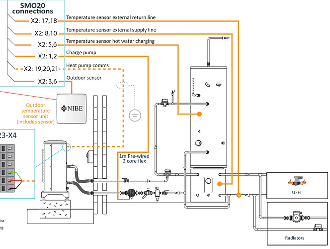

Schematic here.
DHW doesn’t go via a buffer, but once the diverter valve turns back to ‘B’ if the pump is running on, it will push water around buffer and primary loop.
I suppose the only ‘bypass flow’ from cylinder to buffer(&primaries) would be whilst the diverter was travelling between ‘A’ and ‘B’ which might only be a few seconds. If the valve isnt fully closing that might explain it.
Externally; on the Heat pump flow I expect; which is a few meters from the heat meter which is in the plant room. Youre right they shoudl read the same. I should check the supply line sensor is properly in position.
Got it, that looks fine.

Your graphs aren’t showing a high Return temp though… only a high Flow temp…

Note the External Supply Line sensor (BT25) is on the ‘heating’ side of the diverter valve, so that isn’t expected to register the high flow temperatures on the DHW circuit:

I’m still puzzled by the Green line (Return T) on your myHeatpump graphs, which I’d expect to be much more closely mirroring the Flow Temp. On reflection it makes sense that the Green line shoots up as soon as the diverter valve switches to DHW (as indicated by the purple shading) - when it starts seeing return water from the DHW coil rather than the heating buffer tank - but then the Return T barely changes as the Red line (Flow T) goes way higher.
My experience with NIBE systems is that the Flow Temp is managed to maintain a (configurable) Delta-T with the Return Temp, so the Flow Temp only increases because the Return Temp increases - but that’s not what we’re seeing here.
It’s certainly worth checking the diverter valve, but the decent flow rate reported by the heat meter (and the Green Return T line values) imply there’s good flow through the DHW coil - but then where does the high Flow T disappear to if there’s decent flow???
David youre right re supply line sensor- its in the buffer which is heating side only
I found BT12 plot which is, as you expected, matching the higher temperatures.

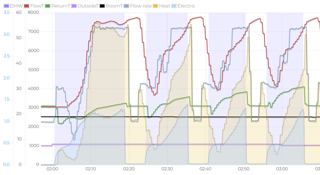

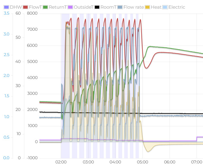

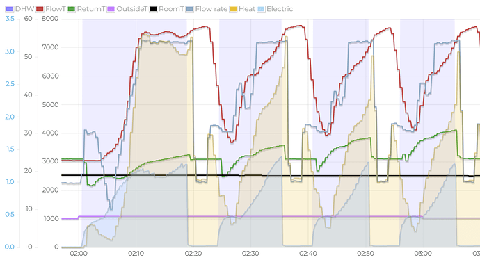

The hot water charging is still cyling rapidy- Off for about 6minutes and On for between 14 and 9minutes, gradually increasing frequency as the cylinder heats up.
Heat pump still running too hot (56C) to generate 43C hot water.
In between HW bursts, the pump keeps running, and this pushes 56C water around the heating buffer, and primary, and around the heating circuits too in all liklihood. This heat is ‘lost’.
COP recently; mostly HW, very little heating 1.2-2.0.

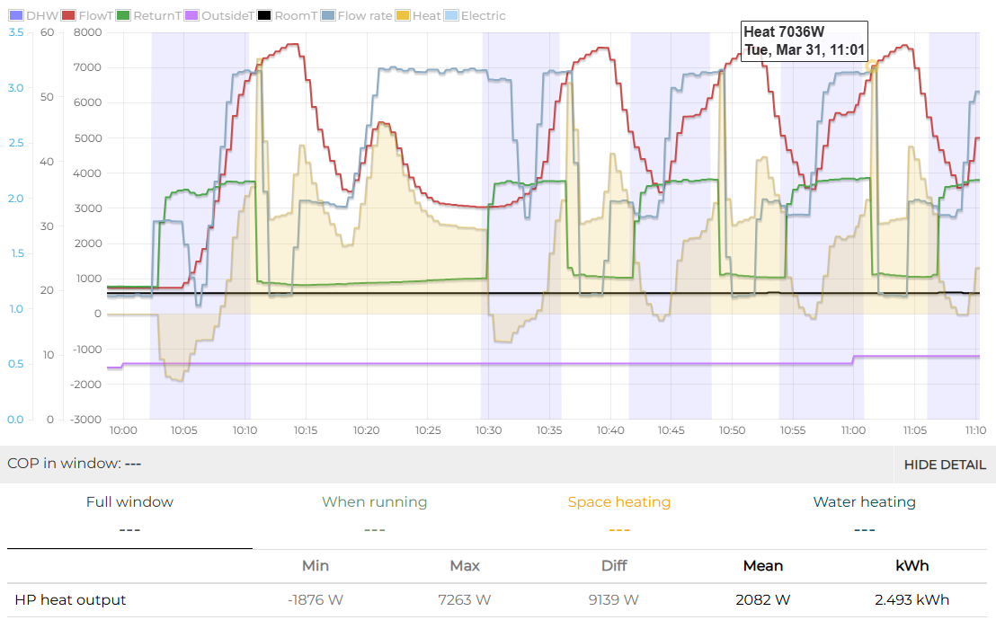

Two views of the same time period below

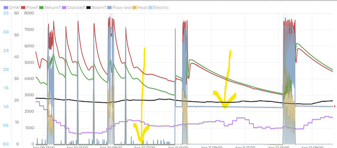

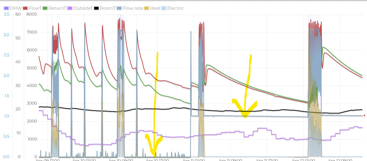

Finally, I just noticed that, despite there being no call for heat, no schedule for heat or hot water, the pump is now running 24hrs, which it wasnt before;

Normally I’d expect to see the charge pump running all the time - provided the outside temperature is below a (configurable) threshold value which indicates that space heating might be required. However, as you’ve noted, this does mean that water is being continuously circulated from the Buffer Tank to the Outdoor Unit and back again.
Given that your BT25 sensor is installed in the Buffer Tank (rather than just stuck to the flow pipework) you’re not relying on pumped circulation just for the sake of that sensor, so you might be better off having the charge pump switch off completely between cycles. Sam will be able to confirm, but I believe that can be achieved in Menu 5.11.1.2 by changing the setting from Auto to Intermittent.

The fundamental issue seems to be that despite the very high Flow temperature being recorded by the Heat Meter on a Hot Water run, the Return temperature only creeps up slowly (presumably as the DHW cylinder heats up slowly) - with the big questions being:
  • Why is the controller choosing to deliver such a hot Flow, when the Return is around 30 degrees colder (at the start of the Hot Water run)?
  • Why is so little heat being transferred to the DHW cylinder, such that it takes about 3 hours to heat up (despite a ridiculously high Flow temperature)?
