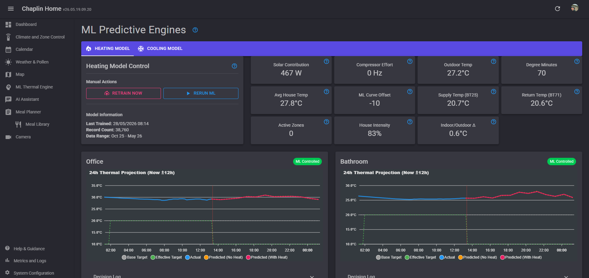

:thermometer: The ML Thermal Engine (Heating & Cooling)
Standard thermostats just look at the current temperature. I needed the system to see the future. I built a custom ML .NET (FastTree Regression) pipeline that runs continuously in the background.
  • Winter (Proactive Heating): The engine learns the specific thermal inertia of different rooms. It evaluates the whole-house state and generates a “Global Curve Offset” for the Nibe, proactively heating the slab before the temperature actually drops.
  • Summer (The T+60 Dew Point Watchdog): Underfloor cooling is great until you hit the dew point and ruin your floors. The engine ingests high-frequency telemetry (temp, humidity, solar azimuth, cloud cover) and predicts the indoor dew point exactly 60 minutes into the future. If that forecast (+ a 2.5°C buffer) exceeds the target flow temp, it immediately drops the relays and halts cooling. Zero condensation.

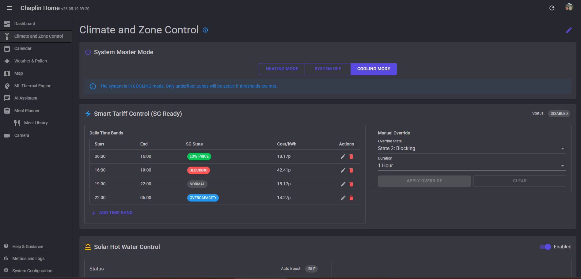

Here are some images of the app:
Thanks for reading
