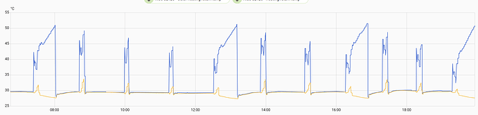

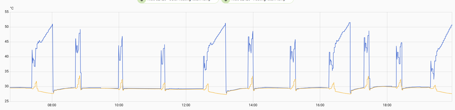

Thanks a lot for the inputs. Yes, I have the NIBE VVM S320 indoor unit. The return temperature (BT3) is the same as the return temperature of what you can see in the logged return temperature on EmonCMS ( HeatpumpMonitor.org ) when the system is heating up the house. When producing the DHW, it changes a bit, but not by much. I have logged both (for today) on my Home Assistant, and you can see them both in the plot below (blue is return from the heat pump (what is logged by EmonCMS) and yellow is BT3).
The water seems hot enough for defrosting, and I do not understand why it sometimes works correctly as for example here: HeatpumpMonitor.org (Dec 30, 2025) where the return temperature is lower than now.
This fall/winter, most defrosts have been tank defrosts (I would say around 80 % of them). Last winter, I also observed tank defrosts, but only around 10-20 % of the time. I have increased the heating curve in December to see if increasing the return temperature would help, but that does not seem to be the case.

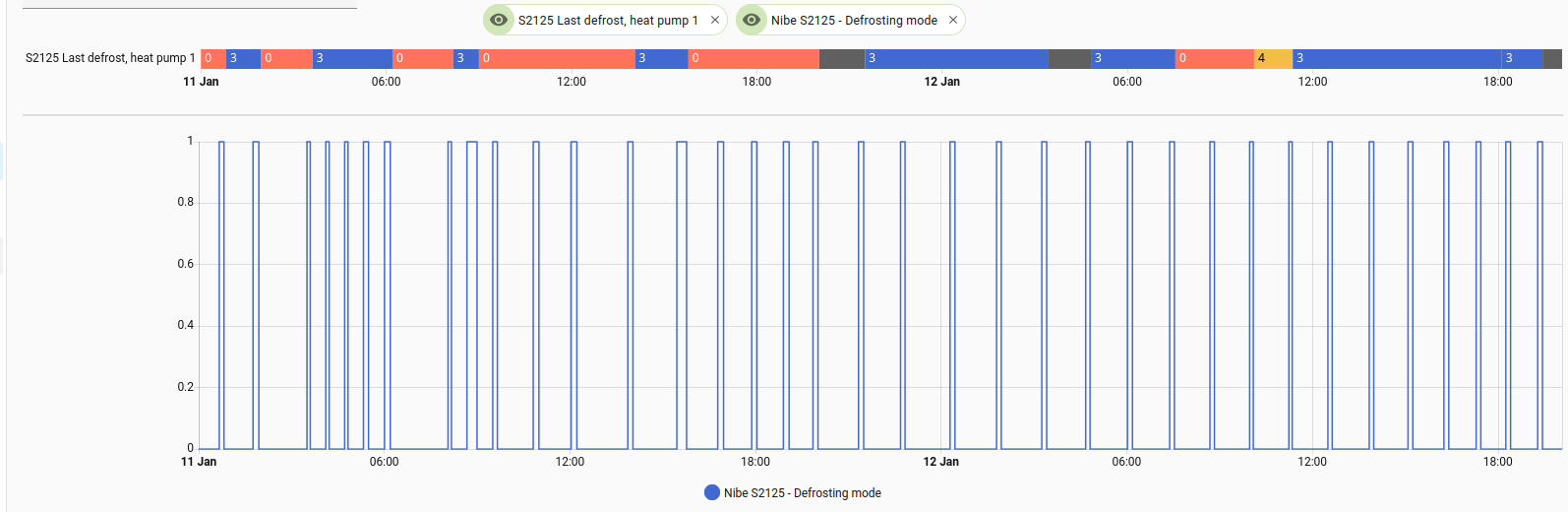

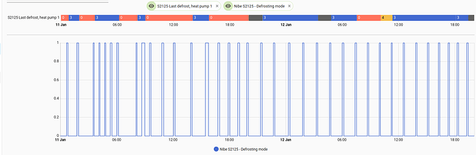

Another observation, I have made the past couple of days, is that the defrosting fails around 50 % of the time. This is illustrated below where the ‘last defrost’ indicates whether a defrost was successfully completed (value of 0) or failed (value greater than 0). 3 means that a defrost failed due to low flow while 4 means that a defrost was ‘aborted due to low LP’ (not sure what LP refers to). Black is unavailable. The defrosting mode (blue curve) indicates the defrost cycles. Despite this high failure rate, I do not observe any ice build up on the outdoor unit.
