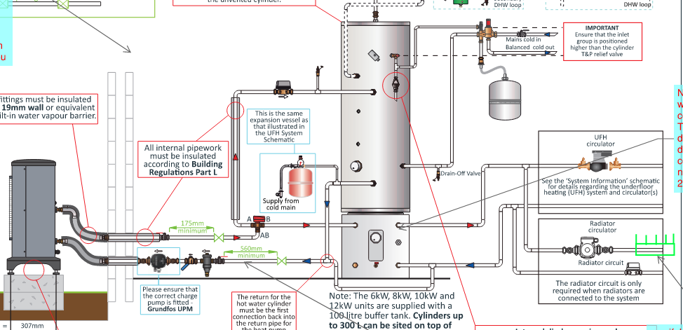

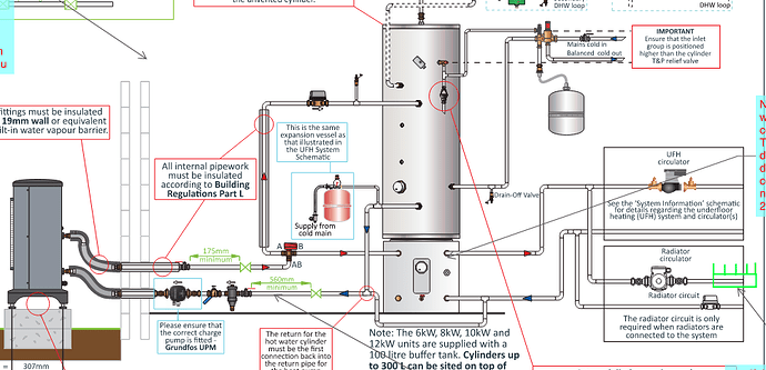

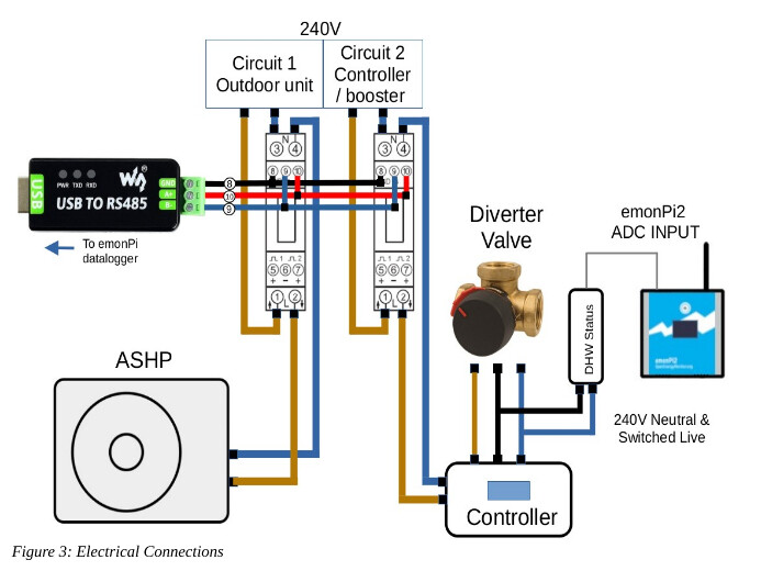

Install was by a local firm under the umbrella of Nuheat; yes Nuheat who’s business model includes selling as many zone controllers as possible. They provide the design and certifiaction and the plumber installs it. Its a common set up if not ideal.
We just got the emonpi data flowing after 18months of tinkering from afar.

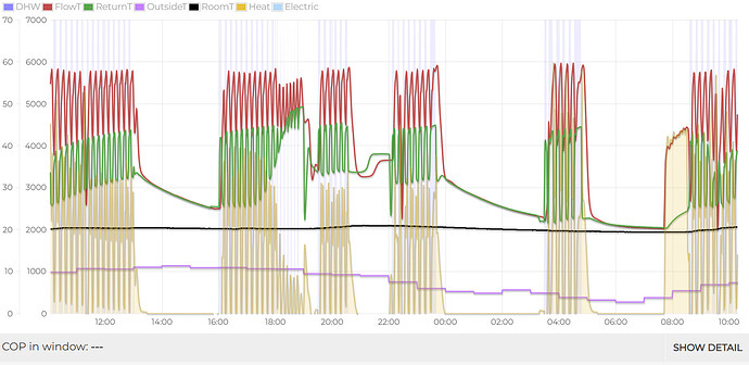

Its behaving very strangely.

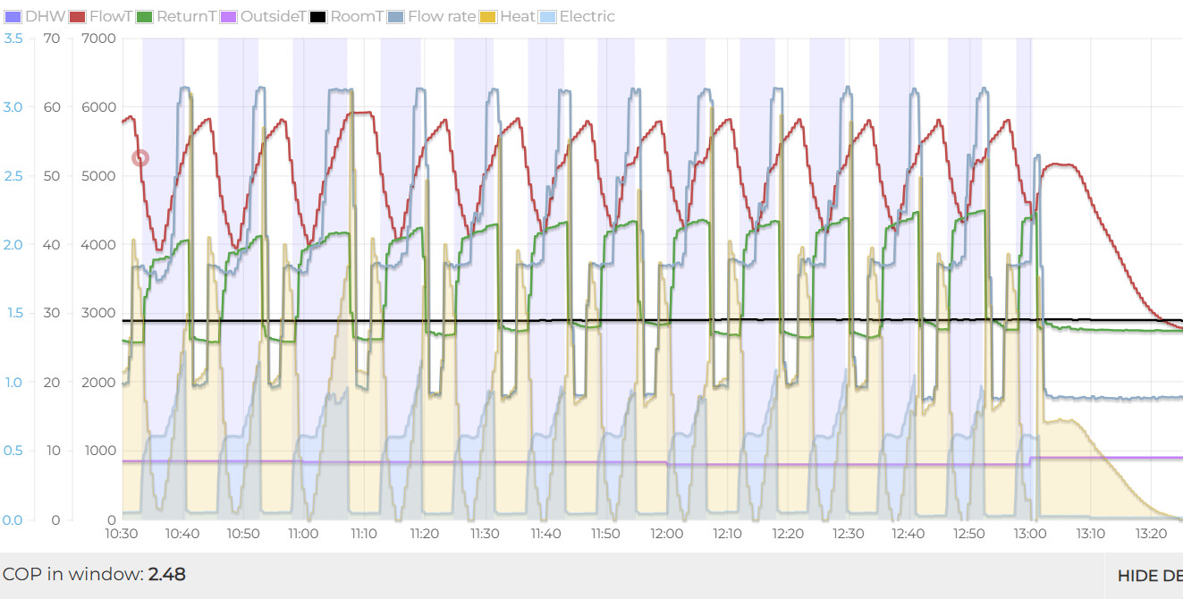

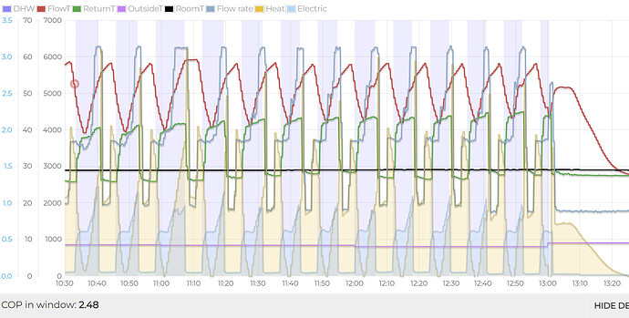

Its cycling every 10 minutes. Flow temperature is far hotter than weather curve or hot water would require.
The emonpi is confused on what is heating demand or hot water.
I don’t think it is the nuheat controllers as the behavior happens even if we set them very high.

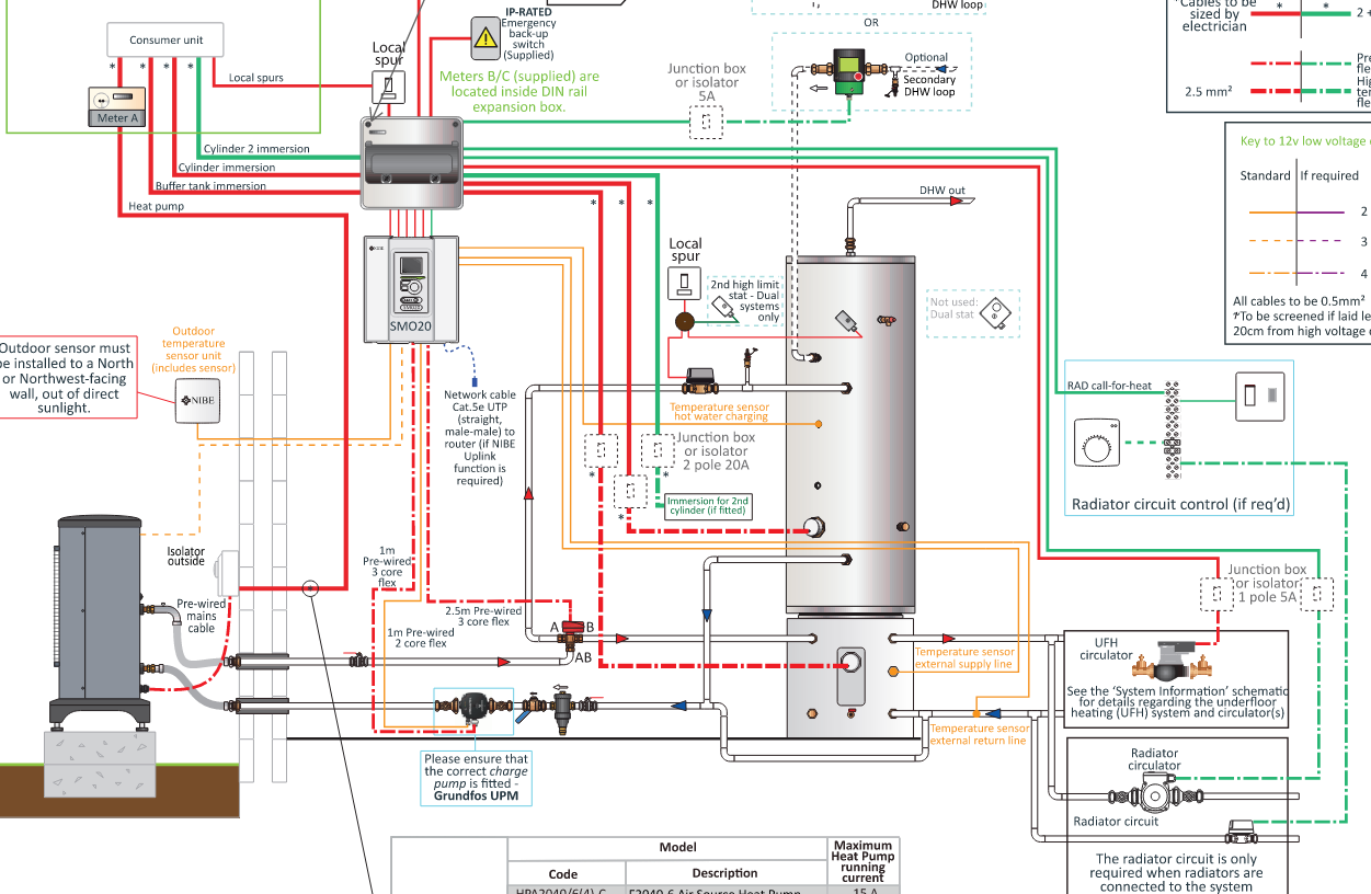

Maybe the DHW sensor is wired to the wrong ports in the diverter valve. Or, maybe the diverter valve itself is wired wrong.

Do you have access to the myUplink data that the NIBE controller should be uploading to their servers (assuming that’s connected to the Internet)? The NuHeat schematic mentions a Cat 5e UTP cable and “NIBE Uplink” - which has been retired, replaced by myUplink (which does the same thing).

Your second graph is puzzling - apart from the confusion over the DHW mode - since the Return temp (Green) doesn’t appear to mirror the Flow temp (Red). Please could you clarify where those Flow and Return values are sourced from: is there a Heat Meter connected to the emonPi, and do the readings come from that?

The tank warms but is 46C which isn’t as hot as I would expect (think it was set to 56C for a period of heavy loading- looking at it now I suspect this is causing the cycling that it is actually stuck in Luxury hot water mode)

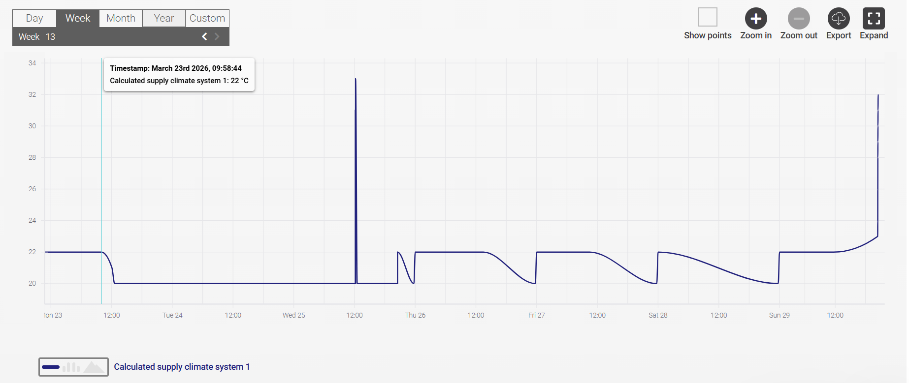

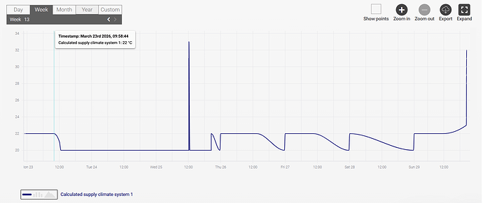

Parameter s1 I cant find that explicitly but can find “Calcu­lated supply climate system 1” this shows that the target flow temp is very low around 22C.

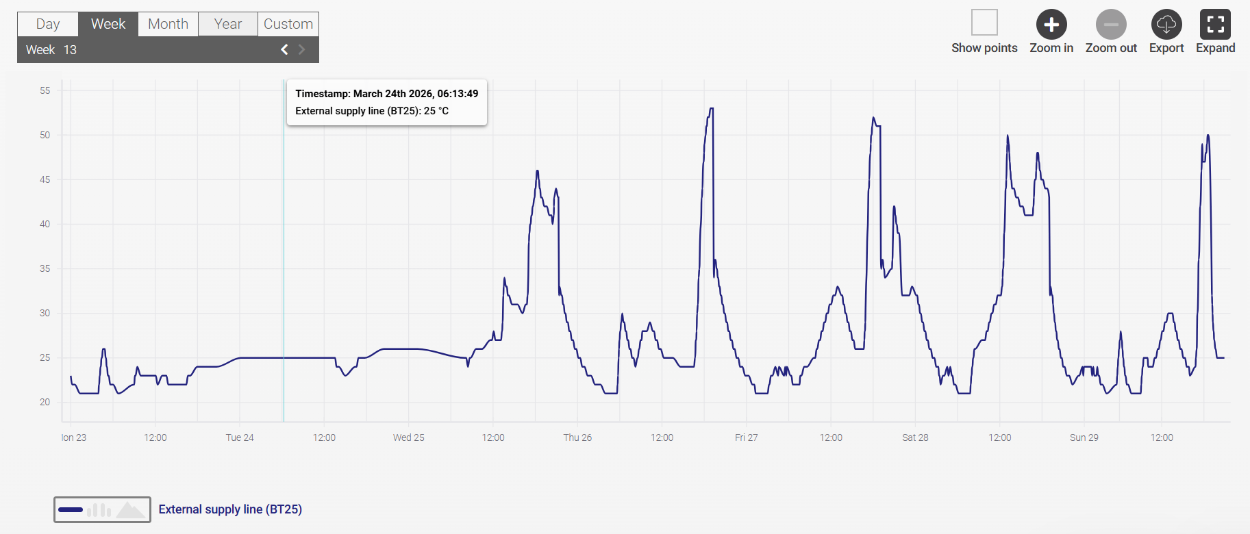

External supply line below; strangely this shows a smoother profile than the emonpi. It might imply far fewer compressor starts…
…which is not the case; 50 starts per day.

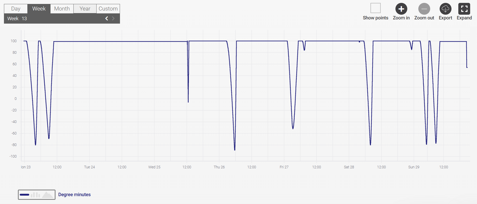

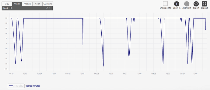

Degree minutes below. What is this showing us? That the system is struggling to deliver enough space heat.

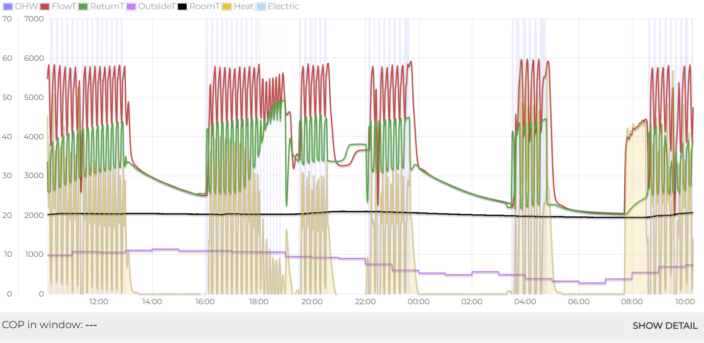

TBH I think we might have cracked it with the hot water setting. The graph is already calming down. I will report in my next reply.
Thanks for the extra info and the graphs from myUplink. Having the Hot Water set to ‘Lux’ mode without a correspondingly high usage of DHW could certainly explain the frequent-but-brief high temperature runs (and the lack of alignment with the heating(?) return temperature).
  • You’ve found the correct parameter for ‘S1’ and the values for that do align with being on a very low WC curve setting
  • There are some fairly high-temperature peaks on the BT25 External Supply Line Temperature chart, but perhaps those are just as a result of the diverter valve switching over at the end of a DHW cycle, which is normal behaviour for a NIBE unit
  • The Degree Minutes are tracking how much - and for how long - the BT25 value was lower than the S1 Calculated value.
    • By default, NIBE units will Start the Compressor (for a Heating cycle) when the DMs reach -60 and then Stop it again when they rise to 0
    • When the DMs are at +100 that means the heating demand was fully satisfied and that in fact the heating circuit was ‘too hot’
      • The controller limits the DMs from rising above +100, which is why there’s a flat line across much of the graph
      • Some other NIBE users have been seeing DMs go highly-negative (e.g. -800) which is a sign than the heating demand is present but is not being satisfied - but you’re seeing the opposite
So, in summary, the Heating side of things looks OK to me - which is consistent with the unit trying to do Hot Water rather than Heating.

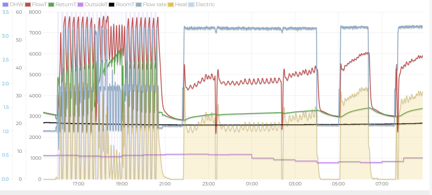

Below a plot showing with ‘Luxury’ hot water ON then OFF. The difference is “night & day”. Just goes to show check the simplest explanation first (settings) before jumping to more involved diagnoses.
We can focus on fine tuning now. Thanks for your help
