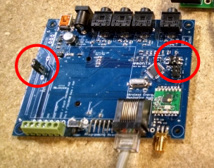

The Pi appears to be talking to the RF module, so either that isn’t receiving, or the emonTx isn’t transmitting.
You haven’t turned r.f. off accidentally?
You could try erasing the EEPROM in the emonTx. The EEPROM library was designed to ignore data not belonging to the current sketch, but only if the rules have been followed (viz. every sketch must use an unique code to identify itself). I don’t know if the sketch you got from Github does obey the rules. Using the serial monitor in Admin, send it the ‘r’ command – restore sketch defaults. If you’ve changed anything else, that too will be reset, so make a note first.
Do you know that the r.f. was working when you bought the emonTx?
Does the LED inside the emonTx come on when you reset/start it, then go out? then give a short flash every 10 s approx. If it goes out, it’s probably initialised everything, including the radio, correctly. If it stays on for more than about 3 s, then it’s stuck - but previous output above says it’s not.)
What are the switch settings in the emonTx? Both should be OFF.

Yes, there is a red LED pulse every 10 seconds or so - but only when connected via the UART cable. When I just have the mains power supply plugged in, the LED is not lit. Does this suggest it is actually a defective power supply to the emonTx that is causing the issue?
Where do I find these? Are they physical switches on the board or something in the software?

Prompted by the revelation that there should be a power LED lit up on the Tx, I dug out an old USB cable and have tried powering using the 5v connection and a plug adapter.
I think this has been successful as the Inputs page on emonpi.local now has green numerals every 10s and the EmonHub log has entries such as:

Thank you again for the help, and I’m sorry it was something so rudimentary as the power supply causing the issues.
