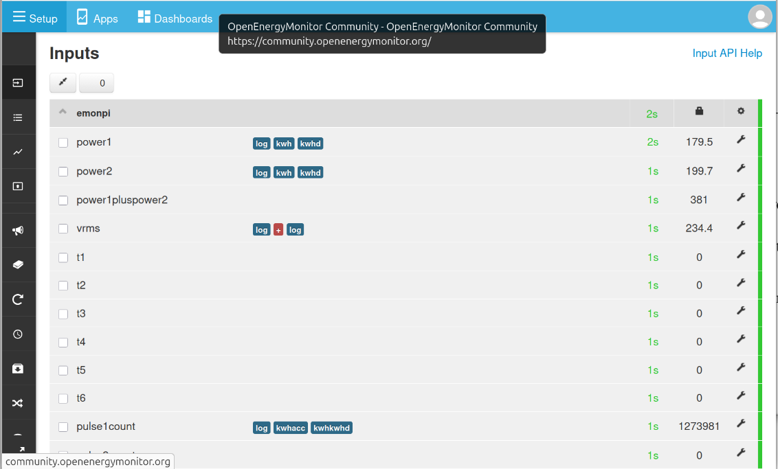

When you have successfully got into emonCMS, you’ll have a screen something like this.
Post again when you’ve got this far and I’ll lead you through the next steps - either setting up Wi-Fi manually and then looking for inputs, or if you’ve set up the Wi-Fi, then it’s straight to inputs.

Have you found the page above: Setup → Inputs? Have you got a page like that - bearing in mind my emonPi1 has only two c.t. inputs? Are you reading a sensible number for Vrms? Does it change a little every 10 s or so? You won’t have anything in the second column (e.g. “log” “kwh” “kwhd”).

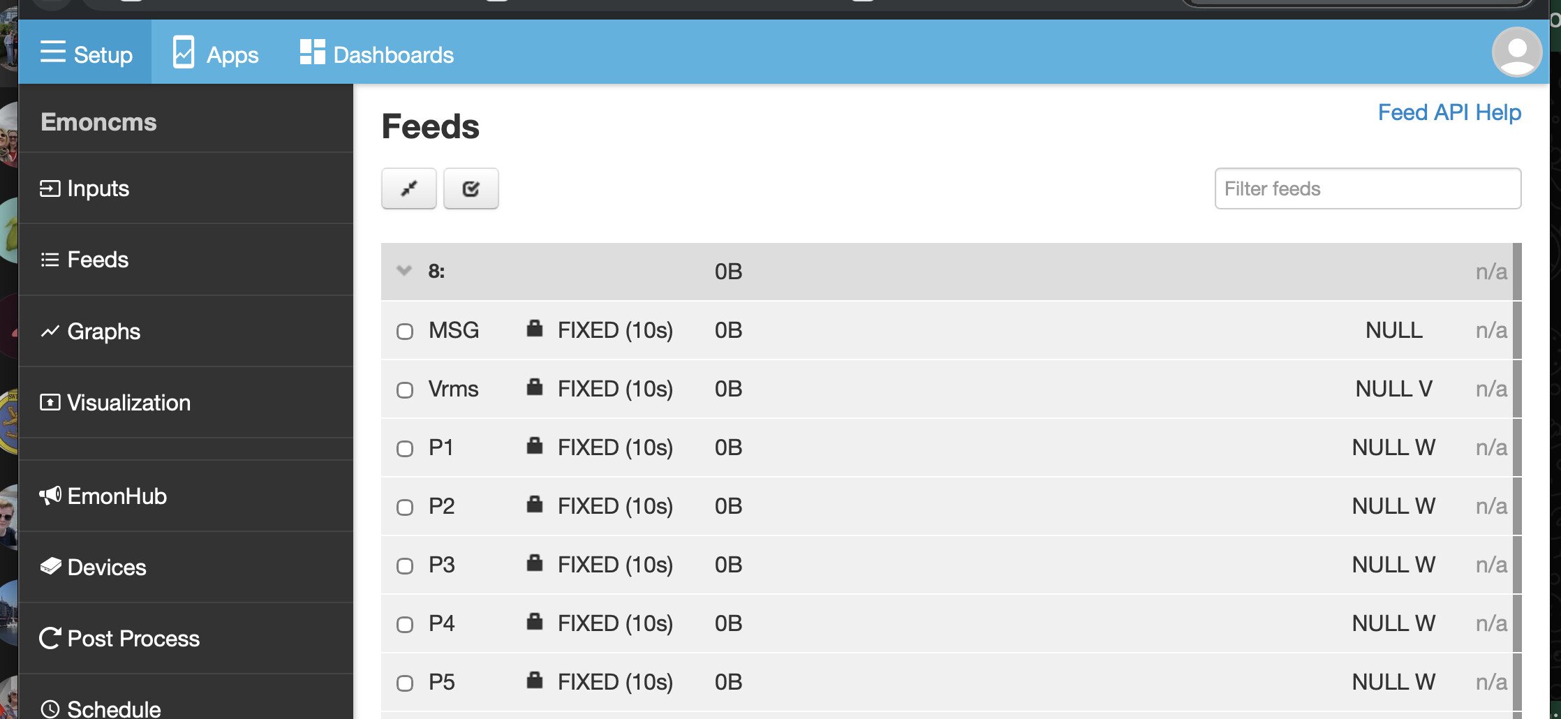

I have the Pi, VS and TX4 powered up and can web to the emoncms and can get to the pages
once again I apologise for using the wrong name
Ok, you won’t see anything on the Feeds page until you create a Feed. The Feed is the database, and it is created when you send data to it, and you do that on the Inputs page, as a step as you “process” the Input data. Until you do something with the incoming data NOTHING IS SAVED. It just sits there on the Inputs page and when the next tranche of data arrives, the ‘old’ data is overwritten and it’s gone forever.

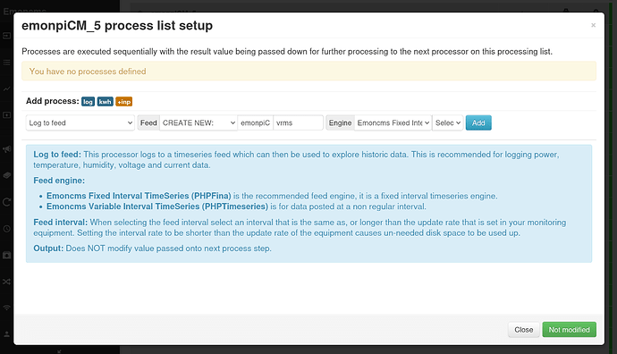

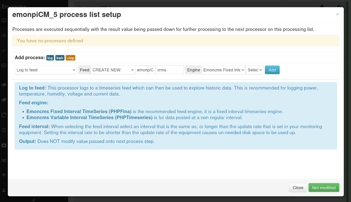

So go back to the Inputs page, and you’ll create a Feed to store the rms voltage. Click the spanner icon at the end of the Vrms line. You’ll see a page like this:
In the left-most box, the default is exactly what we want – “Log to feed”. If you expand the drop-down, you’ll see all the available processes. In the blue area below is an explanation of what the process does. Moving to the right, in the next box is CREATE NEW (we want a new feed because we know one to store Vrms doesn’t exist), and the next box tells where it came from, and the one after that is the name of the individual Feed. You can, and probably will want to, edit these names. For “Engine”, for this data that arrives regularly at fixed time intervals (9.8 s, I happen to know :wink: ), choose “Emoncms Fixed Interval Timeseries” and for “Select Interval”, you must choose an interval longer than the interval for the data (otherwise, you get NULL values in the database that play havoc with the graphs). So choose 10s, longer if you wish, and click Add.
If you have finished with this Input, click ‘Changed press to save’ (bottom right).
But for fun, we’ll add another Feed. We’ll call it DeltaV, and it will be the difference between the nominal 230 V and the actual voltage.
So, still editing processes for Vrms, expand the drop-down and under Calibration, select ‘+’.
In Value, type -230 (we add a negative value to subtract) and click Add.
Now Log to a new feed, exactly as above, but call it “DeltaV”.
Remember to click ‘Changed…’ bottom right before you leave the page. Click Close.

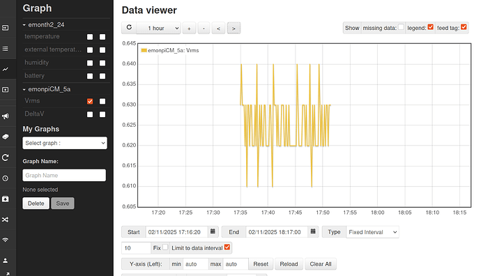

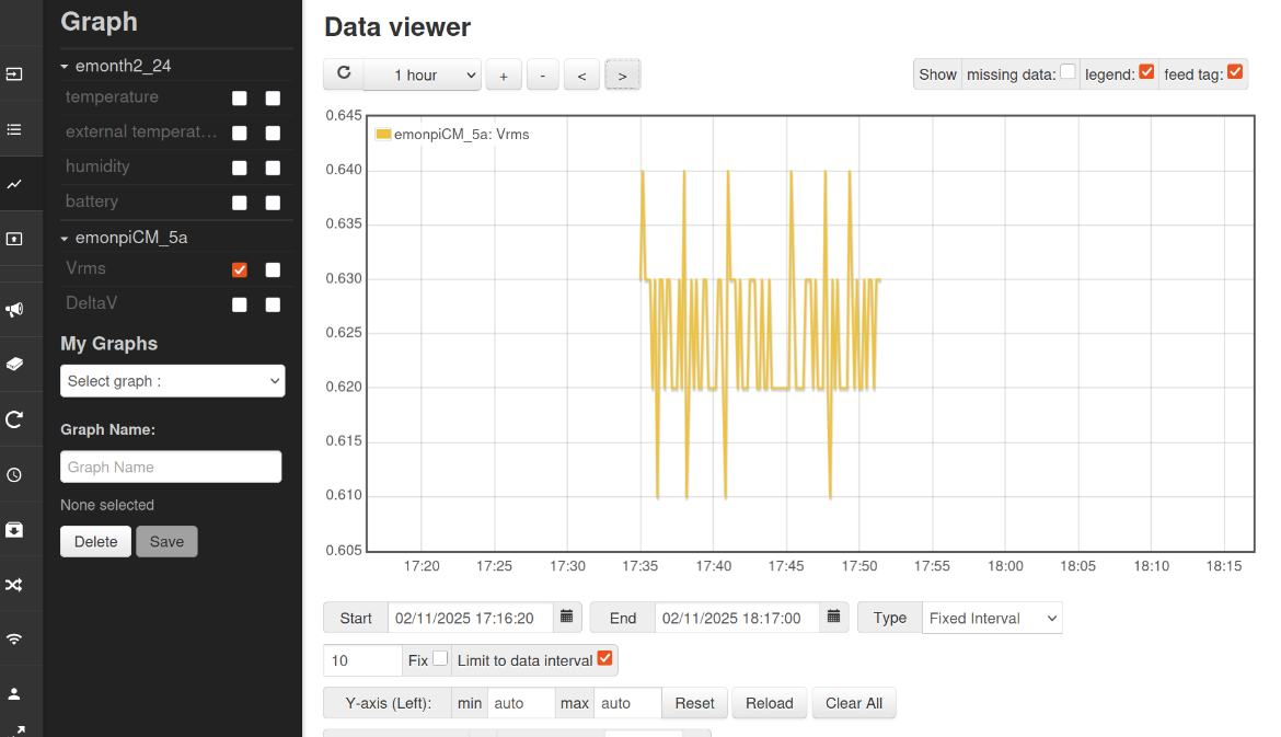

Now go to the Feeds page and you should see two (new) Feeds. Leave it for a few minutes, then click on the name of a Feed. This will open a time graph “Data Viewer” and if you play around with the line of boxes under ‘Data viewer’ to expand and position the viewing window over the data, you should see something a bit like this (OK, I don’t have a voltage connected to this emonPi!).
This has covered the basics of saving and conditioning the incoming data.

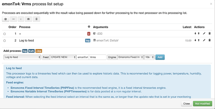

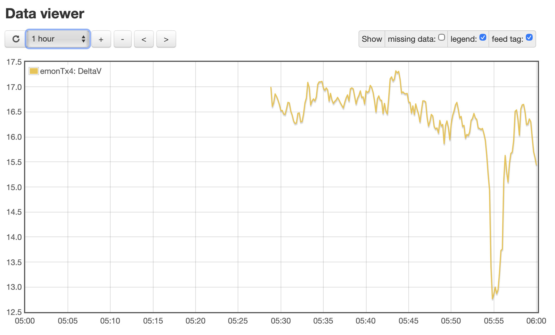

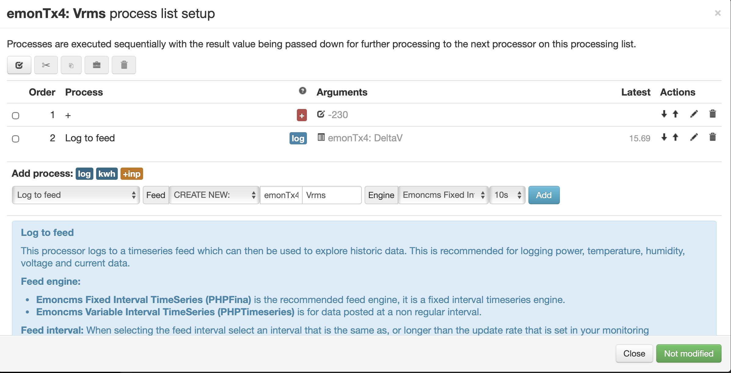

Robert,
Thank you for the information I now have some data displaying.
I now have some CT Clamps is it the same process to set them up or is it different?
Andy
I see you already have the emonTx4 connected and sending data - have you got a splitter so that your emonPi also gets its power and voltage sample from the emonVs?
Basically, its the same, but you’re likely to do different things with the data. You’ll get real power of course, not current from the c.t’s (and they aren’t clamps), so in addition to logging that, you will most likely want to either do the conversion to energy in the input processing (note the difference between ‘Log to feed’ and ‘Log to feed (join)’ also the latter’s equivalent ‘(k)Wh Accumulator’ ) or you can use the energy ‘E…’ value direct from the emonTx4 - bearing in mind that, despite the intention behind the EEPROM library, those energy values aren’t necessarily preserved across a reset of the emonTx.
Normally, you will always want to log the incoming value to a Feed before you do any more processing (you missed that for your voltage input) so remember to log each power to a separate feed first, then do the conversion (time integral if you prefer) to energy and send each of these to a new feed as well.
