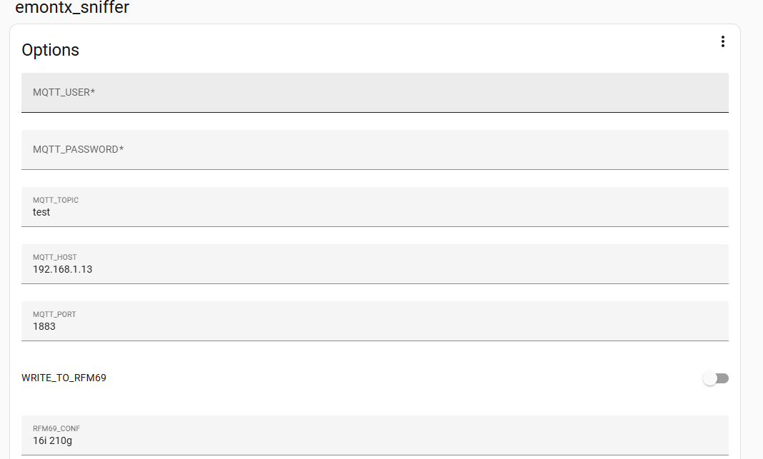

hi, I am testing emontx_sniffer .
from log I can see that RF packets are received… but no mqtt threads are wrotten, see logs:
2026-01-25 18:28:08,554 INFO     MQTT_HOST : 192.168.1.13 - MQTT_PORT : 1883
2026-01-25 18:28:08,612 INFO     timezone Europe/Rome fixed
2026-01-25 18:28:14,819 INFO     no end of line received - incomplete packet
2026-01-25 18:29:12,575 INFO     no end of line received - incomplete packet
2026-01-25 18:29:31,193 INFO     no end of line received - incomplete packet
tested mqtt_test.py and is working, but I can’t see stream on mqtt thread

I am receiving right RF packets, but no mqtt packets are generated.
I put mosquito on listening for my “test” threat
mqtt_test is working fine…
did you configure the broker ?
yes , username and password are empty, but mqtt_test is working

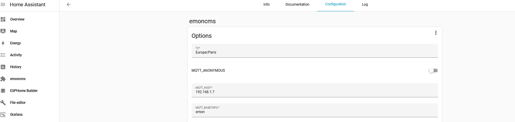

you expect data in emoncms addon or somewhere else ? you did not specify any MQTT_USER and PASSWORD ?
maybe you use the anonymous option in the emoncms addon conf ?

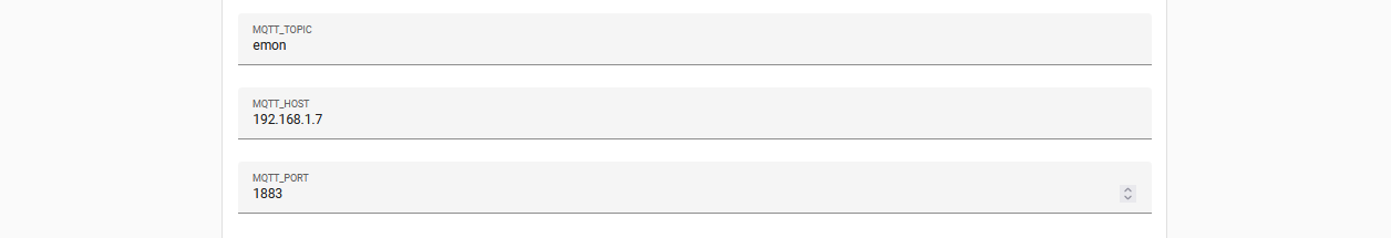

conf for the emoncms addon
usually MQTT_TOPIC is emon, except if you configure emoncms to revceive on another topic
I expect data on mosquito mqtt server.
no, I did’nt specified login and password, becasue my mosquito not use it
