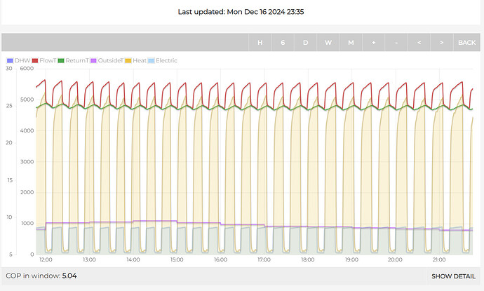

New Heat pump user Can someone look at this graph and tell me what is happening?
My first week of getting Data from my Fujitsu heat pump. I have set a low 0.5 curve on my Weather compensation. Turned off all room stats by turning them to 30c and
Got it running 24/7.
The house is very warm maybe slightly too warm but I can get that right in the future.
What I’d like to know is How to interpret this graph. The first one is the whole day and the second one is a closer look at the second half. I’m happy with heat and happy with the COP but just want to know if this is normal or what is happening?
Any advice appreciated.
Hello! Welcome to the heatpump club :slight_smile:
What you’re seeing here is known as “cycling”, where the heatpump cannot modulate low enough in mild weather. This is very common and not something to worry about; 3 cycles per hour is an acceptable level.
In detail, the heatpump is producing 5kW of heat, yet the radiators aren’t able to emit that heat at such a low temperature, which forces the heatpump to run for a bit and then turn off for a bit while that generated heat dissipates into the house. You’ll probably find the mean heating power to be around 3.5kW for the period you’ve shown. (Click on Show Detail in bottom right)
To reduce the cycling, ensure all radiator valves are open. You could also raise the WC curve a little, though you’ll need to rely on room thermostats to prevent the house from over heating. Basically, cycling on the room temperature instead of the flow temperature.
When the weather is colder, the curve will select a higher flow temperature, which will allow the radiators to shed the heat more quickly, and require less cycling of the heatpump.
Hope that helps.

I did wonder if it was cycling but I wasn’t sure because looking at the bottom of the cycle it still seems to never really stop, its still using about 83 watts!
One more question! in those cycles it seems that its dropping down to about 900watts before it stops so does that mean my system it can modulate down to 900watts ?
That seems very good to me as I thought it would be about 2KW.
Its a 10Kw fujitsu waterstage.The Builder wanted to install a 16KW heatpump but I persuaded him that was too big.

That is the power for the circulation pump, which is kept going between cycles + background system power use (electronics etc.).
Yeah, 16kW would have been massively oversized. Dodged a bullet there!

from your graphs it shows that your heat pump is still way too big and even on it’s lowest output is cycling a lot ( 3 per hour is still far too much ) would love to have seen the heat loss report for the install. my bet is a proper heatloss calculation would have come in around 4kw to 5 kw @-3.
you should be able to drop the flow temp a little more but with such an oversized heat pump you may benefit from timing the heating into some blocks of 4 hours on and 2 hours off in the milder months although it would be probably be fine all year round. this would increase the effeciency quite a bit. ( not the calculated COP but the actual electrical usage)
