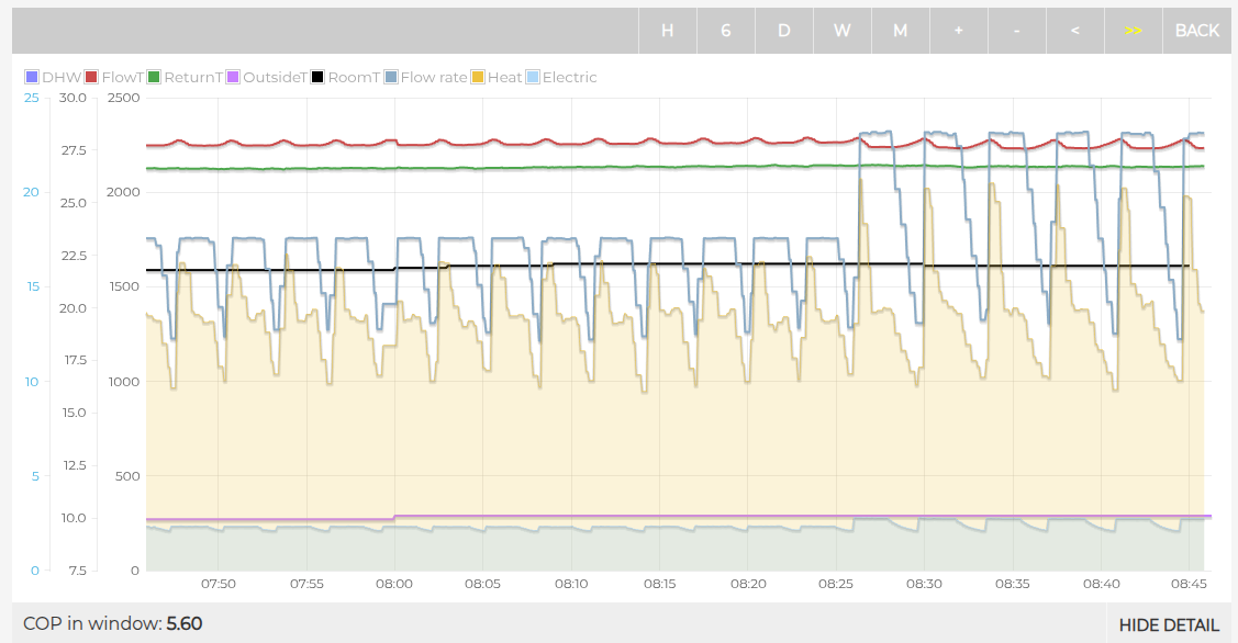

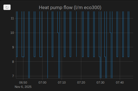

Hey Dave,

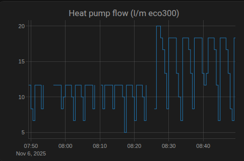

So connecting up to the local econet api on Home Assistant I see the same pattern of oscillation over a 4 min cycle.
The image above is with a limiter of 70 on maximum pump speed. If I reset to default (no limiter/100) then I get the following.
Below is the same period on my heatpumpmonitor dashboard
Econet300 shows a range from 5l/m to 20l/m
My flow meter shows range of 12.1l/m to 23l/m but both show the same oscillation. I’m going to reinstate the pump limiter now as the 10l/m instant ramping up is very loud and will cause unnecessary wear on the pump.

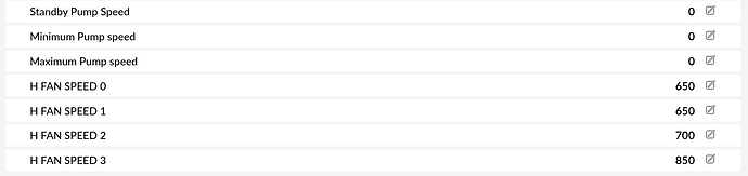

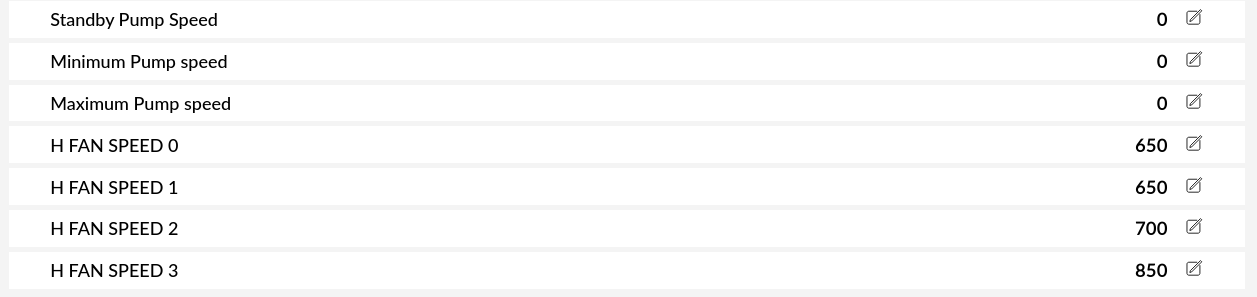

Sorry to resurrect this and slightly change topic, but I’m wondering Matt (as you are the only person I’m aware of that has the newest firmware) are you able to fiddle with some settings and see if they work? I think you need the new firmware for them:
These ones are in service parameters (0000 password), all in “Main heat source”:
  • Purge power (think just lets you set a pump speed in % for manual purging)
  • Manual defrost (why not)
  • Reboot the unit
And these in service parameters (1234 password), all in “41 Heat Pump Settings”:
I think you’re already playing around with the pump speed so i guess you can change that.
I’m most interested in the fan speed settings :slight_smile:
Hey Matt, I had this pump speed oscillation issue as well and had someone from Grant around (due to a different issue but chatted about the pump speed as well). He said the pump speed oscillation comes from a protection mechanism. If the flow rate is too low while the compressor is running the pump will run at 100% for 2 minutes before dropping down to its normal PWM regulation/speed again.
This scenario can come up if e.g. your system is too restricted to reach the minimum flow rate at your minimum pump speed setting.
To fix the oscillation issue you need to find the sweet spot for this setting to be as low as possible while still reaching the minimum flow rate (I unfortunately forgot what the minimum for this is)
I rang Grant up, apparently the fan speed functionality isn’t available yet, seems like they are testing internally and then they’ll make it available. The person I spoke to said you wouldn’t need a firmware update on the ASHP itself, not really sure what the actual case is as you had yours upgraded Matt and I had heard previously that the purge function wouldn’t work until the actual ASHP firmware was upgraded, so who knows.
I did figure (from my own testing) that the fan speed when not on silent goes to 650rpm when below 5c ambient temp as measured on the ASHP itself, I wondered if the fan speed was more of a function of things like coil or suction temp but it lines up perfectly - as soon as outside temp drops below 5 the fan goes to 650, and when it gets back up to 5 it drops back to 500, so I assume the various H FAN SPEED settings are for fan speeds in normal mode at various ambient temp conditions. Will be great to get these - aware lowering fan speed would result in more defrosts but i dunno, 650 is very loud IMO :slight_smile:
