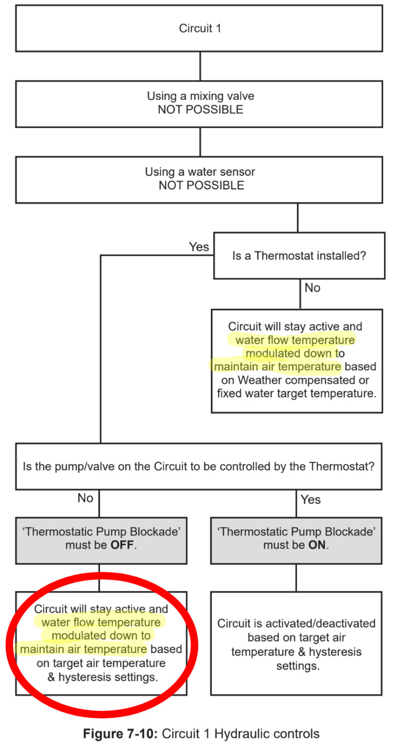

It sounds like you have pump blockade enabled? This magic will only happen when pump blockade is disabled, which is the default option.

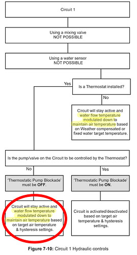

Just found this Glyn…
7.14 - Circuit Operation
7.14.2 - Weather Compensated Circuits
With a thermostat
  • When a target air temperature is set on the assigned thermostat, the smart controller calculates flow based on ambient temperature, heating curve and current circuit air temperature.
  • If ‘THERMOSTATIC PUMP BLOCKADE’ is enabled, the circuit demand will be stopped once the target air temperature set on the thermostat is reached.

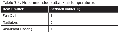

  • If ‘THERMOSTATIC PUMP BLOCKADE’ is not enabled, once the target air temperature is achieved the smart controller will use decrease the flow temperature target by the ‘DECREASE WATER TEMPERATURE’ value, which is set correctly will maintain the target air temperature. Refer to 7.3.1.3 for recommended setback values based on heat emitters for the circuit
Section 7.3.1.3 is talking about night air temp setbacks so it doesn’t feel very applicable, but here is the setbacks:
I think they mean Decreasing fixed water temperature (confusing use of the word fixed there if they do), which is in Service Parameters → Installer controller →Circuit 1 H1 → Decreasing fixed water temperature.

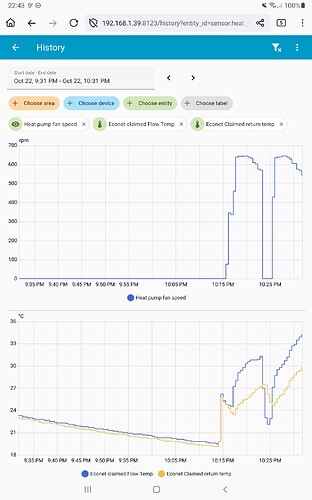

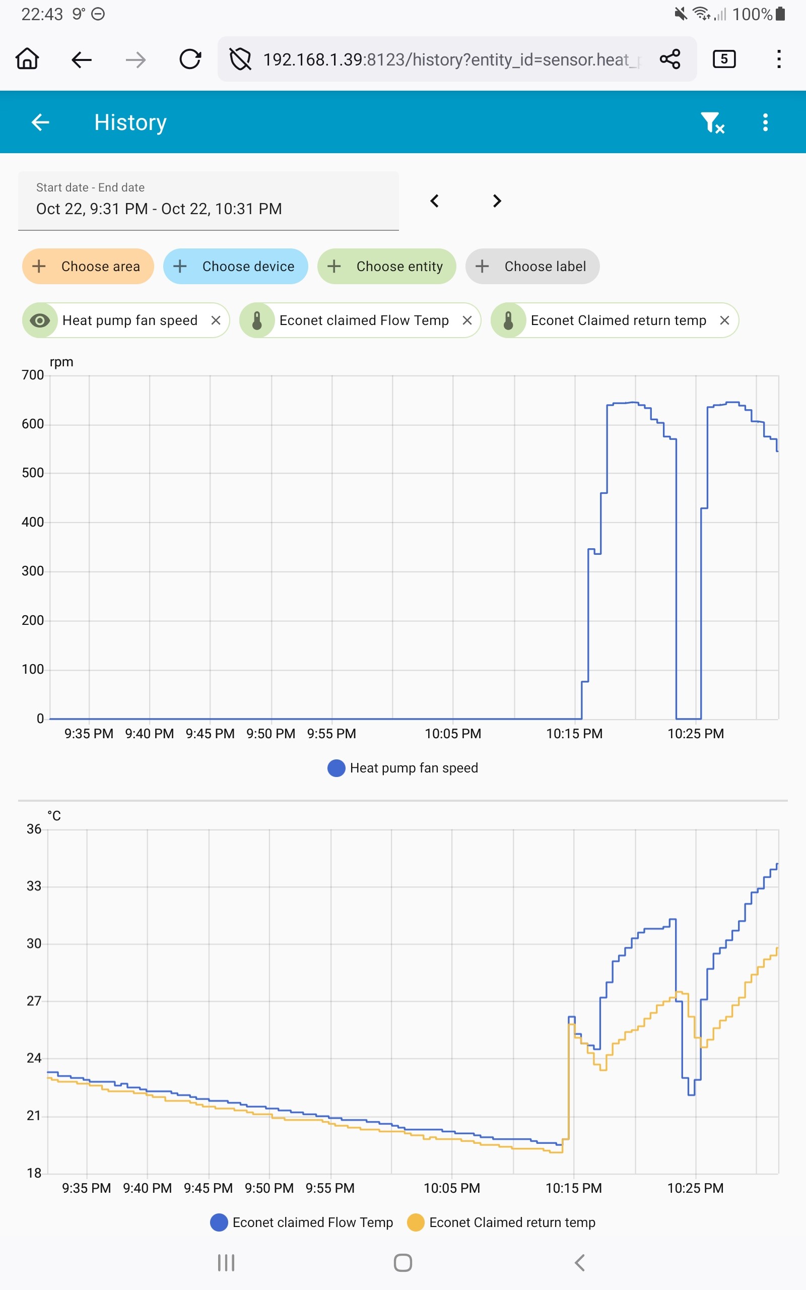

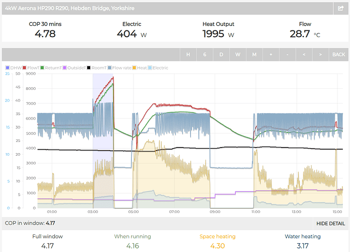

Not directly related to previous, so maybe needs a new thread, but I have seen a couple of defrosts recently, which happened at about 7c ambient, 99% humidity, as the compressor ramped up fast. You can detect it in home assistant since the fan stops, while the compressor keeps running. Obviously flow and return temps swap too, but that can happen anytime to a small extent. This is what it looks like.The impact on house temp was small to none.
Fwiw, my (room temp) hysteresis is set to 0.2c, and I check 17 temp sensors in 5 main areas, to decide whether to start or stop the heatpump. With very low wc curve it only cycles off when the sun come out big time, else it just about holds temperature in the 0.2c range. If it does cycle, I may need more hysteresis, but at current ambient 0.2c works fine. Did need some fine tuning of wc curve though.

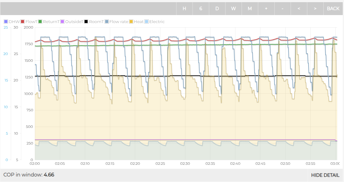

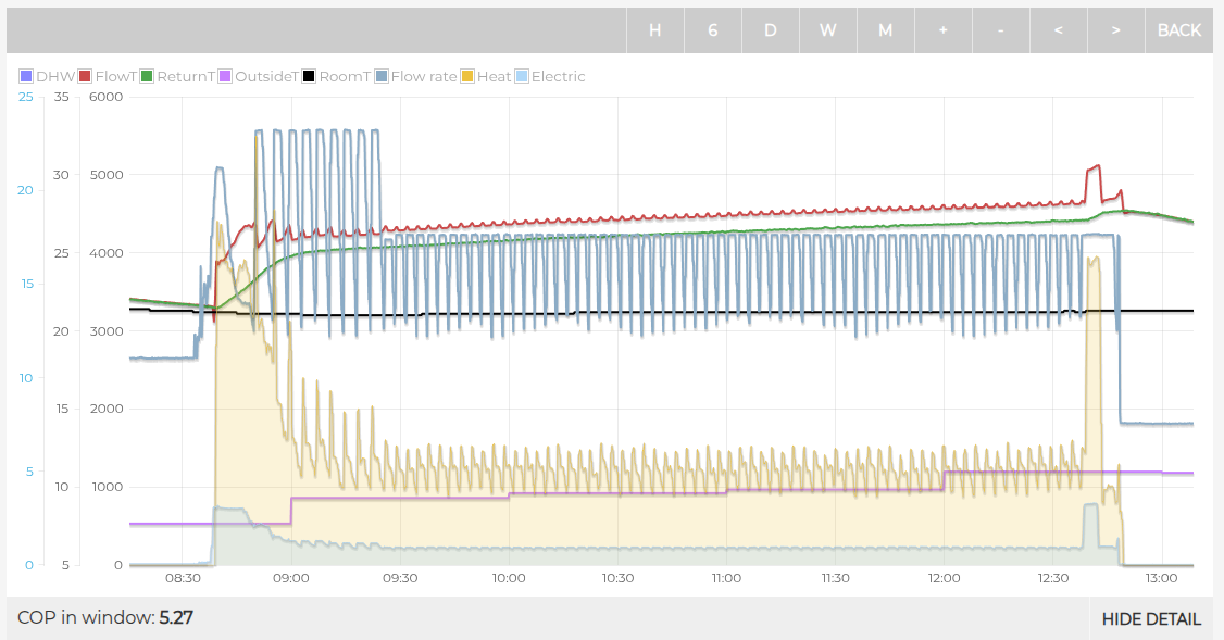

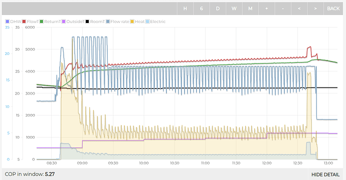

Heat pump doing pretty serious short cycling. It’s running general factory defaults (after updates) other than set-temps, wc heating curve 0.6 and room temp correction at 1.0.
The sharp ramp from 11-23l/m every 4 mins was causing a lot of noise, so I reduced the max pump speed to 70 (see next picture for impact). This resolved the noise and improved COP, but feel I’m mitigating the problem rather than solving it…
Any thoughts as to what I should change? (live dashboard link).

Mmm I’ve seen this before, an installer recently showed me the data from a recently installed 6.5kW Grant, it’s been doing this since day 1: Emoncms - app view
Out of interest, could you try increasing the WC curve to increase the flow temperature to see if this makes any difference. I think this could be some sort of software gitch.

Thanks for getting back Glyn, I agree that looks like an identical pattern to what I’m seeing, if it’s a new install it maybe running the same firmware. I’ll bump up my WC curve and see if that has any impact, frustrating as it’s already off for long periods as hitting temp.

As the flow temperature is lowered, the emitters (radiators?) will be unable to emit as much heat. There becomes a point where the emitters are unable to emit the minium modulated output of the heat pump, cycling is then inevitable. UFH can run a lower flow temperature than radiators without cycling, since UFH generally has much more emitter area. But as long as not cycling more than about 4 cycles per hour, then this nothing to worry about.

It looks like the flow rate oscillation issue is still present, this looks like a bug to me. I reckon you should try and hassle Grant again :sleepy_face:
Thanks for your thoughts on this. I’m running at WC curve of 0.8 (up from 0.6), but the recent cold weather and higher flow temps (35-38C) doesn’t seem to address the cycling. Each cycle is between 3 and 4 minutes long, so 15-20 cycles an hour. You’ll see there is a short period between 5-6am where it is not cycling and working as I’d expect. I can’t match the cycling to either the flow temp or the proximity to room temp, so struggle to narrow down best settings to remedy.

I wouldn’t really call this cycling, since the compressor is not cycling. The fluctuation in heat output is caused by the circ pump speed oscillating. Quite bizarre
Sure, I’ll add that info
I would suspect the flow sensor lying.. Bubbles or microbubbles, If It is an ultrasonic sensor, really mess up measurement, or maybe there is some flapping valve someplace? Does the econet controller (Ok, much less accurate I know) show the same wobbles, or is it an artefact of the emon system??
The oscillation is definitely occurring the ramping up of the pump woke me up, which is why you see the heating being turned off at 3am. With the max pump speed limiter set to 70 this is much improved. The data history on the econet controller is at 5 minute resolution (averaged) and as the oscillation is over a 4 minute cycle it doesn’t show this effect.
Ah, i am querying the local econet api with home assistant so I get 30 second data granularity. I am urprised the water pump can/does ramp up and down that fast. Sounds like a bug in the control system to me.. Mine doesn’t (can’t?) change at anything like that rate.
