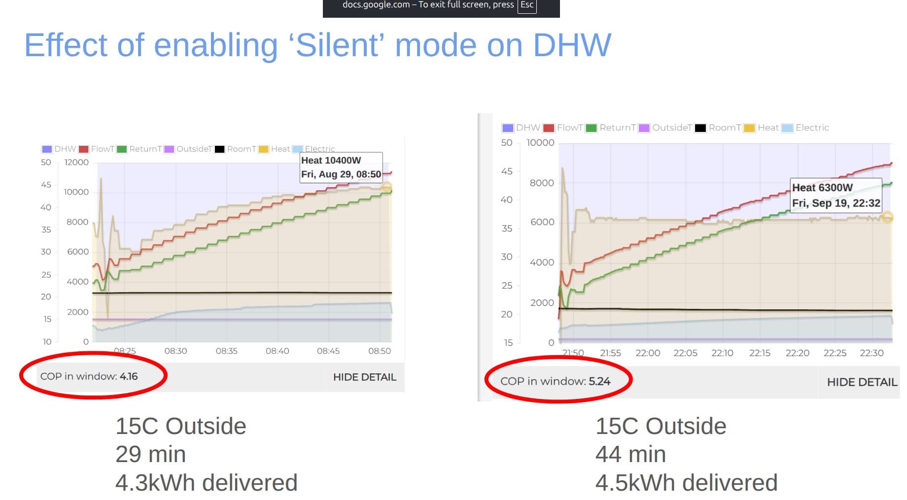

You’ll notice a significant increase in COP with a lower DHW set point e.g 45C, also allowing at least half of the tank to cool down before reheating makes the cycle much more efficient, e.g set a hysteresis of 5 or more.

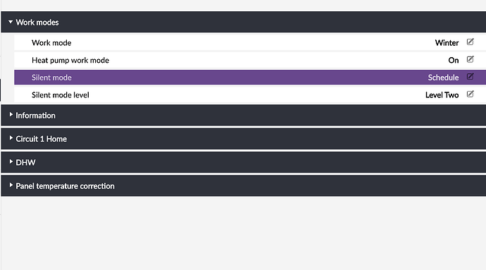

I’ve not found a way to adjust the speed of the circ pump, but you can use Silent mode scheduled to limit the compressor output, I found this increased efficiency:

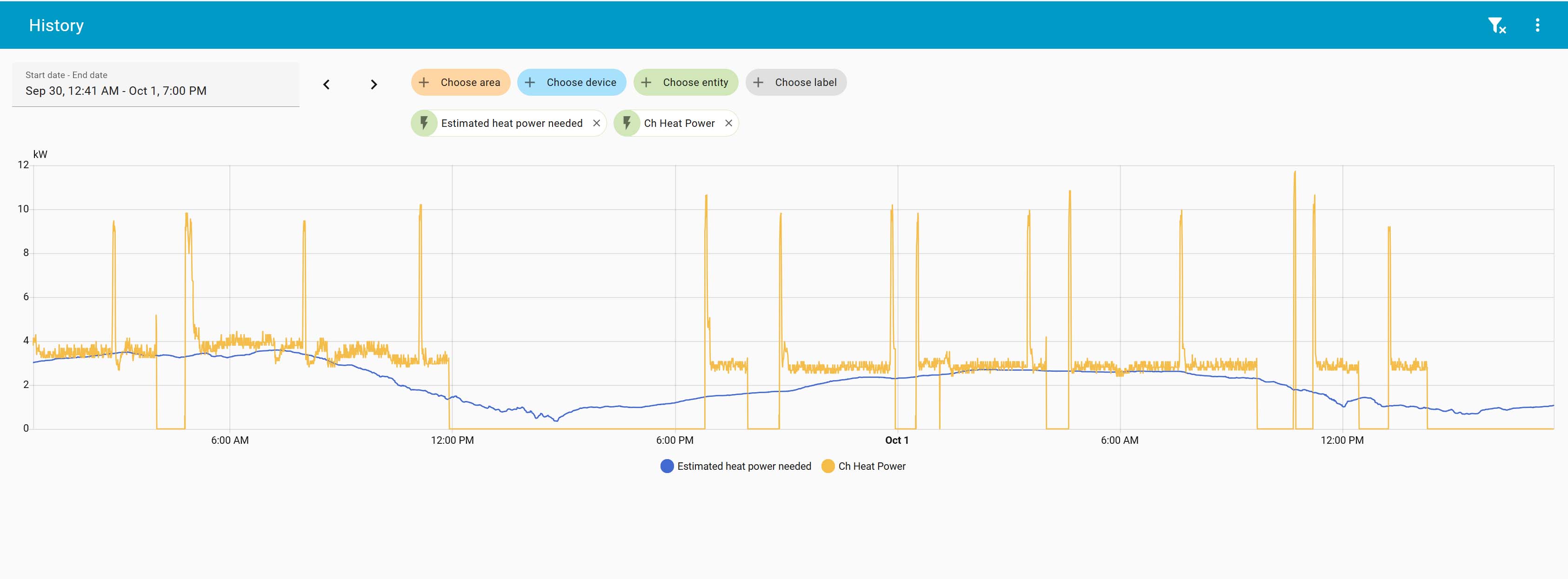

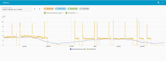

I suck all the interesting Grant data from the local API into Home assistant. The spikes below are where the compressor starts, and the oil recovery (every 4 hours in theory but mine is more like 3 and a bit). I do get a lot of solar gain when there is some actual sun .. several kW.
The overnight gap, and one other on most days, is when the system switches to DHW.

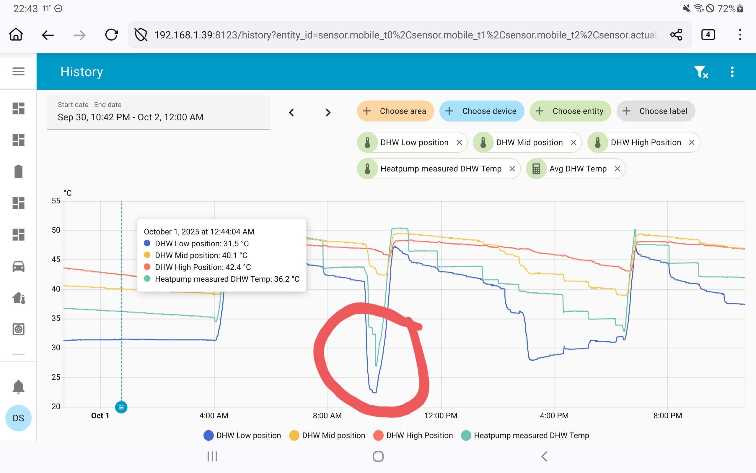

Ah, it turns out even hysteresis of 18c was not enough to stop an unnecessary reheat after two showers.. Cold water coming in got up to the dhw sensor the heatpump thinks matters. Guess I need to actually set work mode to off for dhw, and only reheat on boost.

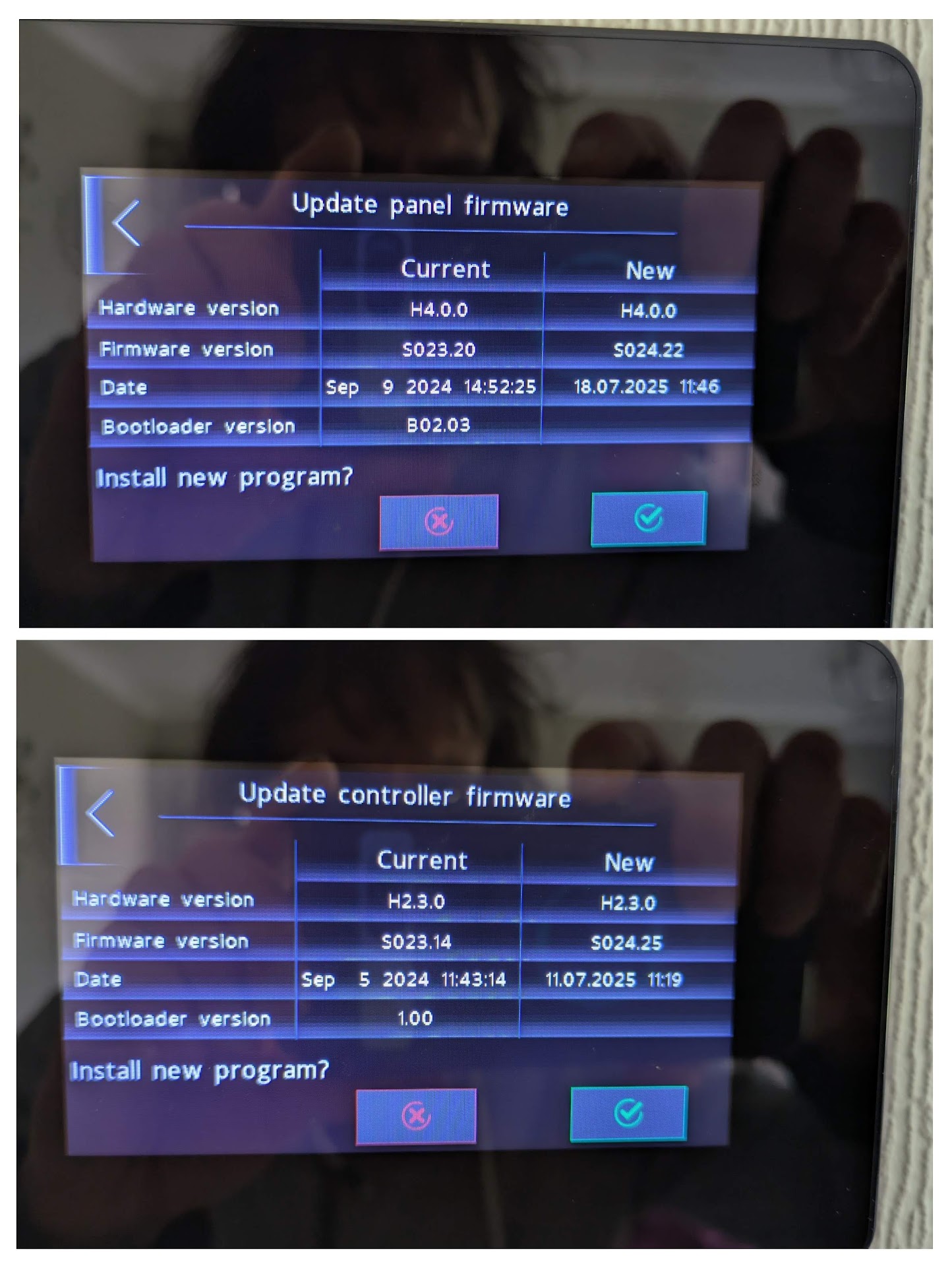

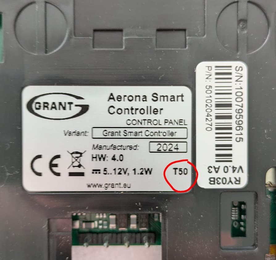

Sorry for the slow reply. Grant send out the firmware update on an SD card, but it’s possible to put the updare files on an SD card and flash it yourself. I’ve attached the firmware update files to this post. There are instructions for how to update in section 11.3 of the latest V2.2 user guide:
Here’s are some more detailed instructions:
  1. Determine which version of the touch controller you have. On the back of the controller there will be printed either “T50” or T50 and then some additional stuff below, usually HW2.0X (The X is the important bit). My controller is the T50 varient, the other varient is the “X” varient
  1. Select the correct FW version: There’s two different firmware versions, one for “T50” and another for “X”. Make sure to select the correct one to match your controller:
Grant-FW-T50-controller-econet-C114.01.20-ecotouch-S024.22.zip (4.1 MB)
Grant-FW-X-controller_econet-C114.01.20,ecotouch-S024.22.zip (1.4 MB)
  1. Extract the .pfc files into the root of a freshly formatted FAT 32 SD card (max 32GB)
  2. Once the files are on the card, insert it into the bottom of the smart controller touchscreen display (with the gold pins facing you). It should then pop up with a prompt to update the two firmwares.
  3. Select PANEL first, let it update and complete
  4. Remove the card for and reinsert it and select CONTROLLER.
  5. Grant recomend doing a factory reset after a firmware update with service code “7586” then "RESTORE DEFAULT SETTINGS’ then power cycle the wiring center. However, I didnt do this. The only issue I had is that I had a AHS (additional heat source) error. To fix this I had to go into Service settings code “0000” and switch off AHS additional heat.
This is what the update screens looked like for me:

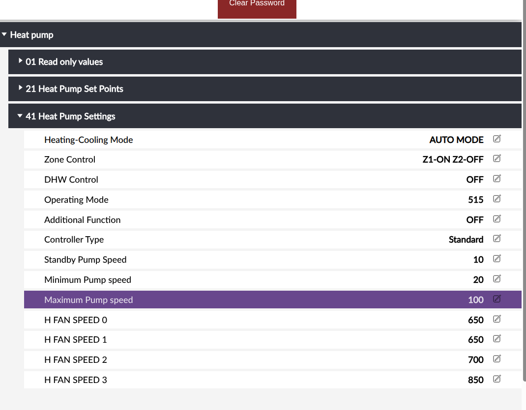

There does seem to be some options to adjust pump and fan speed, I’ve had a brief play with these, but they don’t seem to have any effect.

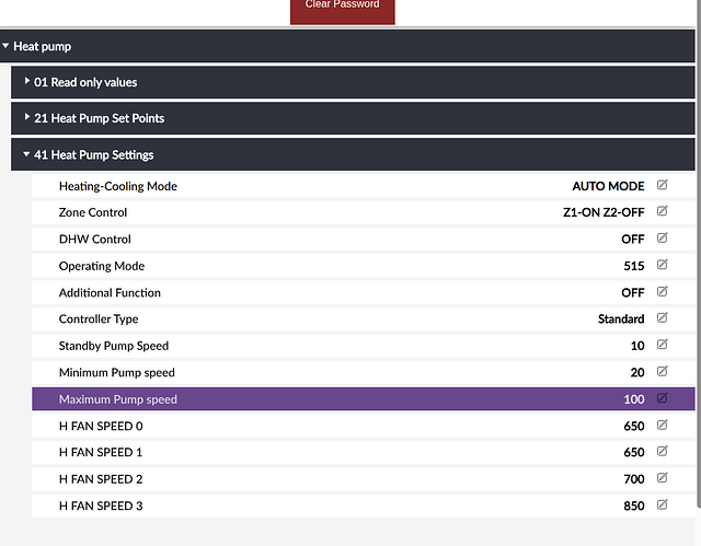

I don’t have access to the new pump speed settings (you show above) through my user or service parameter menus, you may have additional access. I spoke to my installer and he’s still chasing Grant for an update.

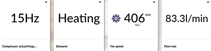

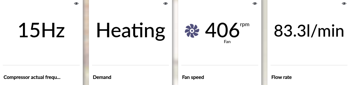

Looking at your stats, your pump does seem to be modulating (14-30l/m) and similarly the recently installed 4kW model in Norwich (3-28l/m).
My 4kW shows constant 26.5l/m for HW and 24l/m for heating (from my flow meter), the systems own data shows 83l/m but lets not worry about that.
Either way, I’m totally happy with the pump except for the flow, due to low heat demand the pipes aren’t oversized, which means the system is pretty noisy and tends to get turned off.

You can access the pump settings with service code 1234
Mm it’s strange why your pump is now modulating lower. Try switching off “Pump Blockade” for under Circuit 1 in the Service Settings.
Silent mode should help reduce the flow rate during DHW
To enable Silent mode you need to set Silent mode schedule, I’ve set 24/7 and then set the Work Mode for Silent Mode to Schedule:
I think you should contact Grant and ask why your circ pump is not modulating, your flow rate looks totally different from all other Grant R290 systems I’ve seen. The flow rate makes no attempt to modulate down. I think this could be a fault.
