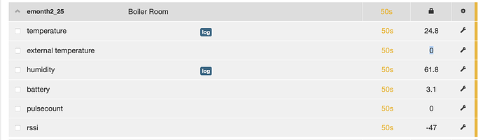

New user here. I’ve just unboxed my Level 3 Heatpump kit and started it up. I’ve bought an extra EmonTH with external probe, which works. But for some reason the external temperature is always 0. Why would this be?

2025-07-28 07:00:27,924 DEBUG    MQTT       Publishing: emon/emonth2_25/temperature 24.5
2025-07-28 07:00:27,926 DEBUG    MQTT       Publishing: emon/emonth2_25/external temperature 0
2025-07-28 07:00:27,927 DEBUG    MQTT       Publishing: emon/emonth2_25/humidity 59.7
2025-07-28 07:00:27,928 DEBUG    MQTT       Publishing: emon/emonth2_25/battery 3.1
2025-07-28 07:00:27,929 DEBUG    MQTT       Publishing: emon/emonth2_25/pulsecount 0
2025-07-28 07:00:27,930 DEBUG    MQTT       Publishing: emon/emonth2_25/rssi -65

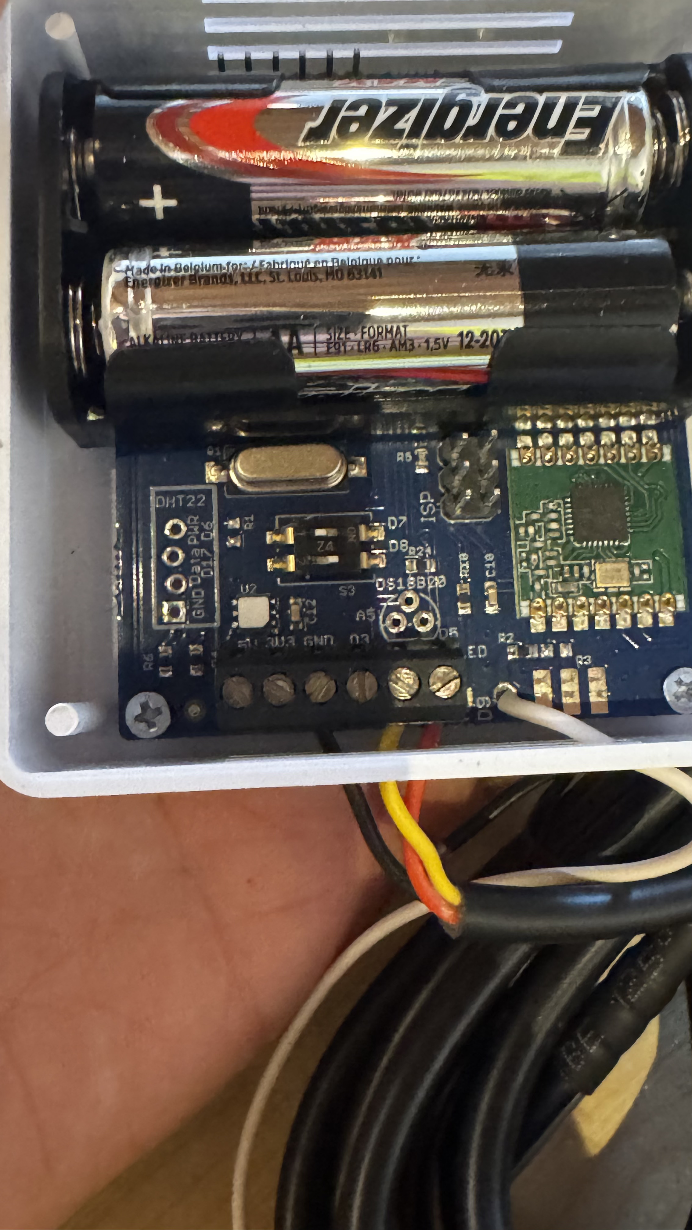

hi @awjlogan I received the sensor already connected from the store, so it was done at the store. Here is a photo.
I haven’t got a serial connector, waiting for one to be delivered so that I can check if the external sensor is enabled.
That looks OK to me. You could try slackening the screws and checking that the wire has been stripped back far enough and not clamped onto the insulation, and then take a battery out for a few seconds so that it restarts and has the opportunity to detect the external sensor again.

@Gwil quick update. I received my FDDI programmer from the shop over the weekend. The fault turns out to be simple. The “external temperature” setting was still on 0, so I turned that on and it’s now recording data.
