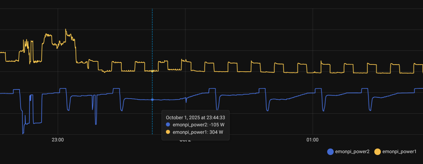

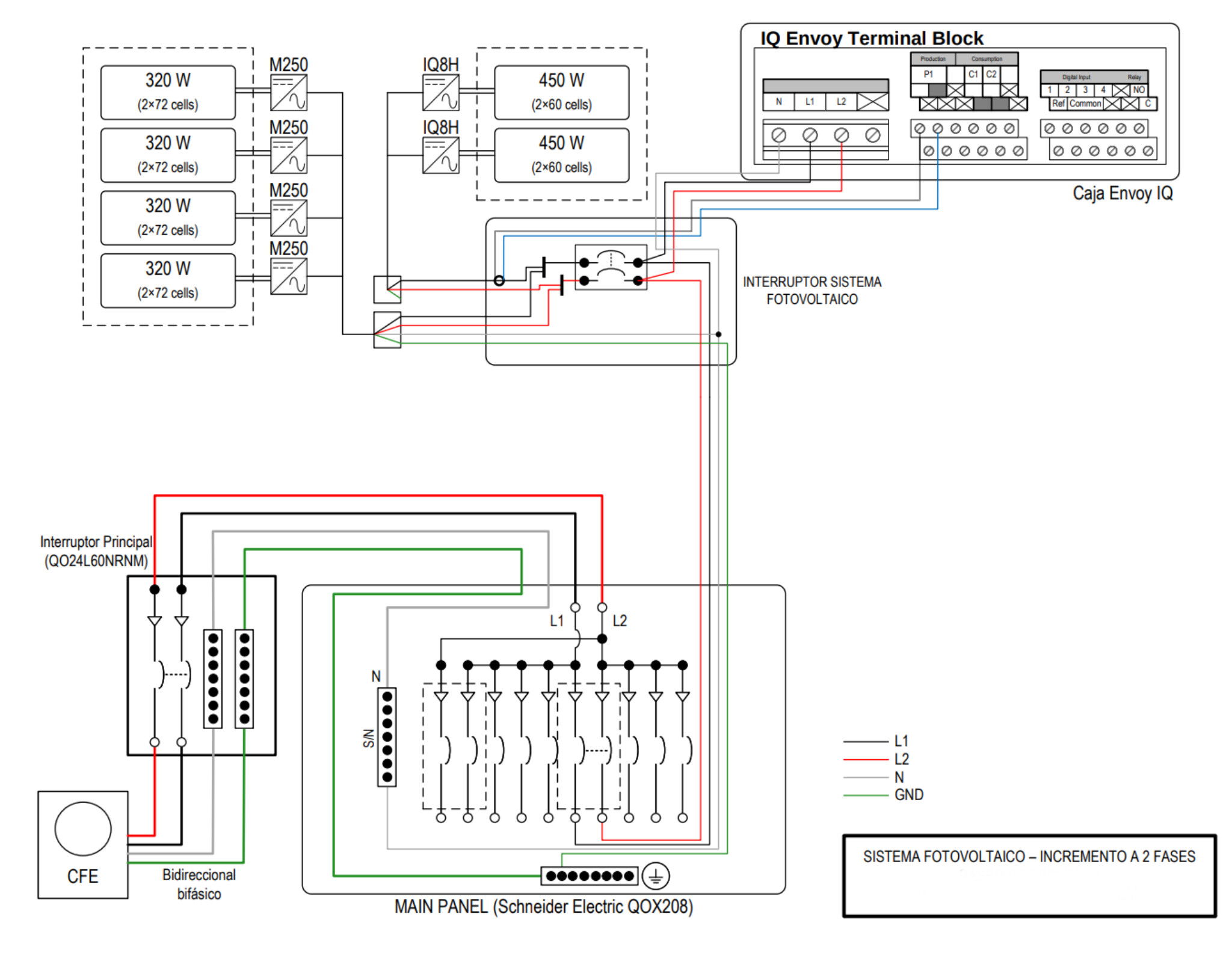

I recently upgraded my electric service from single phase (110V) to split-phase (220/110V). So I reconfigured my EmonPI to use the second CT in the second leg (previously I used it to monitor my solar panels).
However, even with the photovoltaic system turned off, the second leg is showing a negative value when there is no load in that leg.
One CT (phase 1) is pointing towards the load and the second CT is pointing the other way. The voltage sensor (ACAC converter) is connected in phase 1.
This graphic shows how CT 2 is showing a constant value of aroud -100W, with a strange behaviour during the night.
I am wondering if there is something wrong in my installation or if this is an issue on EmonPI (which I had since 2017 and has been working with no issues at all!).
I am using stock SD image 10-Nov-2022 (stable), but I upgraded the firmware to emonPi_CM 1.1.4, with EmonHubOEMInterfacer (which I re-compiled manually to adjust the Vrms value).
This morning I reverted to the previous firmware using EmonHubJeeInterfacer, but still showing negative values in phase 2.

How are your solar panels connected? Are they 120 V connected to just one leg (which one?), or are they 240 V connected across both legs? Where was the c.t?
I can’t see the Y-axis on your graph, I don’t know what to expect, so it does not tell me much.
Your c.t’s should be positioned and connected according to this Use in North America — OpenEnergyMonitor 0.0.1 documentation, which from your description is what you have.
They are Enphase, so I had to use an autotransformer previously to convert 220V to 110V. When I got my electric service upgraded I just bypassed the autotransformer.
Here is the final diagram:
EmonPI’s CT are attached to L1 and L2 between the main breaker and the load center, the AC/AC adapter is connected to L1/N.

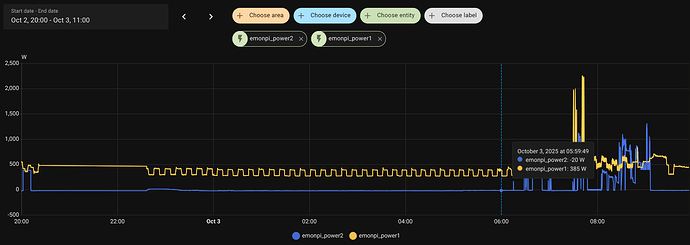

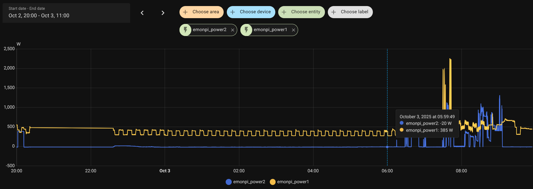

Yesterday I kept my solar system disconnected, during the night L2 was showing a constant negative value of about -20W (yes, the phases are heavily unbalanced, I’m working on that too!):

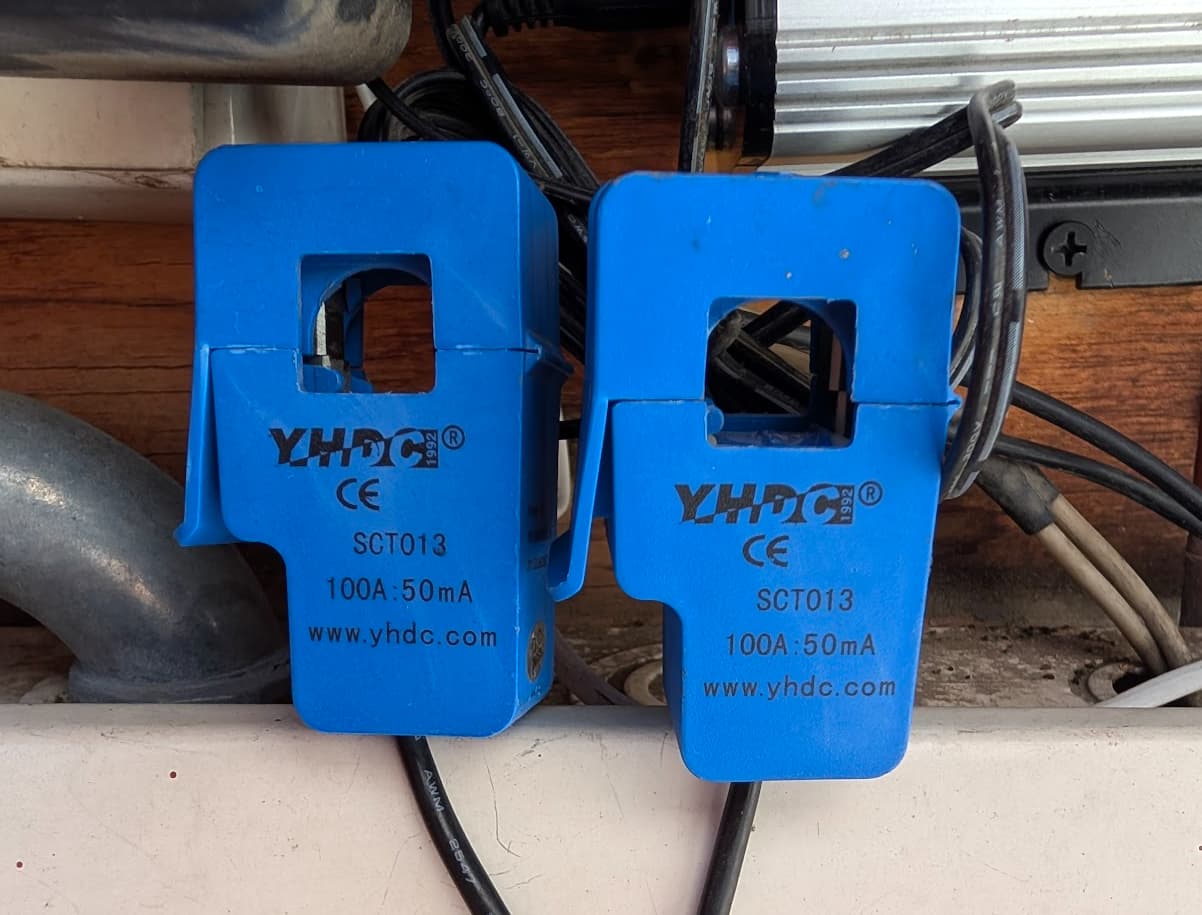

I performed the test you suggested (attaching both CT’s to the same wire), I got a slightly different reading.
Something interesting is: having both CT’s unattached, I got 0W on CT1, and -12W on CT2, so I think there is a problem there.
The CT’s I’m using are:

This is not unusual. A current transformer is naturally inaccurate at very low power, and the 12 W you are seeing is most likely due to interference picked up from somewhere. Remember, those are 100 A c.t’s so the maximum power you can measure is ~12kW, so the error is 0.1% of maximum power - and the bad news is the c.t. accuracy is only quoted down to 10%, i.e. 10 A, or ~1.2 kW; it is ±3% from 10 A to 120 A, even though the emonPi cannot measure more than 100 A.
Don’t adjust the k2 setting to try to ‘correct’ the 12 W error. k2 will indeed change the calibration, but you should do it only when you have a large current that is resistive (electric heaters for example).
This tells me CT2 and the maths both in the “emon” part and emonCMS appear to be correct. So, I cannot explain why you saw a negative current overnight, unless it is very small and it is because your PV inverters (4 on L2) are essentially capacitors while they are not working and giving you a load with a power factor that is almost zero.
If this is the case, you have a comparatively high current almost 90° shifted from the voltage, giving very little real power. If the phase angle correction is wrong, then the current might appear in the wrong quadrant and it will be calculated as a negative power. Again, phase error is a property of the c.t. that is not documented by the manufacturer and gets worse the lower the current you are measuring.

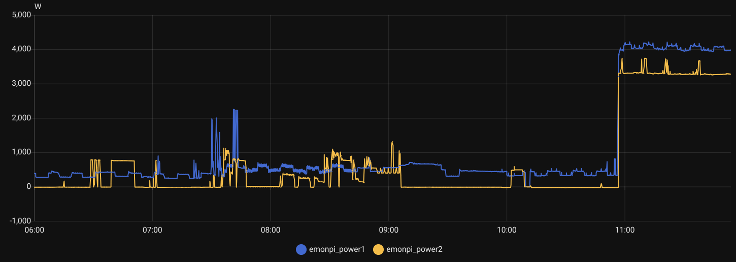

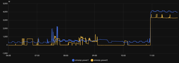

When I have my EV charging, the values seems normal, as we can see in the following chart:

The error has been swallowed up by the 3 kW load. It will still be there, you can’t see it.

That’s interesting to hear! Actually the inverters are connected to both L1 and L2. Specifically, the M250s use the neutral line, while the newer IQ8H models connect only to the two line conductors.
