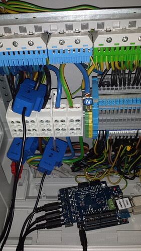

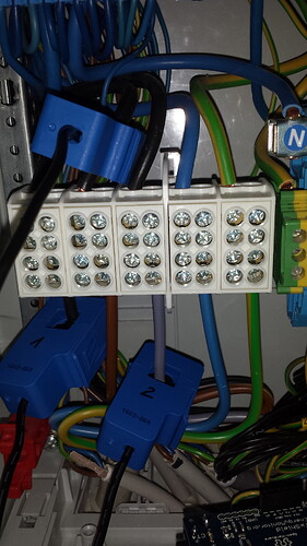

I attach a foto of my situation in the main distribution, maybe you can find an obvious failure. From left to right:
CT1: phase 2 = black
CT3: phase 1= brown
CT2: phase 3 = grey
So the CTs should be in the correct order (phase 2 - phase 3 - phase 1). My ADC is connected to phase 2, therefore this shifted order.

This gets even more puzzling.
You are correct. The standard phase colours are Phase 1 (U) = brown, Phase 2 (V) = black, Phase 3 (W) = grey. The only “error” that I can see is the wires have been put into the terminal block in the sequence 2 - 1 - 3.
Absolute phase does not exist, so what you have done, to make the phase order for the emonTx black - grey - brown, should be correct as far as the sketch is concerned. The CTs all face the right way, and all gave the correct result when you calibrated them on the same wire, so that eliminates a CT wired in reverse.
The only way that I can think of for power to be negative, given that the CT is installed correctly, is for the phase 3 voltage wave to be shifted by 240° ± 180°, that is 60° or 420°, and that is clearly not true - both the numbers for PHASE2 & PHASE3 and the calibration test confirm it. (The standard “discrete sample” sketch records 2 measurements about 50 times per cycle. This sketch records 4 measurements, so very approximately 25 times per cycle, therefore the phases should be approx. 8⅓ array elements apart, which at 0, 7 and 17 they are.)
There must be a rational explanation, but I cannot see what it is.
Hi Robert,
some tries and errors and recalibration it looks much better :slight_smile:
Seems that my electician didn’t care of standards, so the phases are L1=black, L2=brown, L3=grey.
Thanks a lot for your efforts, it did help to get your thoughts.
