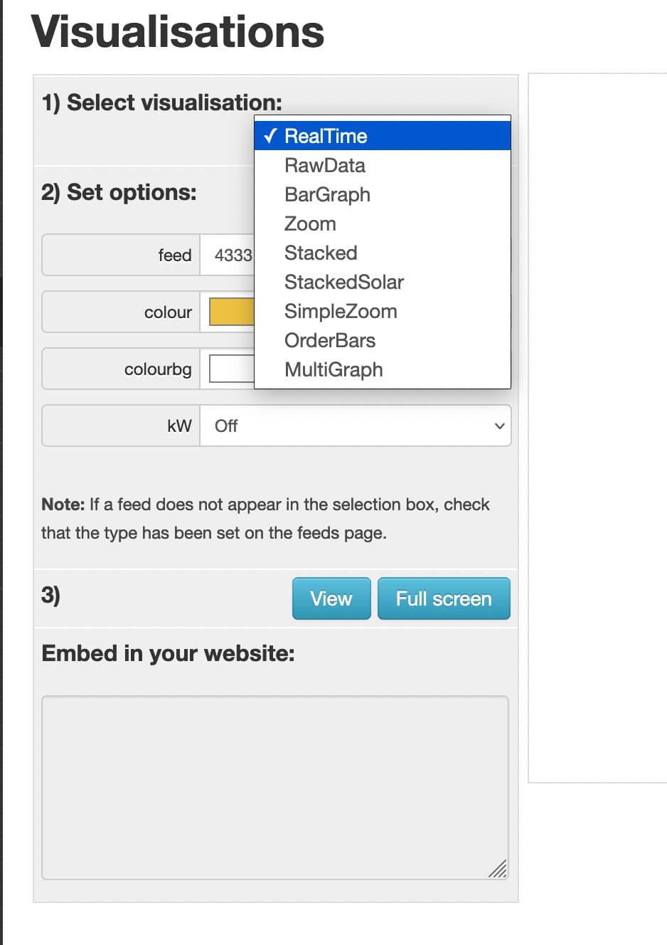

I guess I need to do it here? Select the date range, set scale to -1 and check ‘fix’ box?

You’re on Realtime. Select EditRealtime from the drop-down.
What @Bill.Thomson tells you re the minus - you’ve already done.

I do not see a dropdown there that says “EditRealtime” This is what I see.
What version of emonCMS are you running? Are you logged in as Administrator? Do you need to log in again (it can time out on you)?
This is what you should be seeing (V11.0.5 - V10.7.4 is similar):
Ah I did not realize I am not logged in as admin. I logged out and back in again. Still do not see it. I think this maybe due to me logging in using my gmail account earlier. Darn it. How do I fix that?

It appears from this Topic Cannot login as admin - #7 by Robert.Wall that you are using emoncms.org.
The ability to edit a Feed is not available on emoncms.org - this is one of the differences between the local emonCMS and emoncms.org. So I’m afraid there’s no easy way to correct the wrong data.
