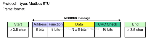

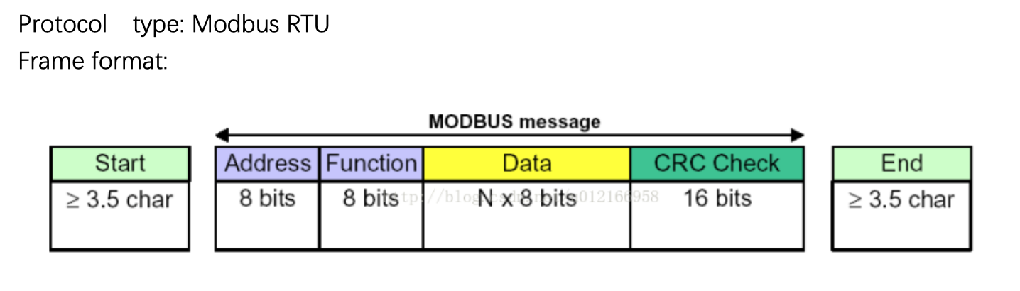

These are the first 10 registers in the table â0x04: Read Input Registerâ of Solaxâ document
âEnergy Storage Inverter Modbus TCP&RTU Communications Protocols v.3.36â
(the file is named âHybrid X1&X3-G4 ModbusTCP&RTU V3.36-English_240611.pdfâ),
and include registers I want to access.
