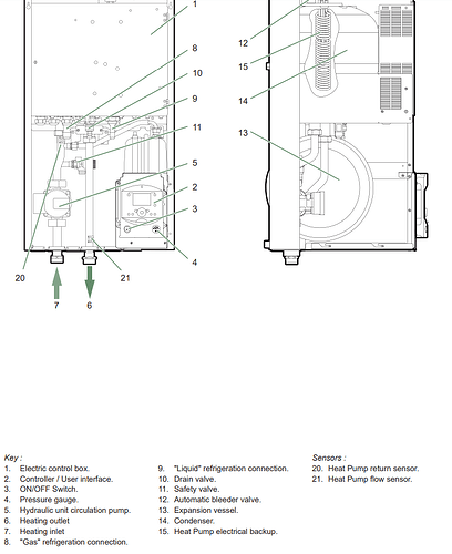

Im having a Fujitsu 10kW pump so the Axioma E4 DN20 QP2.5 seems the right choice.
I believe the Fujitsu unit is a WSYA100ML3
Electricity Meter I’m not sure why I would want one ?? and if I do, which one ?
At this point I don’t know if it has an outdoor or indoor pump or both so confused about how many I need as well.

I’ve had a look at the Fujitsu installation guide, and I can see that for your unit, the circulator pump is installed in the indoor unit, There is also an inline booster heater that you will want included in the monitoring. Therefore you will need two electricity meters, one for the outdoor unit and one for the indoor unit.
Generally, the electricity meters are installed indoors. The SDM120 electricity meters are DIN mount meters therefore they need to be installed in a DIN mount enclosure, this can either by inside an existing consumer unit or we can supply a double DIN mount enclosure for them.
