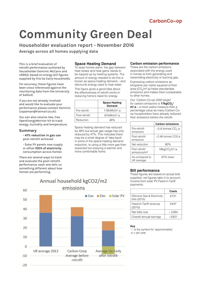

For further context: MyHomeEnergyPlanner is used by CarbonCoop as part of their work on household retrofit, improving insulation and air-tightness of existing households in Manchester to achieve carbon emission reductions of 80% compared to the 1990 baseline. More information can be found about their work here:
Whole House Retrofit - A Community Green Deal
Whole House Retrofit Assessment Method:
http://carbon.coop/assessments/URBED_ASSESSMENT_REPORT.pdf
Recent post-retrofit monitored results for Carbon Coop’s recent retrofit project:
