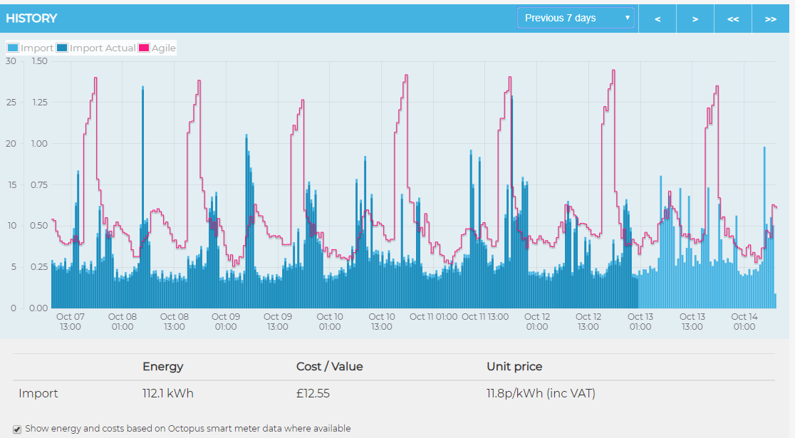

The only way to answer that is to measure it.
You will be able to do that quite easily once your data is flowing - no need for anything else - just a machine to install emoncms on. Then you can get your half hour data and see what your equivalent tariff would be.
I look at this graph and the most important part is the bottom right figure - equivalent to 11.8p/kWh. Octopus fixed rates were about 14p/kWh last time I looked. This is for 2 of us, highish baseload use (too many computers :slight_smile:), minimal movement of use out of peak period.
