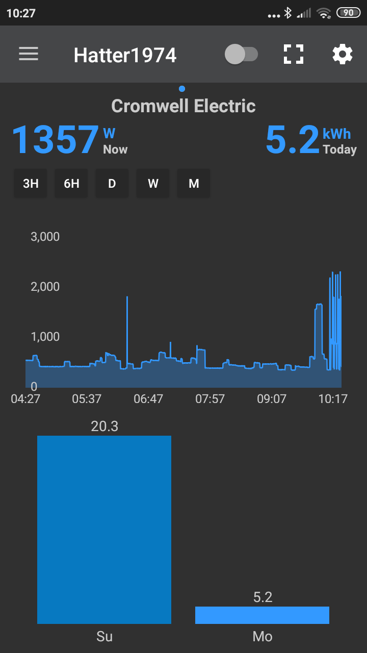

My wife and I both have My Electric (emoncms) on our Android phones. It is perfect for our objective to monitor our attempts to reduce household consumption.
I attach screenshots from the two different phones taken at the same time (within 20 seconds).
One shows a power spike at 06:30 and one doesn’t. What would be the reason for that, given that the information is coming from the same data set. Could it be that each phone is selecting periodic values to plot (every 5th value, for example) and there is a ‘phase difference’ in the data values extracted by the two phones?
I think that is exactly it, but Paul (pb66) may well be along later to confirm that.

I attach simultaneous screenshots from the desktop (top) and android mobile versions of the app (taken around half past midnight today i.e. early hours of Friday morning). I have confirmed from meter readings that the mobile app cumulative daily kWh figure is accurate.
However, the desktop version is showing the following daily kWh values
Sunday 19
Monday 17
Tuesday 23
Wednesday 19
Thursday (no value shown)
Why hasn’t the desktop version posted a Thursday value like the mobile app and why hasn’t the desktop cumulative value reset to zero at midnight?

Hello @Denbigh1974
Have you set your timezone in the My Account profile section? this issue usually occurs when the timezone set in the account profile does not match the browser timezone.
Should looks like this:
Brilliant, Trystan. Thank you!
