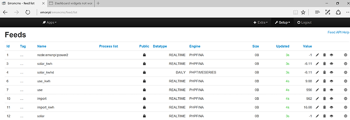

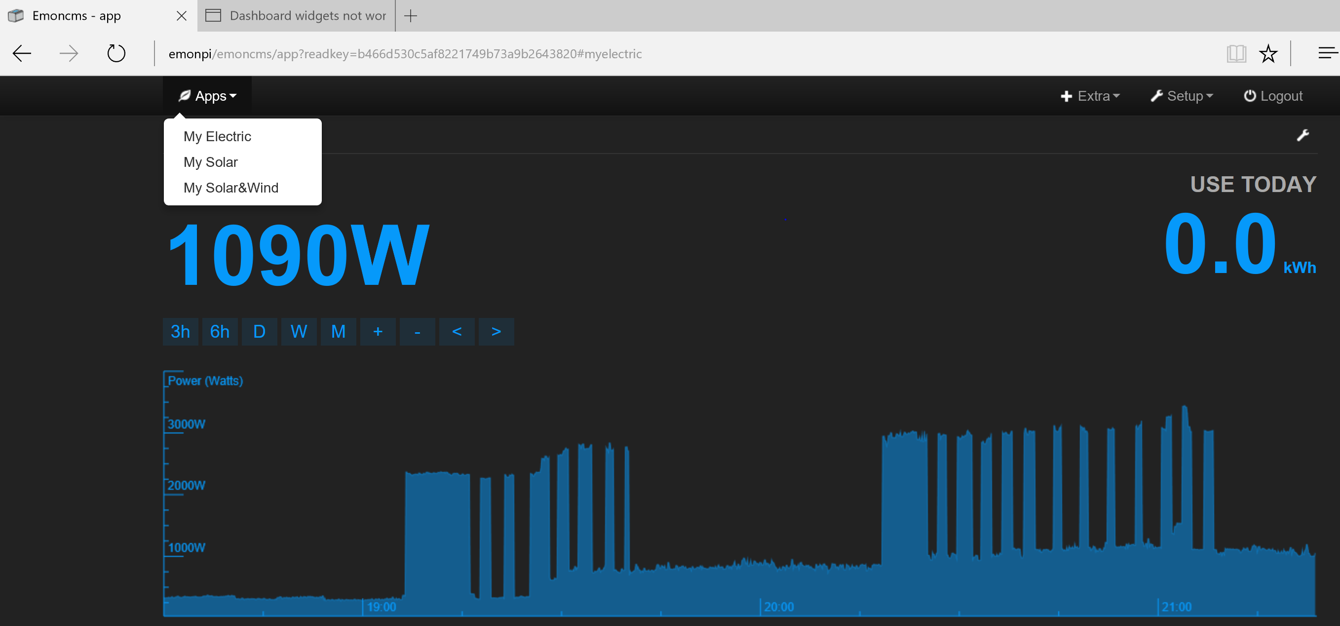

I have updated my EmonPi to the May preview image successfully. All appears to be working but for the kWh output in both the My Electric and My Solar apps. The real time power usage displays fine just the kWh is not updating although the associated feeds in the feed view are working. Any ideas?
The feeds page is:

The processing and feeds do not look correctly configured to me. Where do you have CT1 installed?
ā€œuseā€ and ā€œuse_kwhā€ can only ever be positive unless your appliances can generate power.
It looks like at least the solar CT, but probably both CTā€™s are inverted
Are you confusing ā€œgridā€ and ā€œuseā€? The ā€œuseā€ should be the sum of ā€œgridā€ (pos when importing) and ā€œsolarā€ (pos when generating). You could try something like
input1 (grid CT)
log to feed ā€œgridā€
allow positive
log to feed ā€œimportā€
power to kWh ā€œimport_kwhā€
input2 (solar CT)
log to feed ā€œsolarā€
power to kwh ā€œsolar_kwhā€
  • input ā€œgridā€
    log to feed ā€œuseā€
    power to kwh ā€œuse_kwhā€
However on a emonPi you can use the 3rd input to process ā€œuseā€, which I believe is provided to give ā€œgridā€ plus"solar" combined to circumvent the potential hazard of the mqtt values arriving in a different order and out of date ā€œlastā€ values being assumed current. In your current setup when input1 does itā€™s processing it uses input2 which has not yet been updated, my example puts the use of input1 in the processing of input2 which should be ok but not 100% reliable.
so you could remove the +input and the 2 ā€œuseā€ feed processes from the other input and have just
in input 3, this would be simpler and more reliable/accurate,

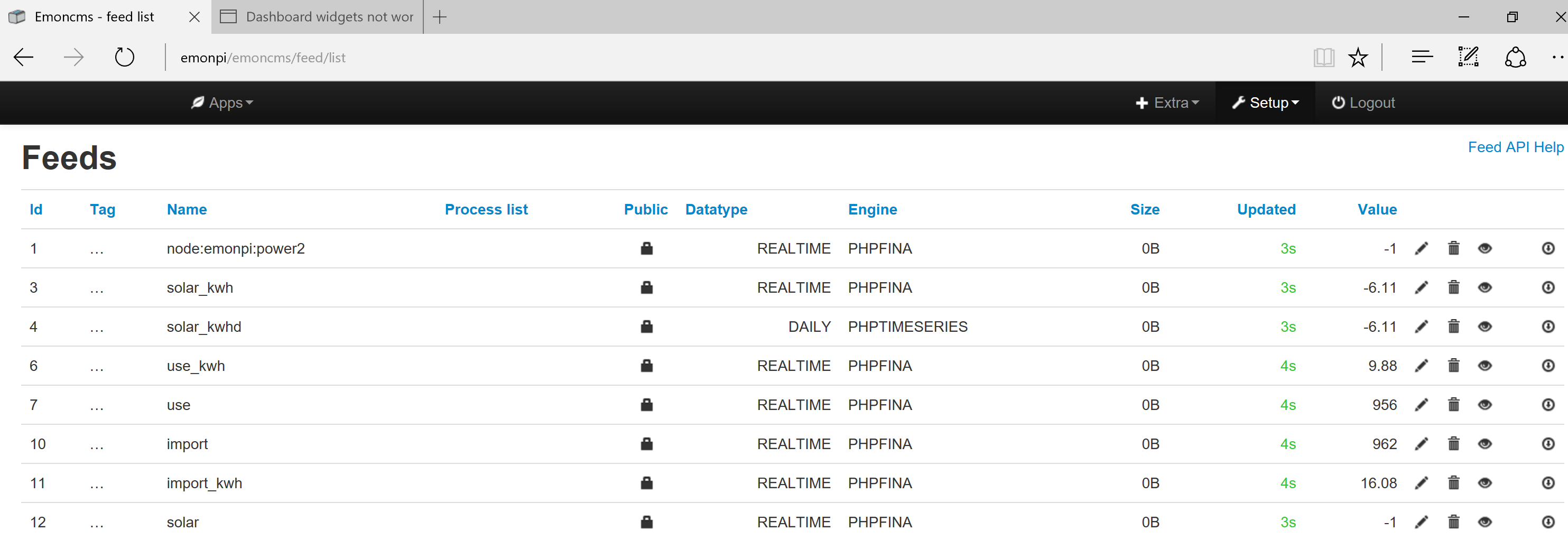

Thanks @pb66 you have solved another issue I was having in terms of the Solar app and defining grid, solar and use. I have updated my inputs according to your detailed instructions which make sense. The third input on the emonPI is referenced by default as power1pluspower2 for anyone trying to follow the thread, it now looks likes this for Inputs
My feeds are also updated accordingly, hopefully you can see values for kWh being recorded:
I think I now need to wait to see what tomorrow brings in terms of solar kWh and use kwh

@pb66 thank you for your help. The instructions you provided sorted out my setup for me. I can now report that both Emoncms apps for reporting Electric and Solar are both now working as they should. I think I got confused with the polarity in combination with trying to work out if my setup was type 1 or type 2 (it is type 2).
