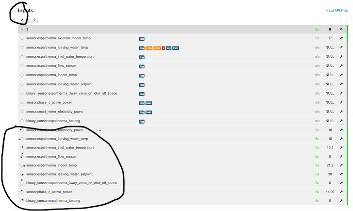

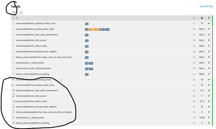

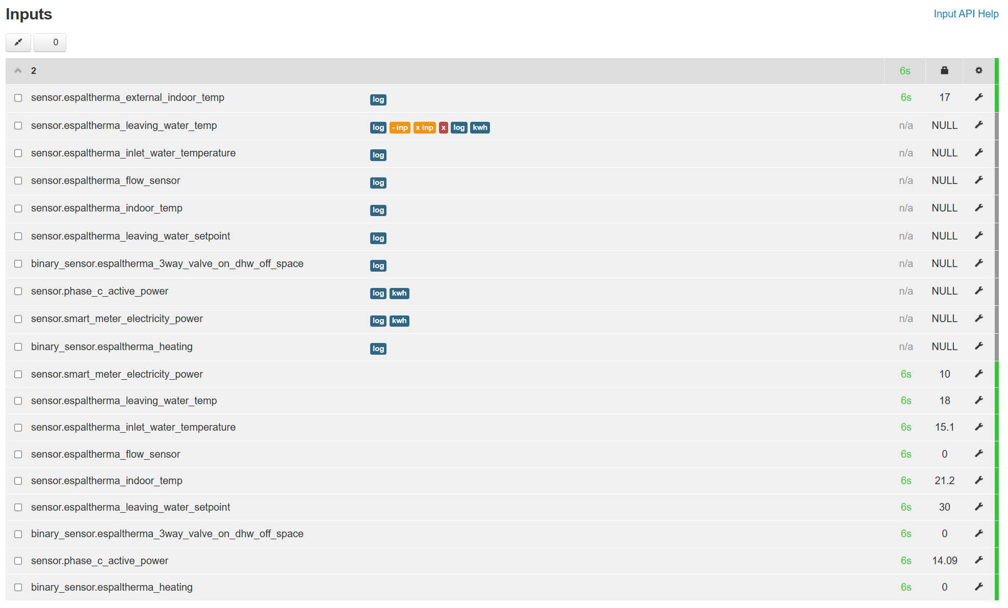

At 1am this morning my logging feeds all show as NULL:
I can create new feeds and they update as normal, but I have no clue how to fix the existing feeds (or why the indoor temp feed is still working). I see that there were some fixes pushed out in homeassistant 2025.9 for emoncms_history, could that be related?
Delete the new Inputs (that view is the inputs page) and the input should revert to the old one that has the logging to a Feed defined.

Click on edit, at the top, Select the ones without any blue boxes next to them and delete them (this doesn’t delete data).
The ones with blue boxes, should then show active.
That didn’t work, instead I had to delete and recreate the NULL feeds.
