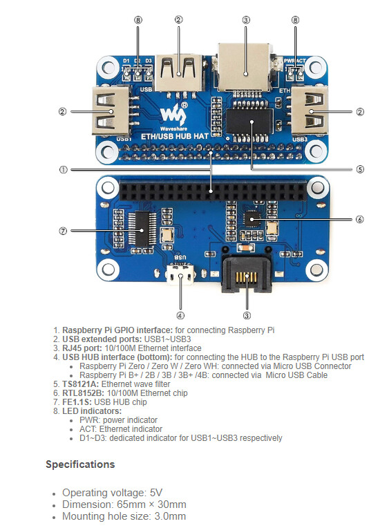

I found it hard to get Pi Zero WH now. Out of stock everywhere.
I found this from Ebay. It has also GPIO and connectivity to Pi via USB.
Does this work as an EmonHub interfacer similar to Zero WH?
borpin
(Brian Orpin)
7
It might, but no guarantee.
Use the emonBase?
