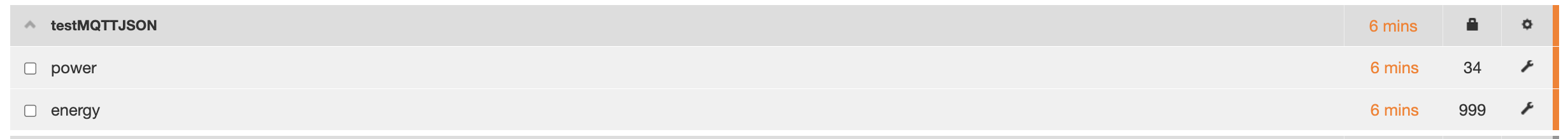

I don’t know if you’re familiar with MQTT tools like mosquitto_pub, which allows sending arbitrary MQTT messages, but here’s an example I just tried and worked fine:
mosquitto_pub -h emonpi.local -u emonpi -P emonpimqtt2016 -t "emon/testMQTTJSON" -m "{\"power\":34,\"energy\":999}"
Decoding that (!), the topic is "emon/testMQTTJSON", and the JSON payload is {"power":34,"energy":999} i.e. it’s a JSON list, with names in quotes and numeric items as straight digits. EmonCMS won’t accept anything else I believe, so any ON/OFF values will have to be converted to 1/0 or similar.
All you need to do is get your data in a JSON format and send it as “Full JSON”.
