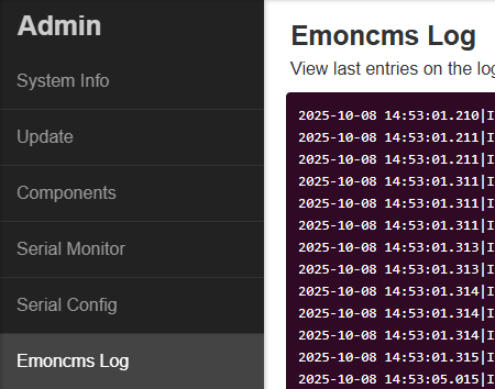

Have you looked at the emoncms logs to see if there is a parse error?
Hi Borpin - i think the forum is doing magic with the input, it should be “” or \[\] - the field “user_calibrated_phase” refers to a user calibration, where a user can select phase A,B,C,N to do a calibration against.
Which log should i look in?
it did it again, [], [<no space>] - trying with preformattted text
Emoncms logs.

Arh, thank you, from the log: (took another device along with it, just to validate my point)
2025-10-08 01:09:50.-320|INFO|emoncms_mqtt.php|MQTT Valid JSON found
2025-10-08 01:09:50.-320|INFO|emoncms_mqtt.php|No time element found in JSON - System time used
2025-10-08 01:09:50.-320|INFO|emoncms_mqtt.php|emon/shellyplus1-10061c79e0d0/status/temperature100 {"id": 100,"tC":25.8, "tF":78.3}
2025-10-08 01:09:53.059|INFO|emoncms_mqtt.php|emon/shellypro3em63-6825ddd1cb9c/status/em0 {"id":0,"a_current":0.226,"a_voltage":225.5,"a_act_power":4.4,"a_aprt_power":50.9,"a_pf":0.09,"a_freq":50.0,"b_current":0.383,"b_voltage":228.4,"b_act_power":13.9,"b_aprt_power":87.5,"b_pf":0.16,"b_freq":50.0,"c_current":0.249,"c_voltage":227.8,"c_act_power":3.3,"c_aprt_power":56.8,"c_pf":0.05,"c_freq":50.0,"n_current":null,"total_current":0.859,"total_act_power":21.544,"total_aprt_power":195.270, "user_calibrated_phase":[]}
2025-10-08 01:10:01.136|INFO|emoncms_mqtt.php|MQTT Valid JSON found
2025-10-08 01:10:01.136|INFO|emoncms_mqtt.php|No time element found in JSON - System time used
2025-10-08 01:10:01.136|INFO|emoncms_mqtt.php|emon/shellypro3em63-6825ddd1cb9c/status/emdata0 {"id":0,"a_total_act_energy":85300.06,"a_total_act_ret_energy":3.79,"b_total_act_energy":93716.95,"b_total_act_ret_energy":2.67,"c_total_act_energy":79071.95,"c_total_act_ret_energy":1.77,"total_act":258088.95, "total_act_ret":8.23}
2025-10-08 01:10:09.056|INFO|emoncms_mqtt.php|emon/shellypro3em63-6825ddd1cb9c/status/em0 {"id":0,"a_current":0.226,"a_voltage":225.5,"a_act_power":4.5,"a_aprt_power":51.0,"a_pf":0.09,"a_freq":50.0,"b_current":0.384,"b_voltage":228.3,"b_act_power":13.9,"b_aprt_power":87.6,"b_pf":0.16,"b_freq":50.0,"c_current":0.249,"c_voltage":227.8,"c_act_power":3.4,"c_aprt_power":56.8,"c_pf":0.06,"c_freq":50.0,"n_current":null,"total_current":0.859,"total_act_power":21.789,"total_aprt_power":195.367, "user_calibrated_phase":[]}
It appears, as its not recognized as a valid json input, but JSON lint, thinks it is. For some reason i am not able to calibrate the device, to see if the last element contained some data, it would recognize it as valid.
emoncms_mqtt.php seems to be the code running the analyze function, and based on some logging in the file, my guess is that $jsondata = json_decode($value,true,2) - is either NOT json_last_error() = JSON_ERROR_NONE or is_array($jsondata) is false.
i will debug this shortly.
thanks for pointing the direction.
arh, there in lies the “problem” - bumping 2 to 3, makes php print the array.

I’ve change this to:
json_decode($value,true,3)
and rebooted the system - now i can see the values properly in input under each device. but could there be a reason to why its set to 2?
The parameter you have changed is the depth the decoding goes to. Because you had a value as an empty array, that is why it failed.
You must be running an old version. This was fixed in 2022.
