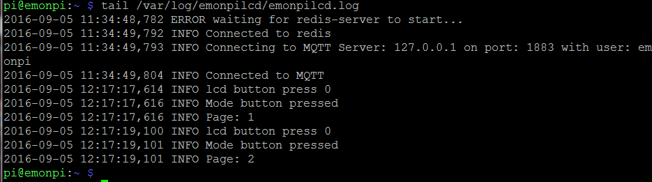

my emonpi LCD displays "ERROR: MQTT not connected "
and logging processes has been stopped locally and remotely since this message appeared .
this is what I have tired
Oh dear, sorry to hear. Thanks for the logfiles.
It looks like the LCD script is connected to MQTT, at least this is what the log files reports.
Could you try restarting the Emoncms MQTT input script:
$ sudo service mqtt_input restart
Was the system working ok before this issue occurred? Did anything change prior to this issue? Is this a new system you are setting up
