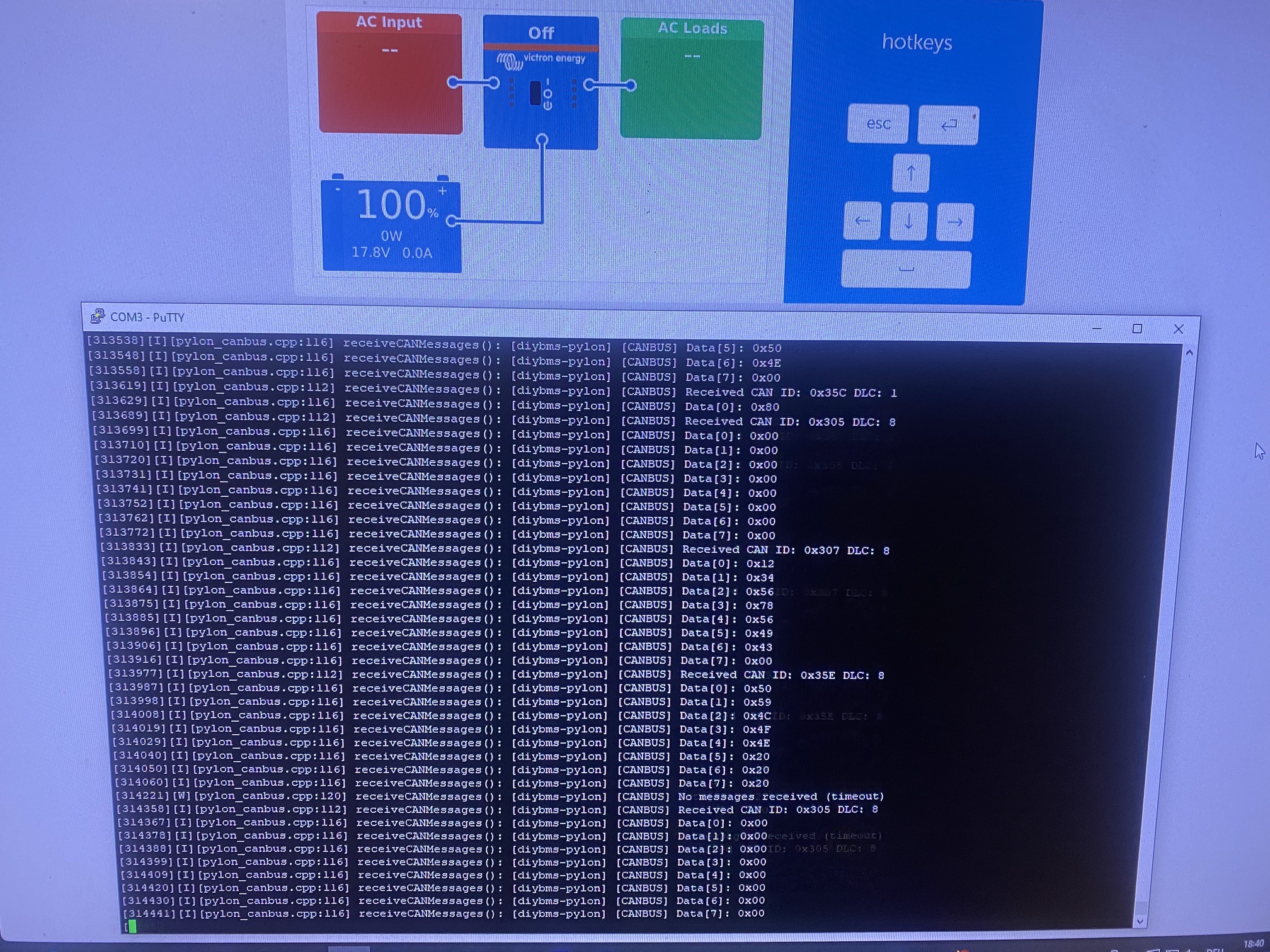

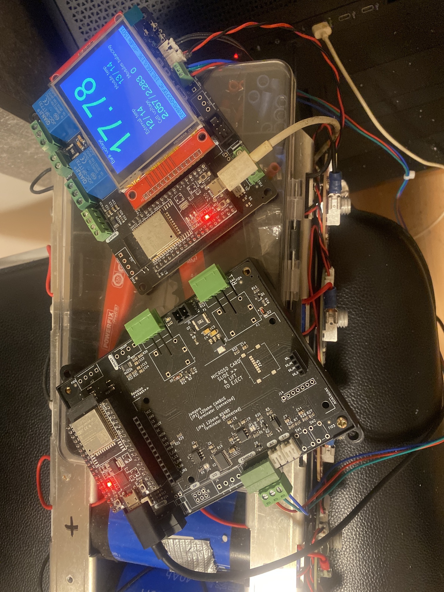

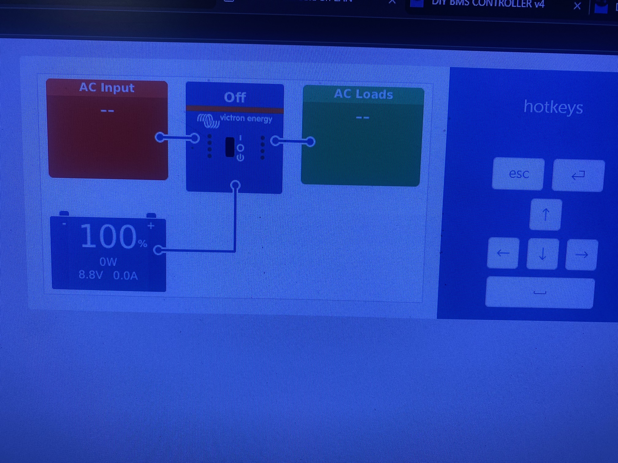

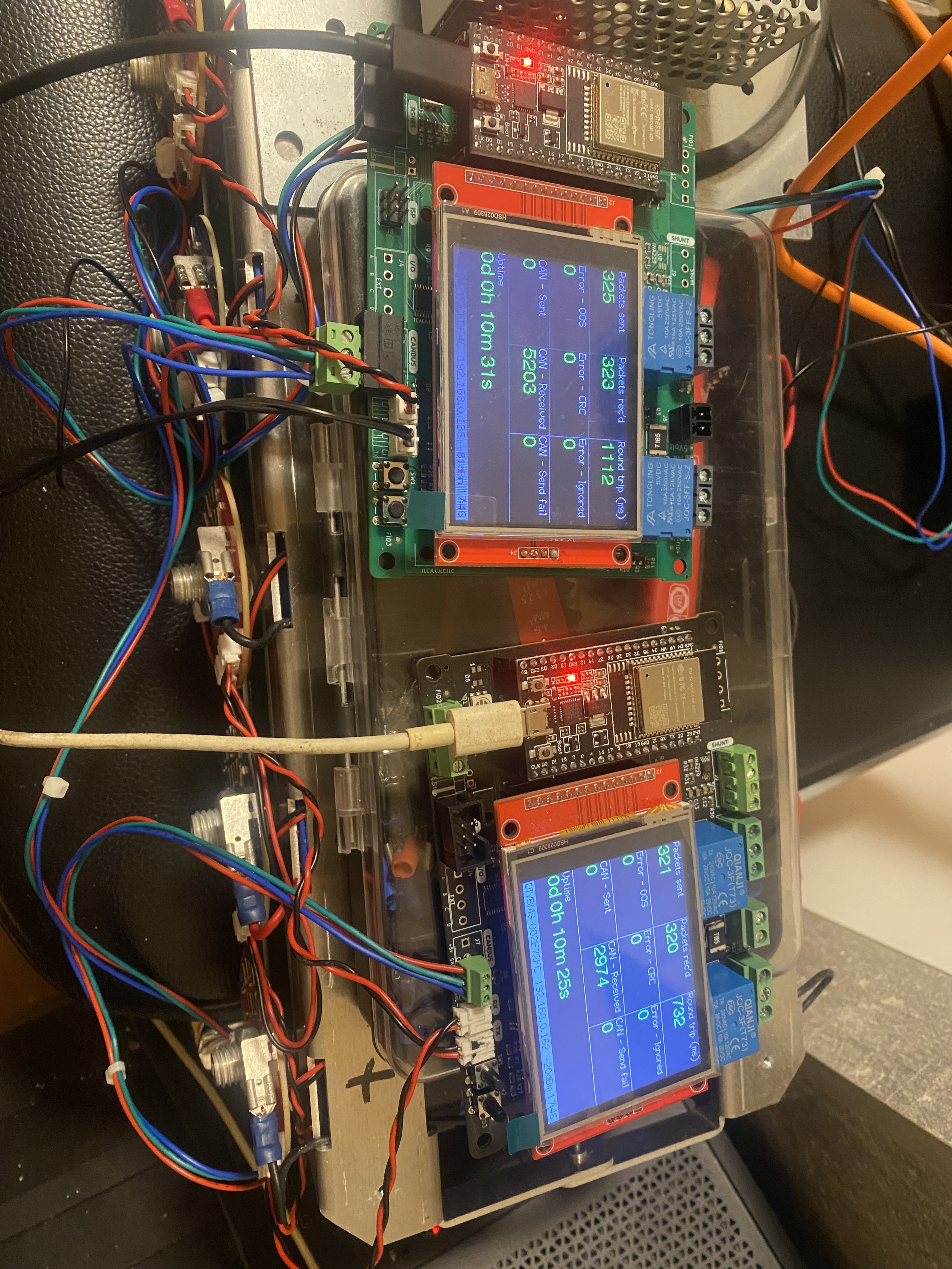

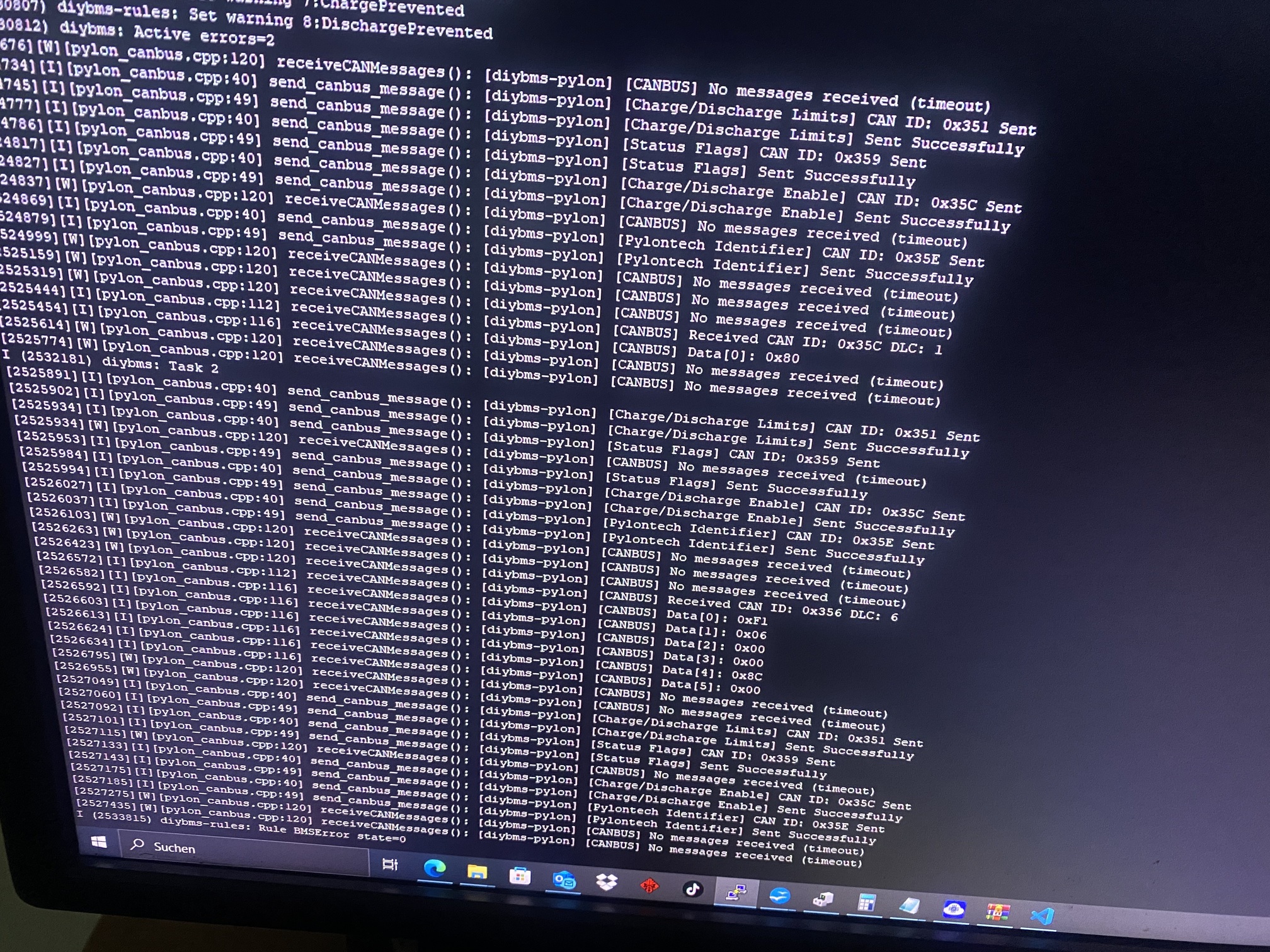

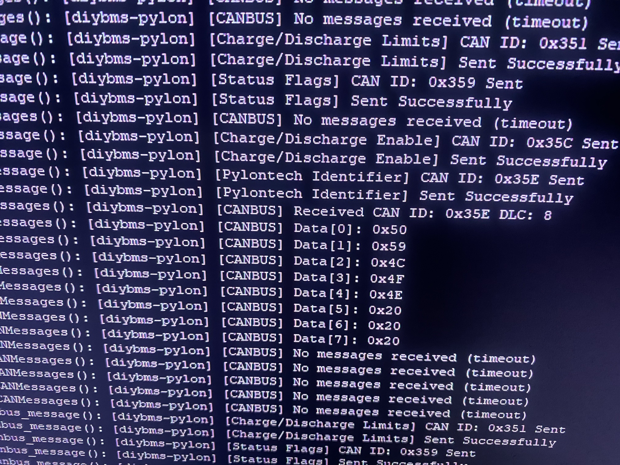

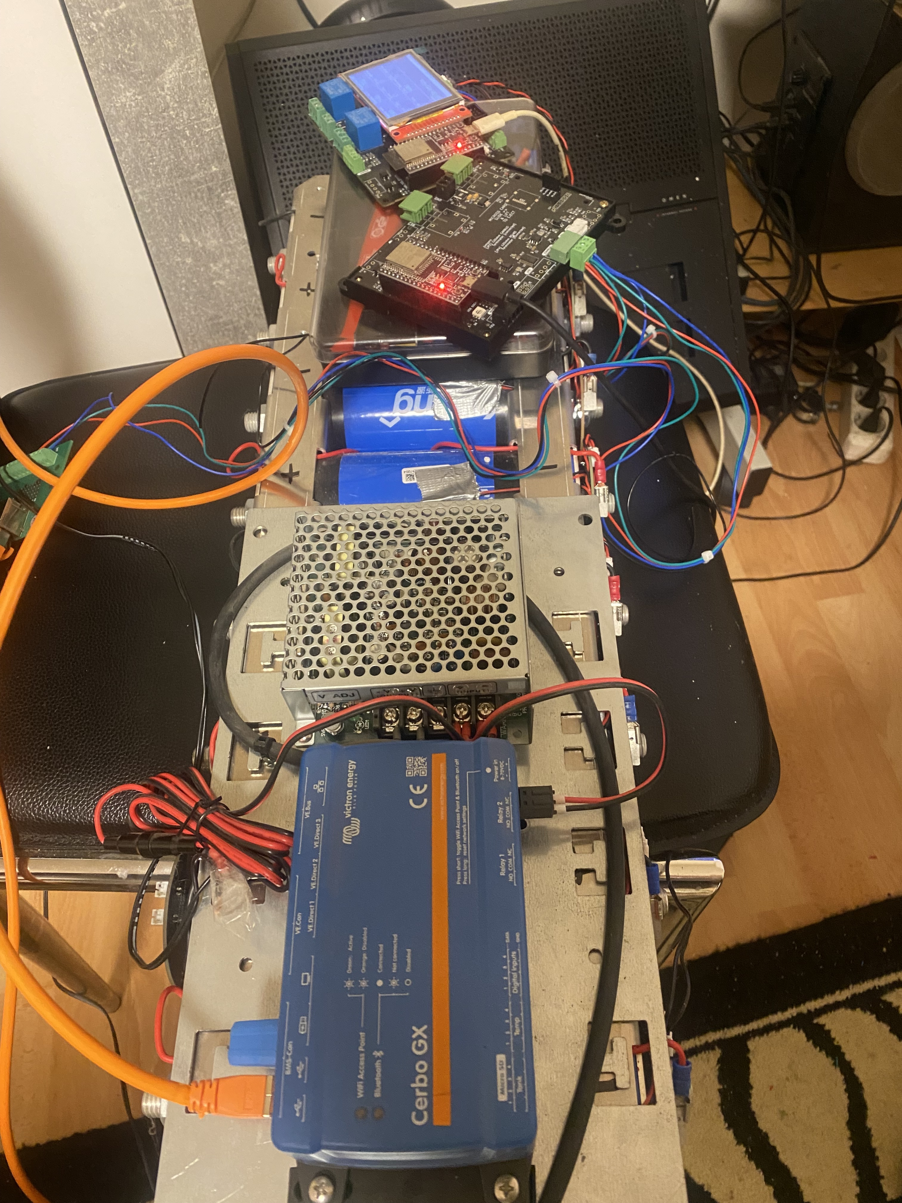

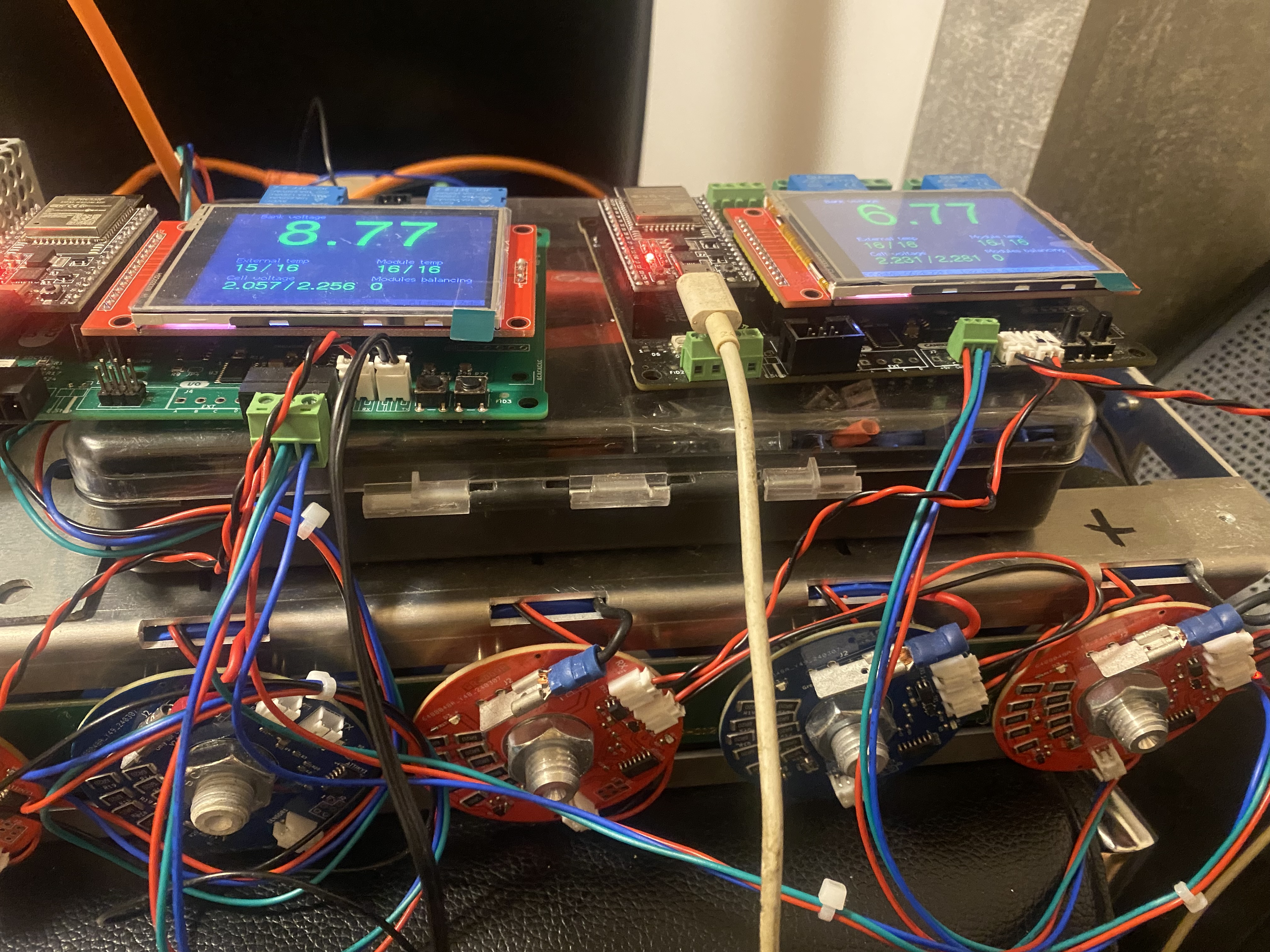

Master Slave diyBMS communication over CanBus
Hello Goran, what you have done looks very interesting. I will try to test it, I am still missing controller boards.
Have you already tested it in productive mode?
For the others, have a look at the Info.txt file. Everything is well written in there.
Thank you for your commitment!
Only tested on the test station, not fully tested.
This upgrade only for testing
Important:
.) The shunt must be used on the Master DiyBMS controller. First controller power on and automatically is this the Master all another controller are automatically slave you can max use 10 diyBMS connect all controller over Canbus cable with CerboGX
.) The Master controller is the first controller you power on.
.) All controllers can be Master or Slave automatically based on battery values.
.) The shunt must be in the Master controller, as this controller collects data from Slave controllers and sends it to the Cerbo GX.

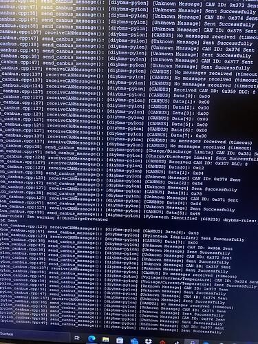

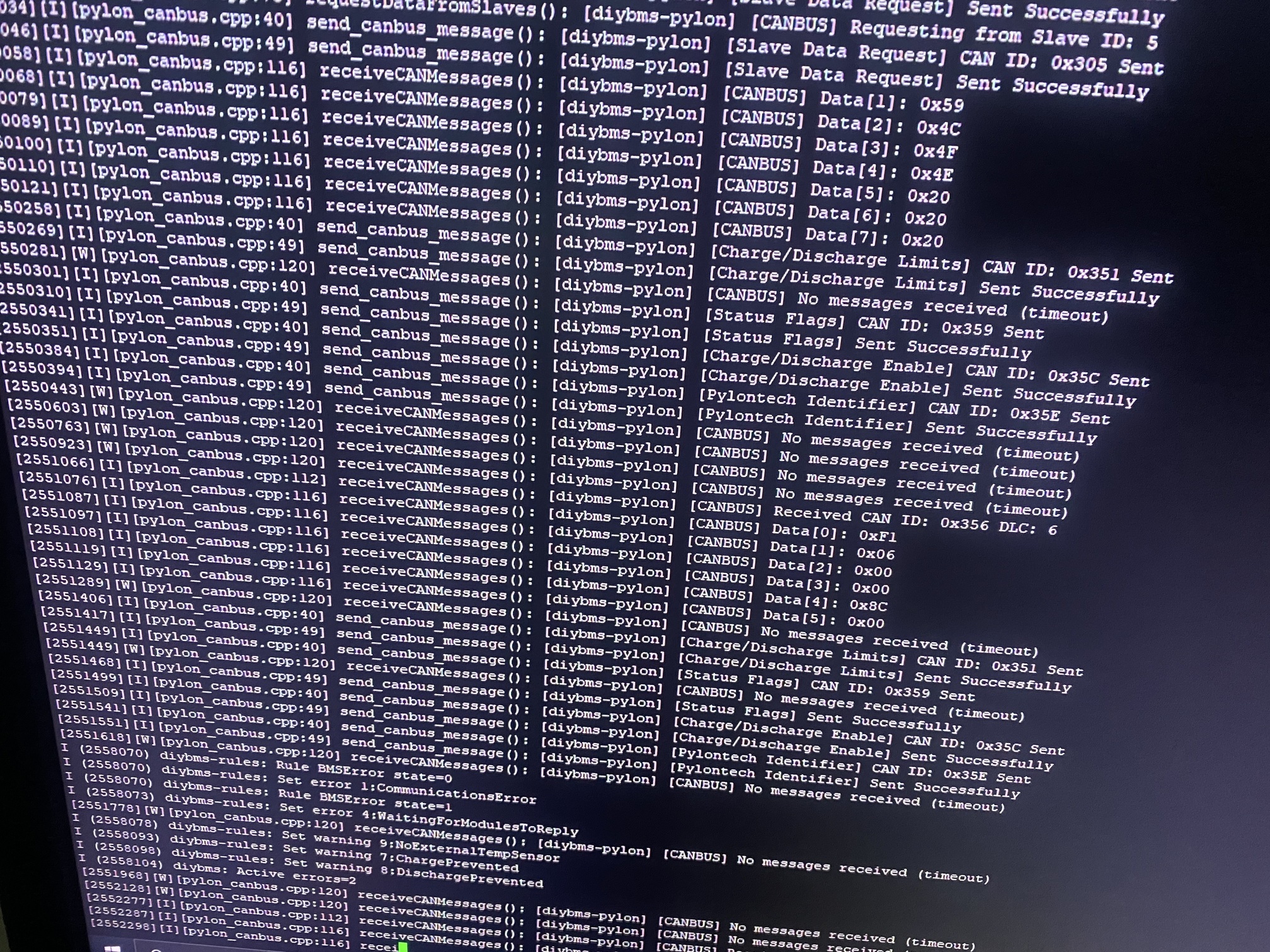

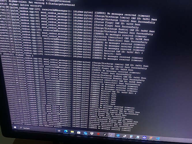

I have implemented new protection functions.
After testing in production, I will post it here.
