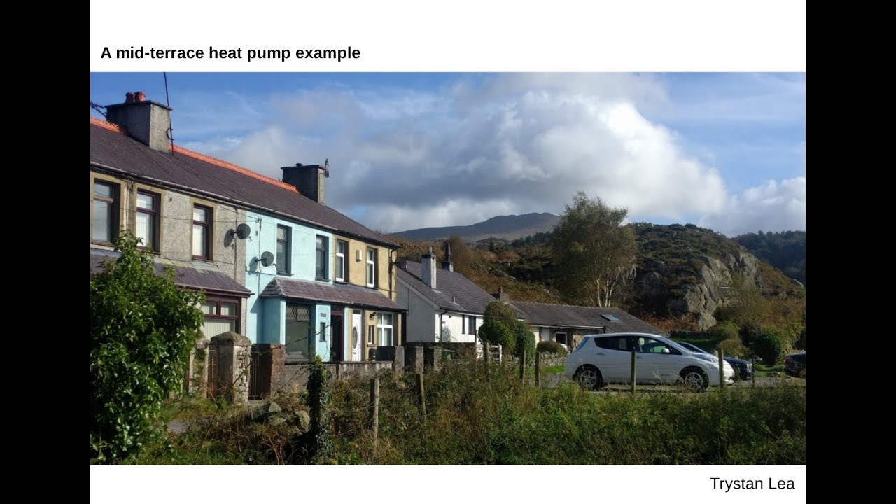

This is what the heat pump looks like at the back of the house, the house is a mid-terrace stone house without much insulation (see the blog posts for details on this):

The system is configured as a single open circuit with all TRV’s fully open, the radiators have been carefully designed to provide the right temperature in each room and it’s a small house with all rooms in use and so is a configuration that makes sense in our context.
There is no low loss header or buffer which removes the efficiency penalty that can result from water mixing in the buffer as well as reducing the number of pumps required to just the one pump. The Wilo pico central heating pump is also a low energy pump, consuming only about 11W when running.
