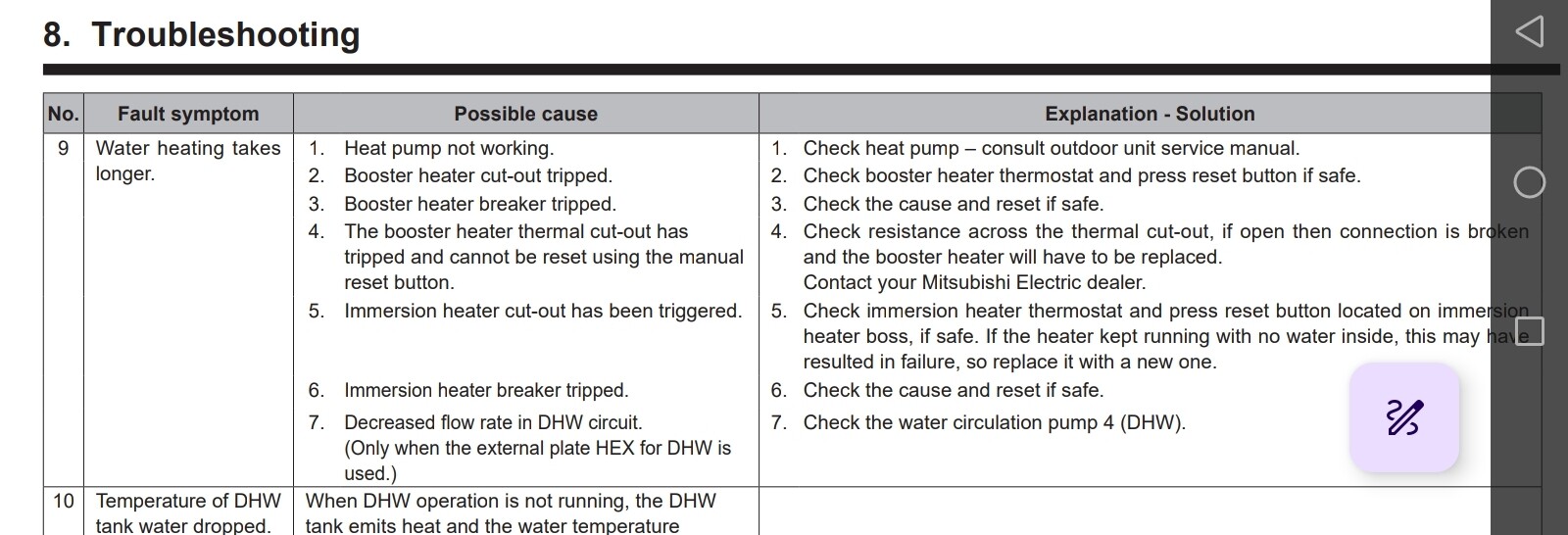

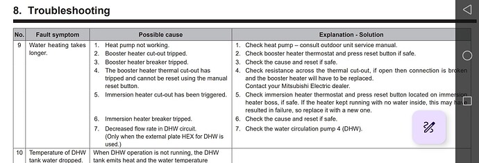

I started seeing the same. Legionella cycle is running for 2-3 hours with temp not going above 50. I had to reset heat pump and remove legionella cycle from schedule completely. I guess for some time it is ok, but this option is for a reason so should get this working again sooner or later. When you say your reset button popped what do you mean. Do you mean fuse ? I see fuse is ok. I have attached pictures.
Did you manage to figure it out… My booster heater also not activating on legionela. It is waiting for it for 3 hours to activate but nothing is happening. HeatPump gets water to 50c, but when it needs to get from 50-65 with booster heater, nothing is happening…. Is this a software glitch ?
Hi Darko, welcome to the forum!
More likely to be a hardware glitch. Check the troubleshooting section of the manual or ask an engineer to come check it.
or Just turn it on, in the picture above it’s switched off ?
