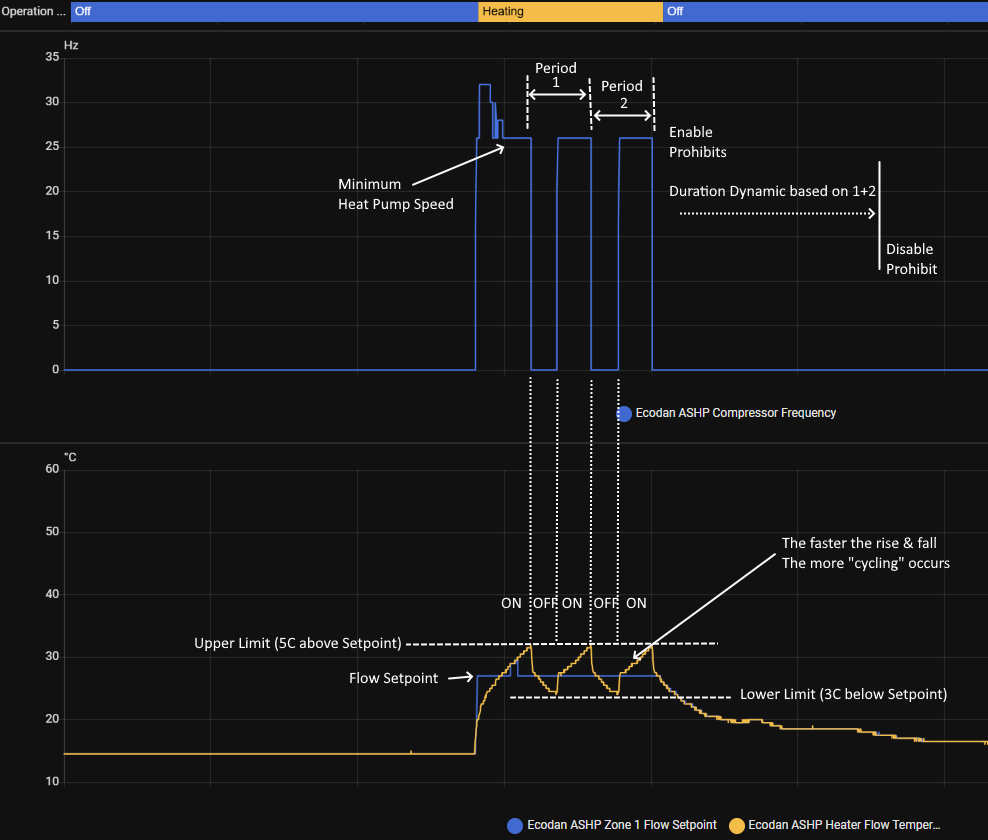

I am additionally adding Short Cycle detect & protect to my project & devices, for Beta testing as part of Active Control Feature 1.
With simple On/Off control it has been designed to use dynamic duration calculation - monitoring the Stop to Stop period of recent cycles to determine a prohibit duration.

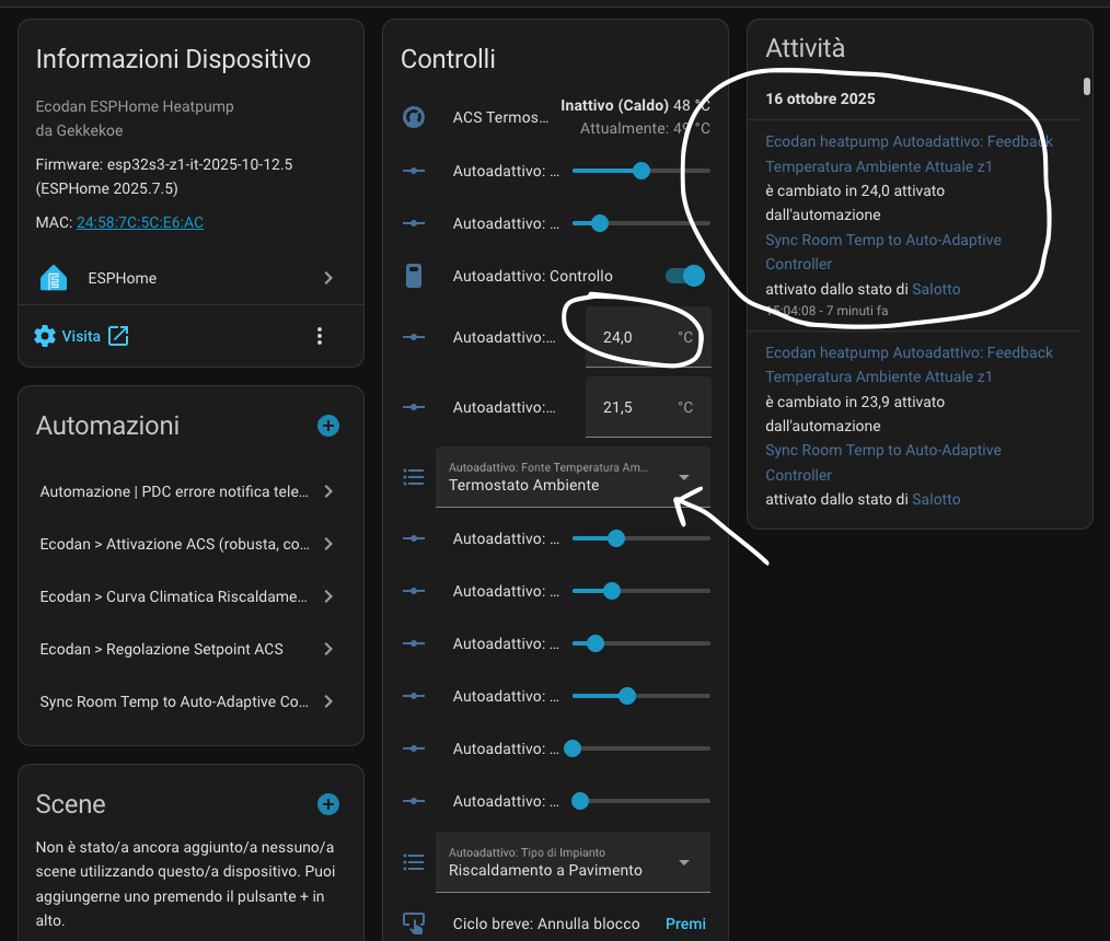

But can I use the climate.smarther entity fot both the setpoint and current temp? Looks like the setpoint must be a sensor entity only
yes, setpoint can be sycned also. did you read the getting started section ? It is explained there
It’s explained as climate trigger, but you can trigger from everywhere.
so define on state change of your smarter entity and sync towards the esp. The smarter entity probably has attributes for current and setpoint
Yes I did. I think I finally made it. On the screenshot is everything set up correctly? Looks like the automation is taking the current temp. from the Smarther so it’s correct. I’ve no clue if also the other automation is getting the setpoint from the Smarther.
Apart this last one everything should be set up correctly or there’s something else to be done?
FTC6 set to fixed temp. (doesn’t matter how much if I understood well).
you need to select HA / REST api (arrow in your screenshot)
else it will not use it. I did a small write up about how it performed last week: Using Auto Adaptive (tips/tricks/feedback) · gekkekoe/esphome-ecodan-hp · Discussion #194 · GitHub
Cool so everything is fine. You basically have the same setting I normally use :slight_smile: I will start monitoring how it works in 2-3 weeks I believe as temp outside is still on 18+°C during the day and not under 10° at night while in the house I have 24.5° during the day and 23.5° at night. Then I will comment on Github
you might want to use the dashboard to control it, much easier. If you follow the getting started and have set the temp feed back (step 2+3) then it should be ready to go.
Super many thanks! I’ve added the dash. I put it here the code for the italian folks with all the corrected entities trsnlated.

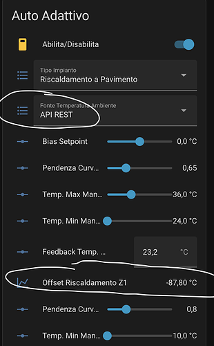

2 things I noted:
  1. I just have Thermostat or API REST but not HOME ASSISTANT/API REST. Is it just a display issue or is it affecting the logic?
  2. what’s happening on the z1 heating curve reading? I got crazy values!
Hereunder the italian entities dashboard.
dashboard.txt (8.5 KB)
API REST is probably translation error on my side, you can ignore it for now I will correct it.
If you have underfloor heating, then the slope of 0.65 is too high, use something like 0.1-0.3
probably wrong feed back, thats not right. flash this pre-release it has safe limits:
For the offset to fail like this, I think you are sending it invalid data, can you plot the feedback temp graph ? You did do step 2+3 right ? (current temp and setpoint feedback?). It might have something to do with the comma or point for decimal. If you have some logging what it send it would be very helpful.
(settings > automations, find the automation, and select 3 dots, show traces, you should able to find what it did)
