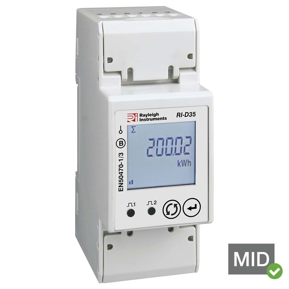

Finally getting around to installing my heatpump monitor.
The Kit comes with a SDM120
The current meter I have is a Rayleigh RI-D35. Which appears to provide RS485 and 2 types of pulse output.
Just wondering if it is possible to to this meter ? (no idea how to wire it in as it provides 6 termainls as opposed to 3 like the 120.
Not a bit issue, I can just install the 120 if needed.

Difficult to tell, but it does say there is a Modbus version, so it should be possible to read that.
Actually, this is pretty clear.

It’s pins 4and 5, both readers are available from the shop mbus and modbus.
The Rayleigh RI-D35 Modbus meter is now supported by Emonhub
https://docs.openenergymonitor.org/emonhub/emonhub-interfacers.html#rayleigh-ri-d35-100
Example config:
[[modbus]]
[[[init_settings]]]
device = /dev/ttyUSB0
baud = 9600
[[[runtimesettings]]]
pubchannels = ToEmonCMS,
read_interval = 10
nodename = electricity
# prefix = sdm_
[[[[meters]]]]
[[[[[ri-d35-100]]]]]
address = 1
registers = 3,5,15,19,23,21,27
names = EI,EE,P,VA,I,V,FR,PF
precision = 1,1,1,2,2,1,2
scales = 1,1,1000,1,1,1,1
