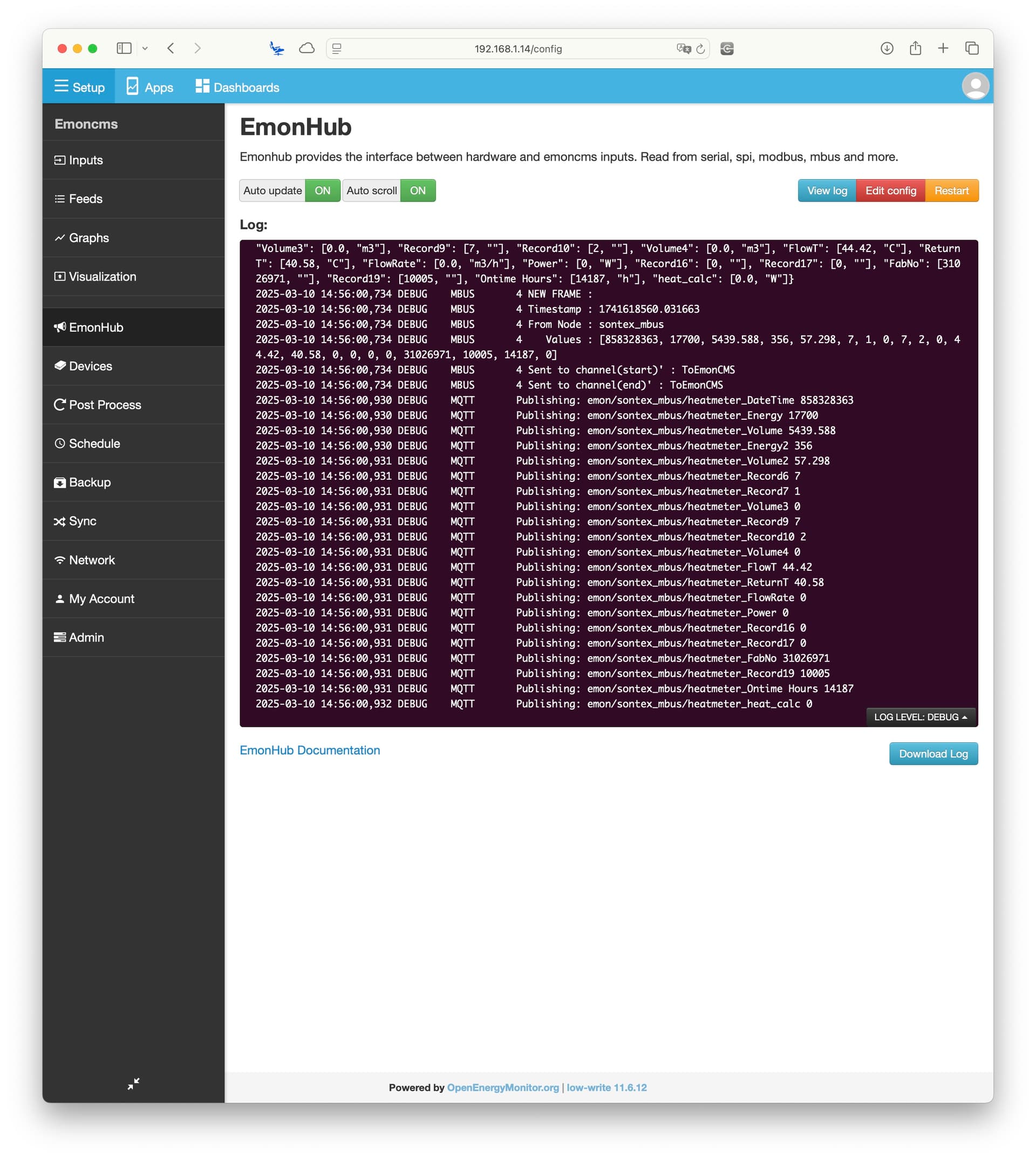

I can see the logs in /var/log/emonhub/emonhub.log just fine and I’ve copy pasted across my config into /etc/emonhub/emonhub.conf. Config below for reference.
Both USB devices are unchanged between the two emoncms installations, and both can be seen in lsusb or ls -al /dev/serial/by-id/ ... etc
Strangely however, whereas I’m able to see the data fine from the older install, on the newer one, I’m getting connection errors. The OS is the same, the LXC setup is the same, both are running the latest version of emoncms etc, and both use the same serial Modbus and MBUS USB devices connected to the same ports (obviously - I only have one LXC running at once.)
Errors below the config. I’m generally missing something obvious - could anyone point me in the right direction please?

➜ ~ tail -f /var/log/emonhub/emonhub.log
2025-03-10 12:05:50,059 ERROR SDM120 Could not connect to Modbus device
2025-03-10 12:05:50,059 DEBUG MBUS Connecting to MBUS serial: /dev/serial/by-id/usb-Prolific_Technology_Inc._USB-Serial_Controller_DLASb118D16-if00-port0 2400
2025-03-10 12:05:50,059 ERROR MBUS Could not connect to MBUS serial
2025-03-10 12:05:50,059 ERROR MBUS Could not write to MBUS serial port
2025-03-10 12:05:50,059 ERROR MBUS read_data_frame could not read from serial port
2025-03-10 12:05:50,059 DEBUG MBUS Invalid MBUS data received 0 bytes 0.0 ms, count: 7
2025-03-10 12:05:50,260 ERROR MBUS Could not write to MBUS serial port
2025-03-10 12:05:50,260 ERROR MBUS read_data_frame could not read from serial port
2025-03-10 12:05:50,260 DEBUG MBUS Invalid MBUS data received 0 bytes 0.0 ms, count: 8
2025-03-10 12:05:50,460 DEBUG MBUS Decoded MBUS data: None
2025-03-10 12:06:00,079 ERROR SDM120 Not connected to modbus device
