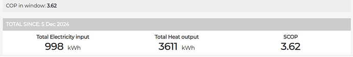

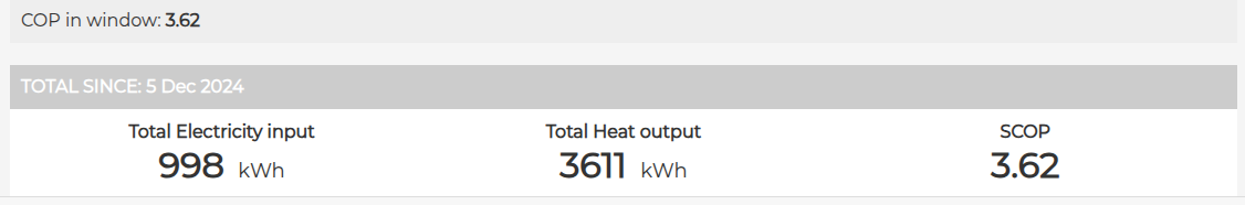

Hello I’m new to this forum. I’ve been assessing local Emomcms data on my PC since 05/12/2024 for my system. Locally I can view all the data whereas on Heatpumpmonito.org it only shows 10 days worth. I’ve manually reloaded system data from Emoncms dashboard to no avail. Please advise.
I enclose a screen shot
My_Systems
Further to my original post, I think I’ve resolved this by changing the heatpump read key to the one on the side of the rasperry pi. I still find this all a bit confusing though, how did it get changed?

I’m afraid I can’t answer you directly because I don’t have a heat pump, and I know nothing about the workings of Heatpumpmonitor.org. However, what I can add which might go some way to explaining what’s going on is your local emonCMS running on your Raspberry Pi (the major part of your Heatpump Monitor) is totally separate from the on-line emonCMS, so each has has their own user account, password, read API key and read+write APIkey.

Data has now been reloaded and the correct figure of 263 days is now showing: https://heatpumpmonitor.org/system/view?id=516
