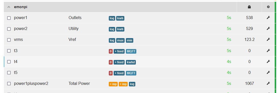

Power outage fragged original SD card running 10.5.6 on RPi 2. Replaced unit with RPi3B+ and latest SD image. Restored backup from a few months ago along with node-red stuff. After fixing feed IDs, everything is working now, except the Home Electric app screen. The power1, power2,
and power1pluspower2 inputs are all showing valid units.
Power1 and power2 feeds are correct, but the power1power2 feed is exactly double p1+p2.
MQTT export is showing up correct as well.

Hello @jvhutchisonjr
It looks like you are adding these inputs together a second time in your input processing, you only need the log to feed process there as this sum is performed on the emonpi itself.
That fixed it, thank you.
