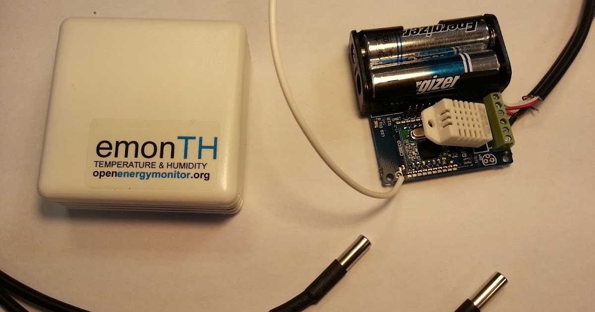

Then if I want to install more temp. sensors remotely I can using this:
and indeed if I want to connect multiple ds18b20s to a emonTH then I can by following this:
