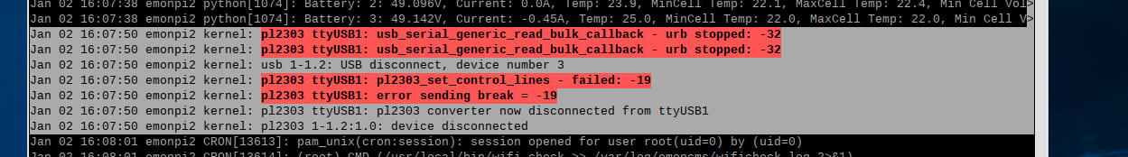

Is this a new MBUS USB adapter? The problem is at the hardware level where Python is trying to write to the serial port and fails.
Open a separate thread for this.
Yes it’s a new adapter. Are you saying I need to get a new one? Restarting Emonhub makes it work again which seems odd?
Possibly. There are other threads re trouble with USB adapters - not all are built the same. Was this a Shop one (not even sure if OEM do sell these).
Not really. As I say, it is probably a hardware & driver issue, restarting emonhub resets the driver. The code that is failing is not emonhub code, but core Python code so the exception isn’t the ‘fault’ of emonhub.
I also not you are running it on a laptop - again that may be a factor for the underlying Python code interacting with the system driver.

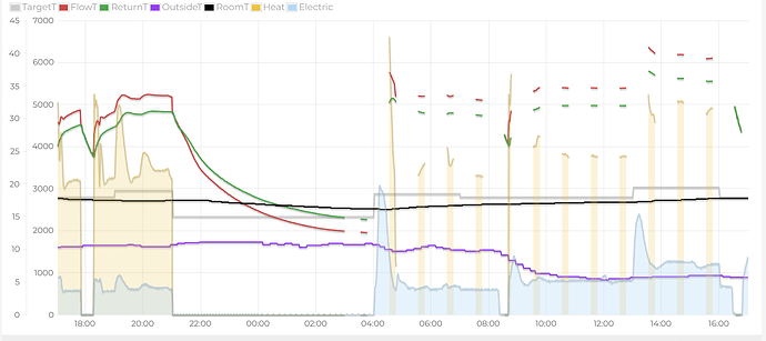

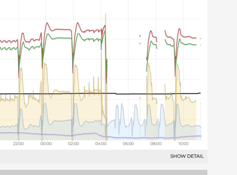

I am having the same issues with the meter readings dropping out.
I am running OEM on a Pi4 with a danfoss sonometer 30 heat meter connected via mbus to usb adapter bought from the OEM website. In line with the @MBC 's issues, restarting appears to solve the issue temporarily, then it becomes sporadic meter readings and then it drops out all together. @borpin when you say core python code, do you mean within the adapter itself? Is this therefore not rectifiable? Anyone else had and resolved this issue?
It’s been a while now but as far as i recall the problem was with the USB port on my laptop. It has 3 built in but the adapter only stayed working in one of them. I now have a mains powered hub plugged into that one and run both a MBUS and Modbus adapter from that.
The EmonHP comes with remote support so I’d suggest contacting the shop (@Gwil for info).
I’m having the same issue:
My new Axioma E4 heat meter, connected to my heat pump, has been installed and working fine for a few weeks now connected to my emonpi using an OEM-bought MBUS to USB adapter.
Over the last week or so, it has started to randomly drop out and looses the USB connection. The /dev/ttyUSB1 device just disappears, resulting in errors such as this being logged by emonhub:
Unplugging and replugging the USB cable will usually get it going again - for maybe a few seconds, or hours.
It seems like the MBUS/USB converter is faulty.
It can be more reliable to use the /dev/serial/by-id/ address.
Try the following via SSH:
ls -lh /dev/serial/by-id/

journalctl reports the following:
As you can see from my published heat pump ( HeatpumpMonitor.org ) it has been working perfectly since Nov 21 - and suddenly stopped on Dec 23rd - and has stopped a few times sporadically since. Nothing has changed as far as I know to cause this. No software updates have been applied.
My Pylontech battery monitor - another USB serial device on /dev/ttyUSB0 - has worked flawlessly this entire time.
Thanks @Martin_Robinson as a last thing to try, could you try another USB cable? if that makes no difference please email the shop and we will arrange a replacement.
@TrystanLea Well, it’s been several days after changing to another USB cable, and there have been no further issues! Seems like you hit the nail on the head - good shout!
