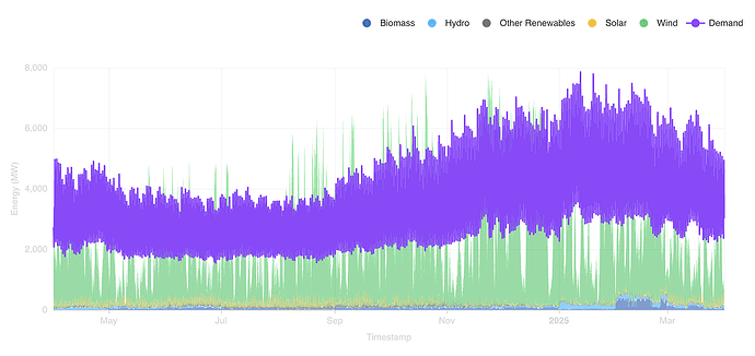

Here’s how it looks for Octopus over the year ending April 2025, in which they served power that was 69% renewable. The purple line shows the demand (i.e. the energy sold to customers), and the coloured areas show the renewables they buy on our behalf (mostly wind).

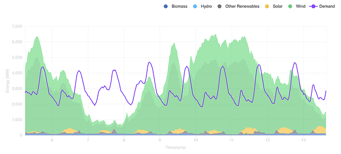

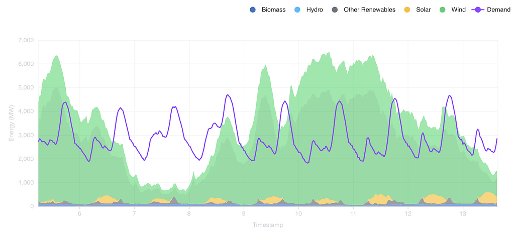

Zooming in, you can see the daily shape of demand, and how it interacts with the intermittency of renewables:

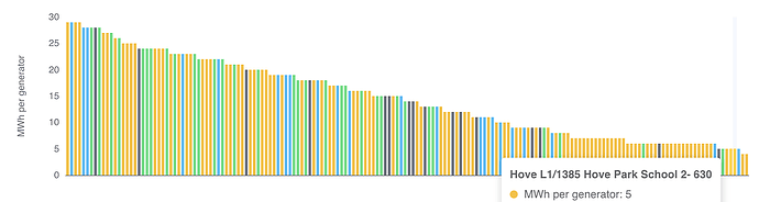

Octopus buys from 1,821 generators - exclusively from 890 of them - including 5 MWh over the course of the year from Hove Park School :school: :sun::

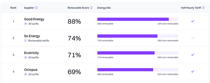

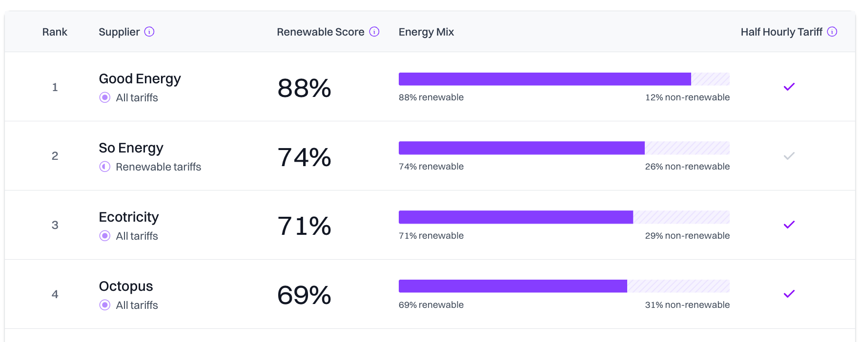

Ecotricity and Good Energy are a lot smaller (1.7 TWh/yr and 0.4 TWh/yr) but do even better. And the trading team at So Energy helped me rate their renewable tariff (0.7 TWh/yr) too, which also comes out well:
You can explore the full results here. There’s been a lot of confusion around “100% renewable” claims because the current system allows winter gas consumption to be offset with summer solar. The approach I’ve taken here works with the same systems - REGOs, half-hourly settlement - but does the accounting properly, half-hour by half-hour, like the power market itself.
