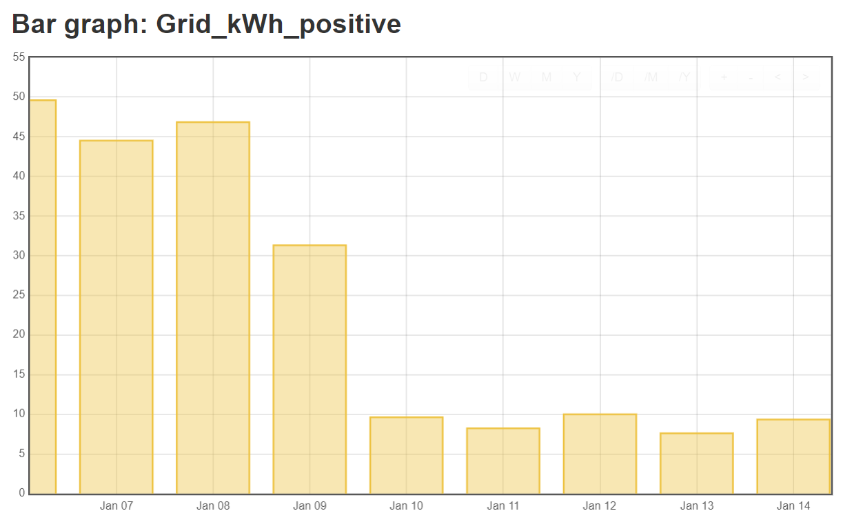

I am currently running version: 10.0.1 on a Raspberry Pi which I installed myself (it’s not emonSD). For quite a few years it has worked mostly very well monitoring my mains usage, DIY solar generation etc.
Back a while some rogue data crept in. On the graphs this manifests itself as one day with a massive spike of positive “usage” and one day with a massive anti-spike of negative “usage”.
Normal days:
Rogue data on graph:
More normal days after the aberration:
I had suffered several power blips on/around the strange days, and I think this was the cause; as you can see it normalised afterwards and has been working fine ever since.
I don’t mind the lost data, really. I can just accept that. But I would like to zap or zero the data on those two days so that when I’m looking at a broad sweep of time, it doesn’t ruin the scale.

The data isn’t stored in the MariaDB database.

Correcting data is more tricky. Have a search on editing the data. The old way via a visulaisation is currently broken (@TrystanLea).

The easiest way to edit at the moment is using the graph CSV export interface to extract a section of data that you would like to edit and then the feeds page CSV import tool to import that data to overwrite the existing data for those timestamps.
