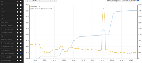

The monitored mains voltage from emonVs various significantly (~226 to ~257V), see yellow trace below), yet the mains voltage measured with a multi meter is around 238-240V, even when the monitored V jumps up to ~250V! This clearly results in incorrect power reading spikes, blue trace. (I appreciate accuracy will be lost when measuring low currents with a 20A CT, as below is monitoring a central heating pump. Note, the emonVs is plugged into a 13A socket.
As can been seen below although it’s not an accurate power measurement, it does show the pump starting to switch on at 5am.
Below shows the main heat pump power and impact of the incorrect high V at time 5.14. i.e. it’s not just a problem associated with monitoring low power.
The high (incorrect) V values can last for several minutes, see below.
