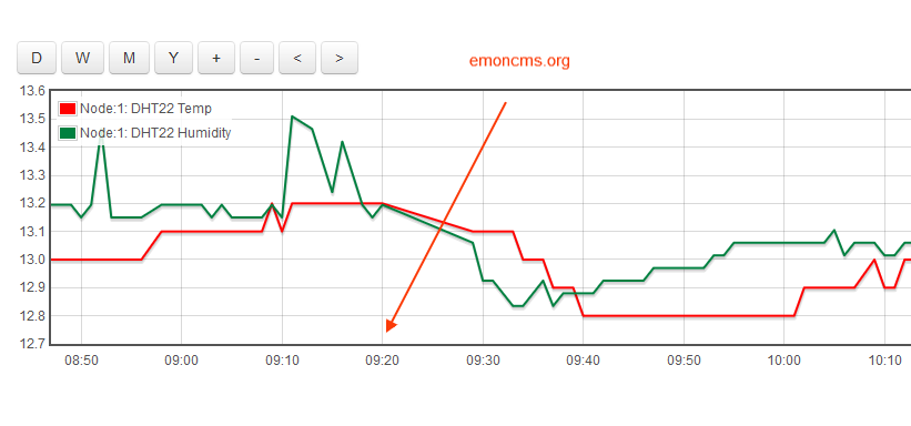

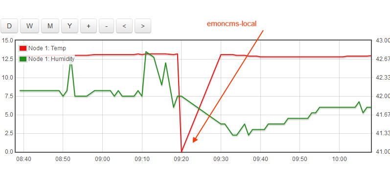

and something else that happened after power loss which upset only the local installation, any ideas?

As for your power loss issue - no idea, it may be that the system collapsed before that final datapoint was sent to emoncms.org.
It’s a unknown situation and we would be just guessing.
