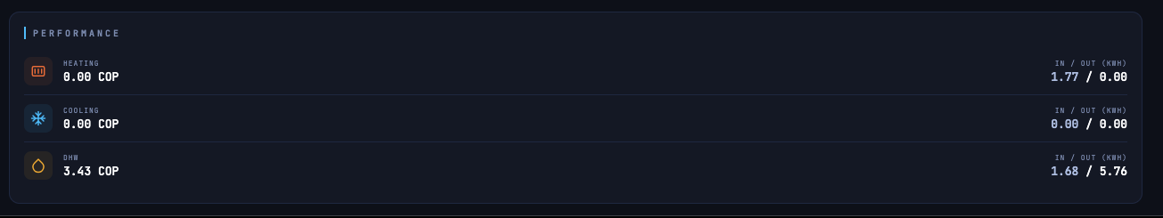

Here is my MELPump report from yesterday and DHW CoP was reported at 4.5 today, which i do think is probably a bit higher than reality:
https://melpump.com/public-report/view/019dc8e1-4e29-714e-b565-b7d160401641

The problem is solved. As many on this forum helpfully suspected, incorrect installation of stock temperature sensors was the issue:
The flow temperature sensor was in the incorrect position, just after the hot water loop coming off, so it was still getting some of the increased temperature when the hot water tank but only part, hence the low readings. The installer visited and has fixed it. Yesterday CoP hot water reading was 4.21.
