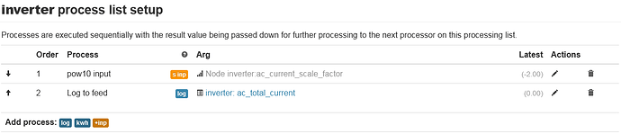

Thank you so much for your help! I’ve had a massive break through (don’t laugh!) when I managed to find a program called WinSCP which connects into the pi and lets me view files and move them to/from the laptop.
Anyway - feeling pleased with myself I’ve added the processext_processlist.php into a new folder and nearly jumped for joy when the process appeared in emoncms for me!
The downside is I can’t make it work…

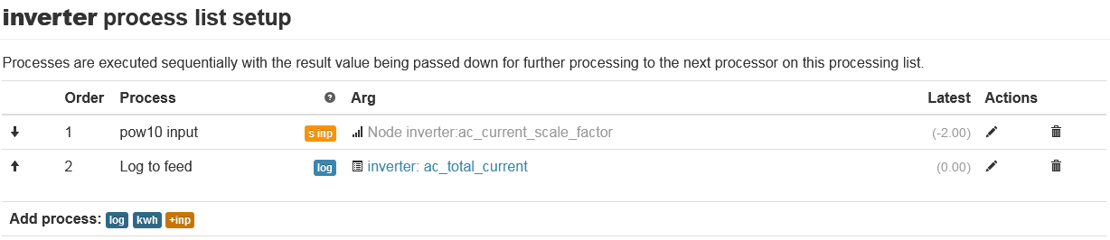

I’ve gone to the ac_total_current input, and added the pow10 input function, and chosen ac_current_scale_factor but the result seems to come out as -2.00 (which is the current scale factor). Adding a log to feed just produces a feed with NULL in the feeds tab. I’ve tried this with a few different ones just to make sure there’s no quirk and it’s producing the same result… So I’m back to feeling stupid again! :thinking:

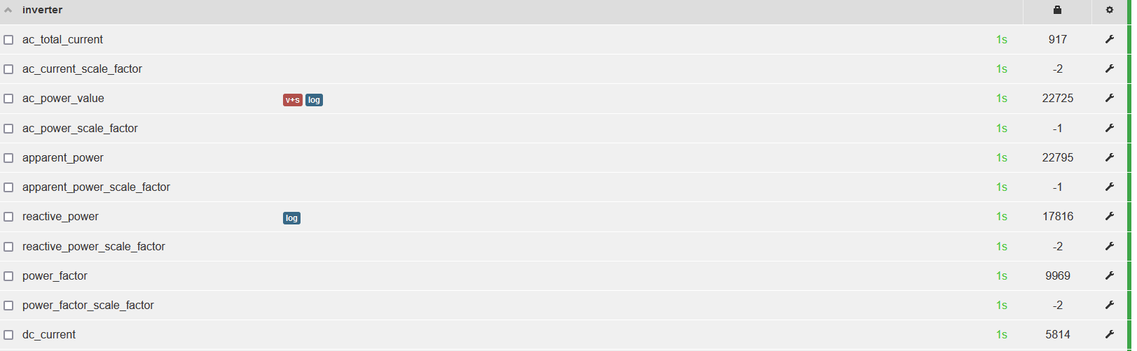

Update! I’ve added the dual-register reading method that Justin came up with for reading the power (as a test for now) and unpacked it with the value and scale process and it’s producing a result that looks correct (for the gloomy day we are having at least!) - 209W currently!
Great to hear that the dual-register approach is working!
Yes. I’m not sure why the power10 function isn’t working - it’s only really needed for reading the AC current - where the current and scale factors aren’t in adjacent registers, and it’s not particularly important to me to read that.
Next job is to move the CT from the solar feed onto the battery so I can monitor the flows there :slightly_smiling_face:
Hi Richard - glad you got it working!
I think before you were applying the power10 function to the scale factor, but also needed to multiply it by the actual value before logging the result.
Using as you have it set up now should give you better results though.
Hmmm… I shall have another look at it. It’d be worth getting it to work as there’s a couple of things with non-adjacent registers (AC Current, Heat sink temp for example). Also - sitting reading the SE spec notes, the ‘lifetime energy’ is available - but that has two registers (I think? It says size is 2 and the type shows acc32) as well as the scale factor.

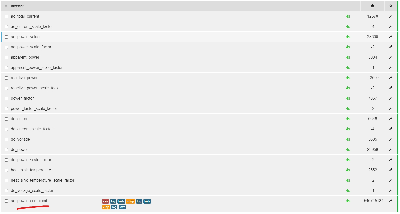

I am now getting data, but need guidance on how to get the corrected values
Hi Don,
first add ac_power_combined to your emonhub.conf, note additional value at end of rName, register, nReg and rType lines:

and a matching node section at the end of the file:
[[27]]
    nodename = inverter
    [[[rx]]]
        names = ac_total_current,ac_current_scale_factor,ac_power_value,ac_power_scale_factor,apparent_power,apparent_power_scale_factor,reactive_power,reactive_power_scale_factor,power_factor,power_factor_scale_factor,dc_current,dc_current_scale_factor,dc_voltage,dc_voltage_scale_factor,dc_power,dc_power_scale_factor,heat_sink_temperature,heat_sink_temperature_scale_factor,ac_power_combined
        datacodes = H,h,h,h,h,h,h,h,h,h,H,h,H,h,h,h,h,h,i
        scales = 1,1,1,1,1,1,1,1,1,1,1,1,1,1,1,1,1,1,1
        units = A,n,W,n,VA,n,VAR,n,%,n,A,n,V,n,W,n,C,n,n
You should see the new input in emoncms:
To unpack the value you need the “value and scale” process from the proccessext module (see installation instructions here: GitHub - emoncms/processext: Additional emoncms input processors)
This is my process list for the solar inverter input:
The first two values calculate and log the current power output of the solar. The 3rd process creates a KwH value, 4-6 adds non-solar input to creates total electricity usage in W and kwH. 7-9 subtract the energy used by our heatpump to give a feed of just electricty used by rest of the house.
