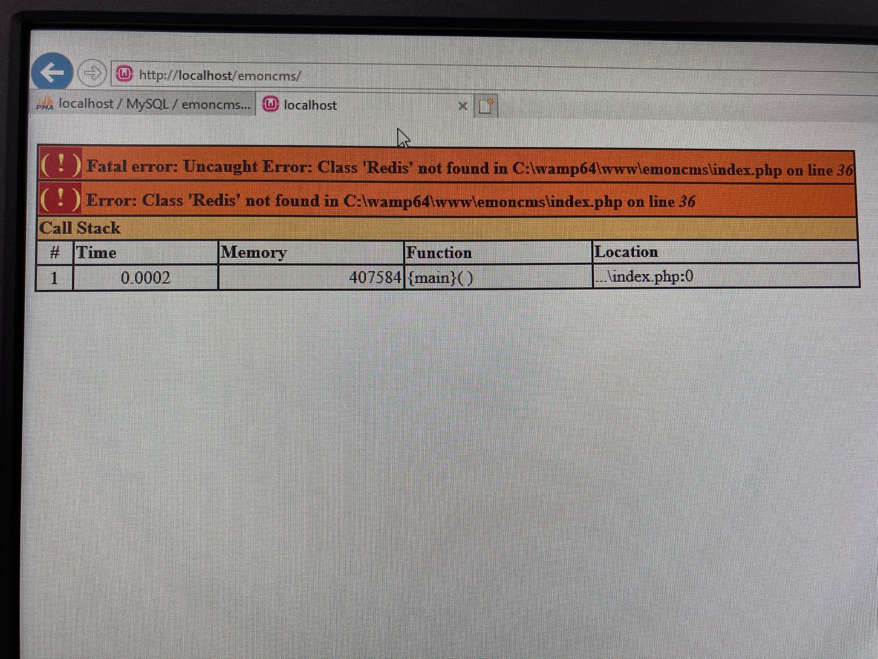

Hi,
I did the initial steps and have got all the files in the database. now i have changed the example.setting.ini file as mentioned in the installation manual and wants to create the user account but i have got the attached error. Please help and thank you
Is the install of emoncms on the Windows 10 machine? If so then there is minimal support here for a WAMP setup - Iā€™m not sure if there is anyone else who still uses it.
Have you installed REDIS? There are 3 parts to it; the server, enabling it in the Web Server and the Python package.
Hi Borpin,
I changed my OS to Linux and currently installing on it.
