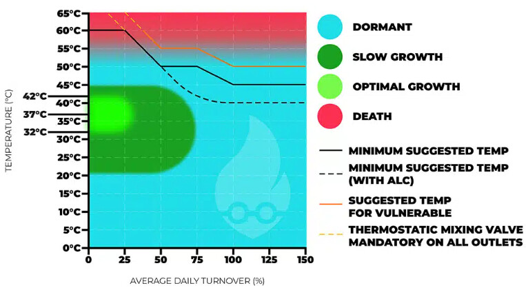

I used this chart from heatgeeks to make my decision, what i liked was the inclusion of % water turn over.
