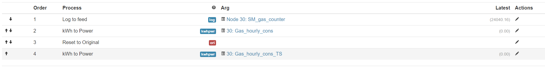

Frank can you post a screen grab of the input processing for that input?
yes sure, here it is:
you can see as instructed by Brian I have tried both engines. Referring to the picture at the top of the post, could it be that the algorithm has a problem with the step increases happening exactly on the hour? Well almost, the increase occurs between 30 and 40 seconds after the hour.

That all looks pretty straight forward, I cannot see why it wouldn’t work. I just took a quick look at the process code and there’s nothing particularly odd
Try doing the maths of the process with some real values, it looks like it’s flying close to the limits of a float in PHP as IIRC when we last checked it was accurate to 7 digits, 3600000.0 is 7 digits. It will depend on the update interval too small increase and long interval could get rounded down to zero perhaps?
If you’re familiar with redis-cli you can check the content of process:kwhtopower:$feedid from the command line between updates.
