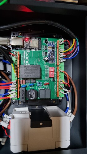

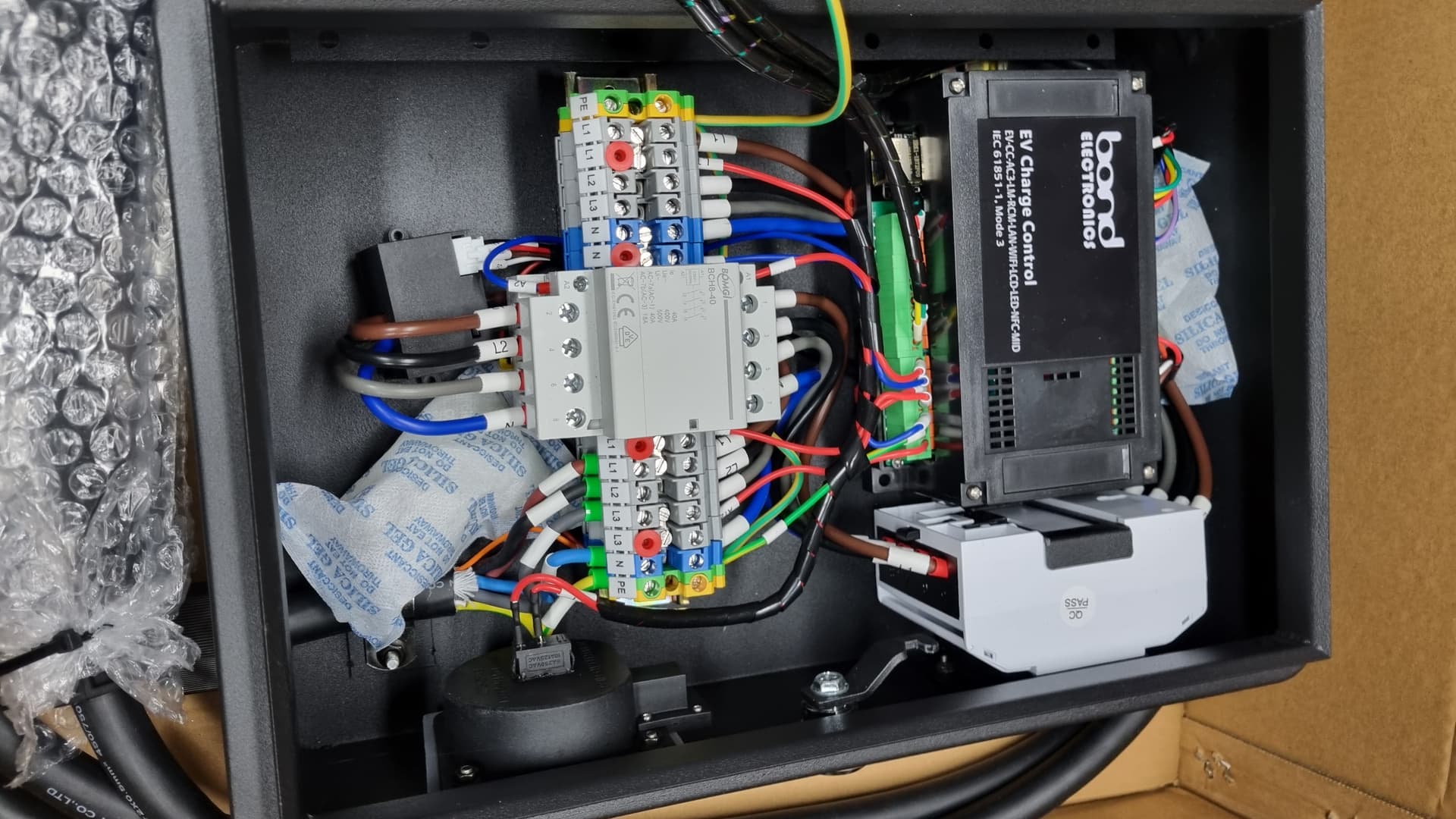

there was a german Company (Kinetos), which took the 3 Boards
(Mainboard , WIFI WT32, Power) on one circuitboard and produced it in China. The company is insolvent and nobody can help with it.

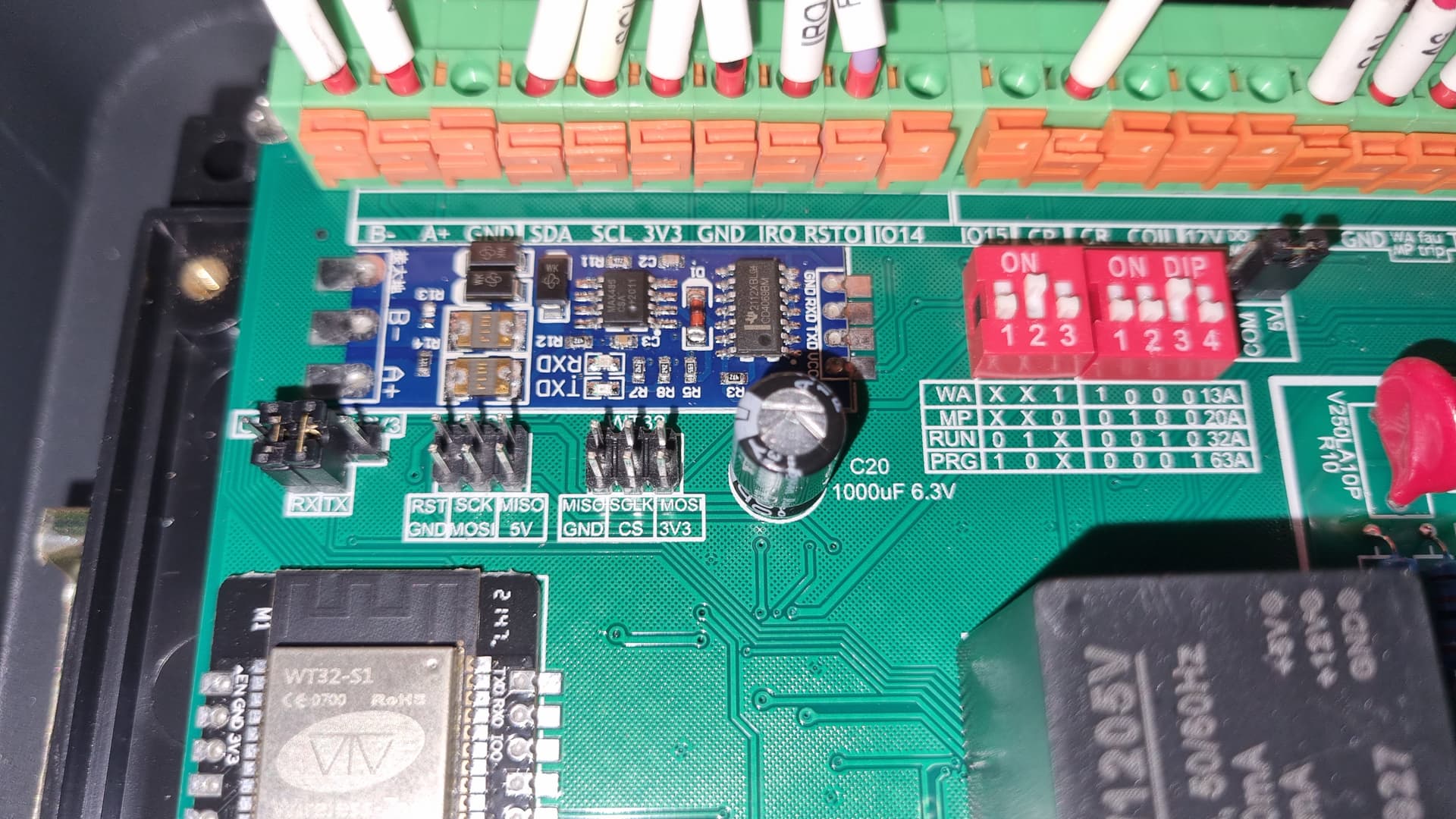

Now i have Problems with the Firmware on some Boxes and want to reflash it with original openEVSE Package.
As you can see in the pictures there are a few jumper pins for Programming and resetting.
Can anyone tell me or advise me how to use the Programmer?
I havn’t ordered it yet because i dont kow how to connect an use it correctly.
Is it easily working together after flashing or do i need thousends of hours and commands to get WIFI, RFID and Display working?
Or is it so special with these dip switches and so on, that an special programmed firmware is needed?
Maybe you have any ideas for my Problem.

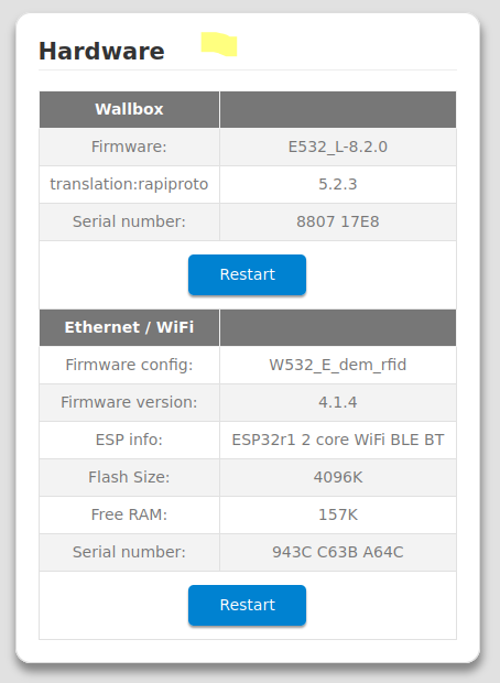

Not sure if it helps, but here is a picture with the current firmware of my box etc.
Maybe some of the more experienced can make sense of it.
Thanks,
PNT

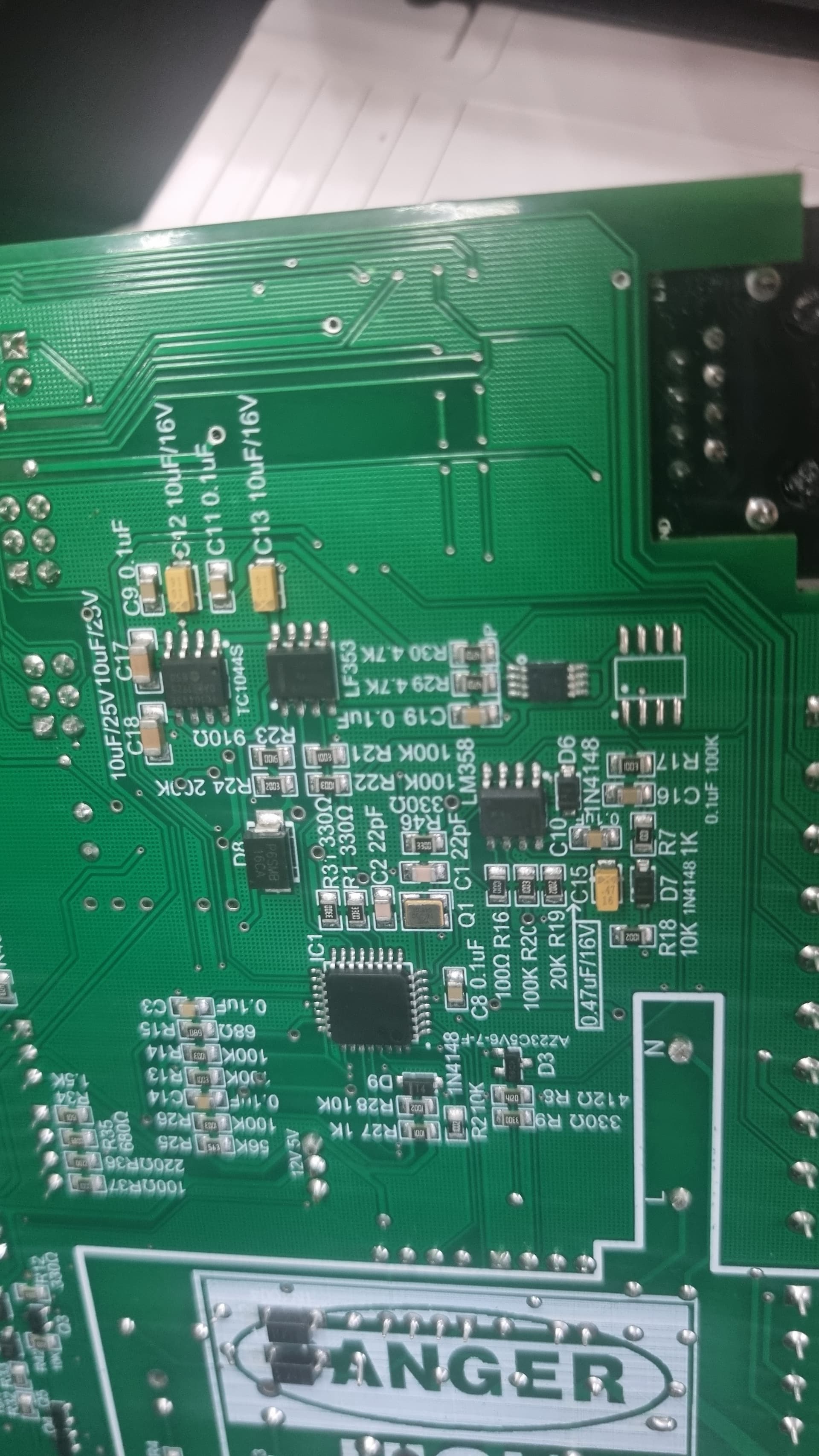

yes, i could save the Dump of the ESP32 (WT3-ETH01), where the website is stored.
I have one box with open evse 8.2.2 and want to transmit it to other boxes.
Now im trying to read and save the data from the LGT8F328P chip.
But seems to be tricky, there is now correct connection on the SWC and SWD Pins.
Yau can Flash “adafruit huzzah32.bin” but then you dont have RJ45 available.
The rest is working fine.
You can go back to Kinetos Dump with this Website:
Or with 8$ Programmer from Amazon.
If you need, i can send you the Kinetos Dump.
greez

Hi Shockwave,
I would appreciate the dump as well. Do you perhaps have a link or a brief description of exactly how the pins need to be connected for flashing?
I have a USB ESP8266 programmer here.
Any help would be appreciated.
