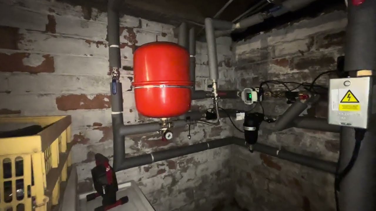

My installer was around to commission last week and I got them to move the meter onto a clearer run of pipe away from the magnetic filter and bypass valve.
Doing this introduced lots of air into the system that I have been bleeding out and the heating was on yesterday allowing air to get into radiators where I blead it off.

Having AAVs (automatic air vents) installed at the highest points of your system is a big help to get rid of air, but you’ll probably still need to manually bleed rads for a few weeks to get all of it out. Could you post some photos of your system showing the location of the meter and the AAVS?

Mark from JMR Heating came on 20th Sept and fitted 2 additional AAVs on the flow and return pipes.

I’ve made a video of me pointing at things as I couldn’t really work out a way to show it all with photos (sorry for my boring voice and the mess of wires I haven’ sorted out yet).

Thanks for the video, that explains things nicely. The AAV should be at the highest part of the system, since they’re in the cellar they won’t be doing much for central heating since all the air will rise up into your rads which you can bleed off. However, the AAV on the flow is the most important one for DHW. The location of it looks fine, can you check that it’s open? The little knob on top should be loose.
It’s not ideal that the heat meter is fitted between two out of plane bends:
i.e location G
Yes both AAVs are open. I have heard air coming out of one when I was trying to get air out of the system after the last work was done to it.
Not really sure where else I can put the meter. I thought it was ok after the double bend in two planes if it had a straight of 280mm or more. I think it does but haven’t measured exactly.
Maybe I could try getting it moved to one of the straighter bits of pipe between the ASHP and pipework in the video.
Maybe as @marko suggests I could try it on the flow instead, maybe on the bit between the AAV and 3 port valve.
Mmm tricky, I think a better location would be on the vertical return pipe. But there’s a good chance your issue is trapped air. Can you hear any air in the system during a DHW cycle? Air in the system will make the pump sound noisier. Is there any scope for putting an AAV at the height points above the cellar?
