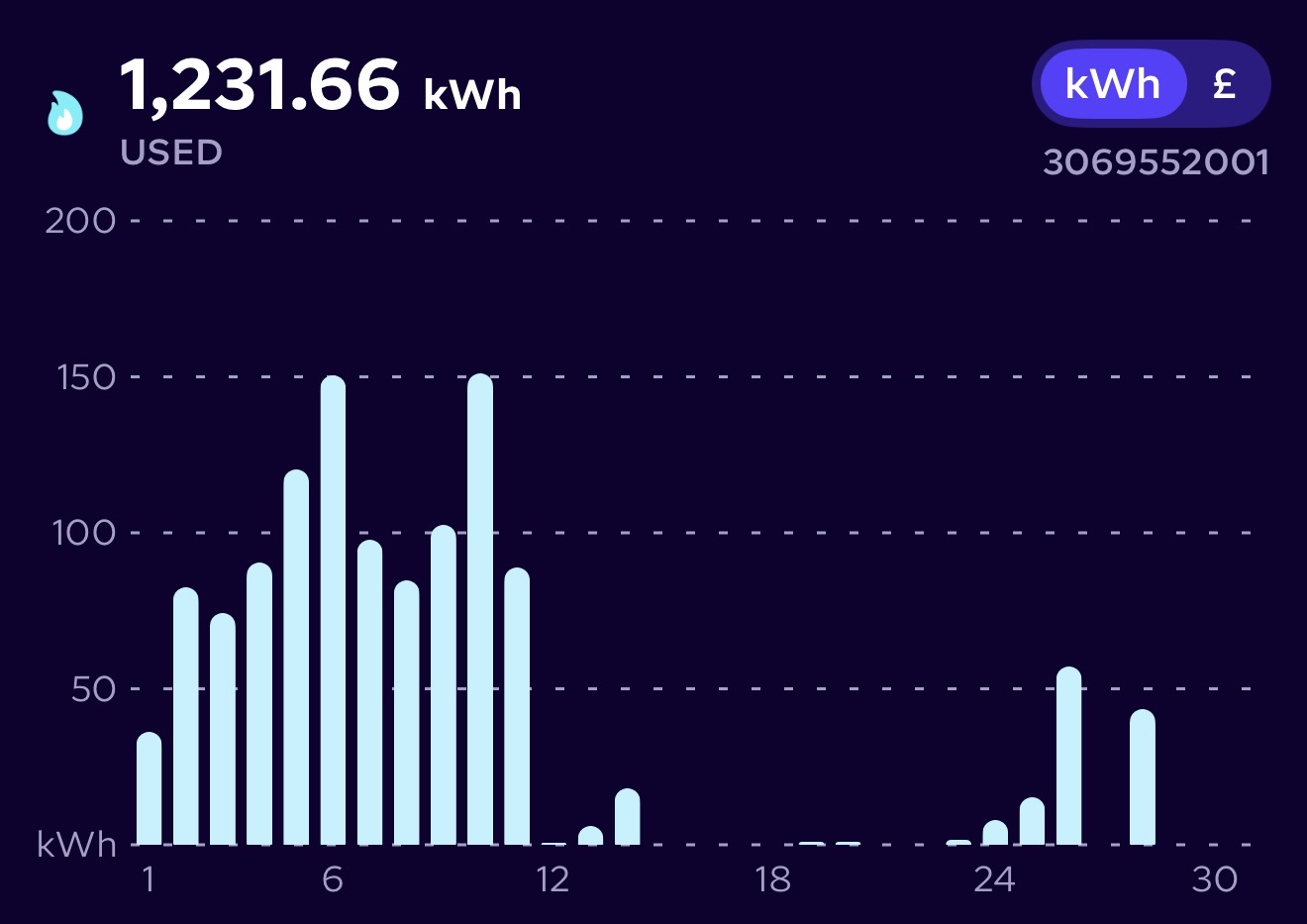

Looking at my gas usage data, you can see the pattern - most gas consumption happens between 5pm and 11pm on cold days. Early January when we hit -6.5°C saw the heaviest gas usage. By mid-January as temps improved, gas usage dropped significantly - the last week had 4 days with virtually zero gas.

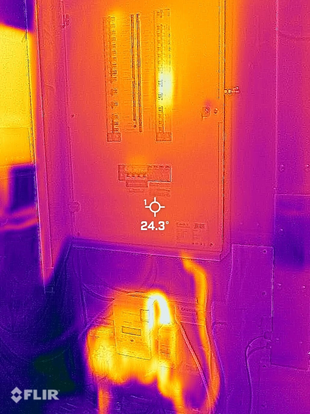

I have three inverters, so yes, 3.6kW*3 = 10.8kW
Heat pump peaks at 4kW + any house loads.
Under the 23kW limit, you can pull; you may be able to pull a little more, too. I think if we got an electric car, we are defo going to need to upgrade to three-phase.

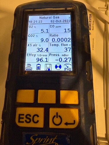

The gas boiler can operate effectively at the same flow temperatures as a heat pump. I am not even sure I could achieve a 70 °C flow with this much radiator heat sink. My controller sets the flow temp to the same for the heat pump and the gas boiler; you can’t tell the difference in the house when the gas is on.
I operated the boiler this way before installing a heat pump.

Any day you can see the line is a day the gas was used
If you say 1200kwh of gas. Which let’s say 96% efficiency 1152 of heat. Cop of 3.6 (which would prob be worse as I only use gas at the worse possible outdoor temps)
320 kWh of electricity at 37.09 £120
but I think the cop would more likely be down in the 2.9 range
400 kWh £150
