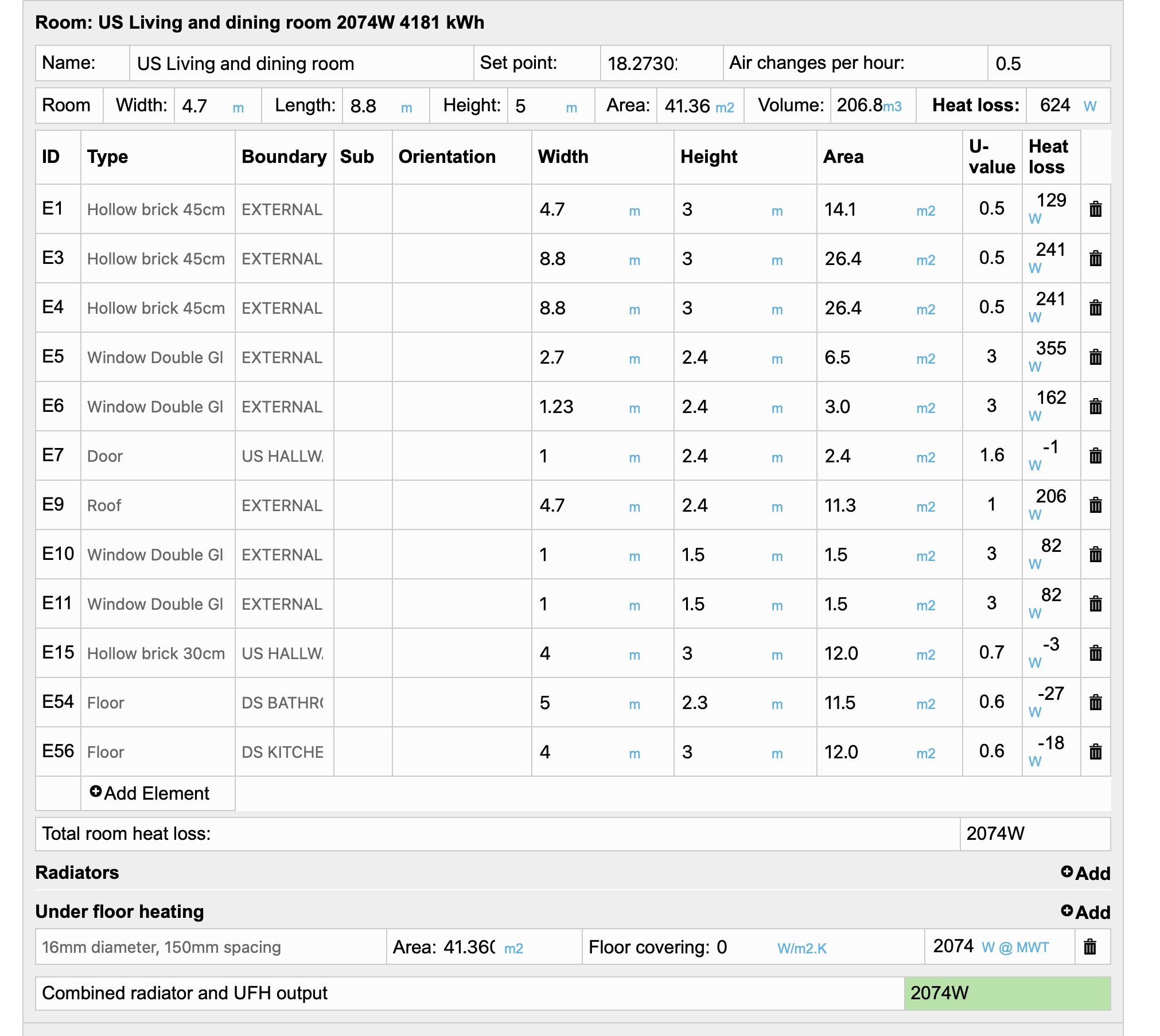

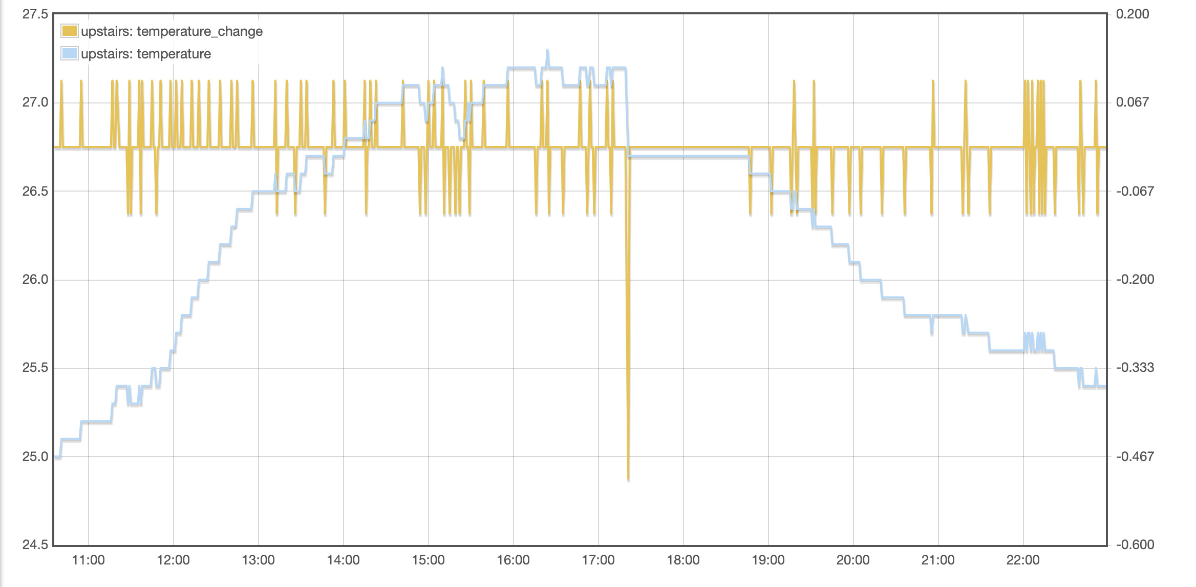

Is there a way to calculate and graph "energy gain" in a room if the heatloss and temperature change is known
Hi there,
I’ve done several heat loss calculations with heatloss.js for my house and I now have a temperature feed of the room in EmonCMS as well as a “change in temperature”:
Is there a simple way to use the heatloss calculations to calculate the nett gain/loss per hour from this data? I’m hoping to calculate this and then once the heatpump is running (in heating or cooling mode), see that it becomes nearly zero, instead of the constant daily gain.
